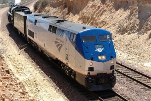

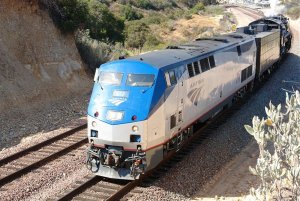

GE AMD103 Genesis (P32/P40/P42) 70', half the distance between an SD40-2 & a Dash 9, height 14' 8"... Now compare to ATSF #3751, she's 94' 10.5" long, and 16' tall! That does NOT include the tender.
