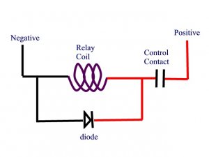

I didn't see any diodes on your list. ANYTIME you are using relay coils you should have a snubber diode on the coil. Opening the connection to a coil can cause some very high voltages as the current wants to continue to flow at the same rate. An open circuit and 1.5 amps = a very very very high voltage. It will increase until it arcs somewhere. Probably the switch in your case but high voltage arcs are something we want to avoid anywhere near expensive DCC controllers.

since the controls are all contacts with this, do I really need the kickback diodes? I know they need to be used where solid-state devices are controlling the coils. But generally, I don't see them used with mechanical-relay logic.

Brain fart 2: Both the relays and the track coils should have snubber diodes.
Yes I would always use diodes. For the cost of 20 diodes (less than a buck) you will stop any arcing, switches will last longer, relay contacts will last longer and you won't induce radio frequency harmonics into surrounding wires that DCC might not like. Cost is less then 0.25% of project cost. I think this is called a no-brainer.

About the diodes, I guess it would be cheap insurance to parallel them with the e-magnet coils and the relay coils. What particular diode do you recommend?
It would be hard to find one that wouldn't work fine. The 1N4001>4007 series (50v>1000v) seem like a good low cost choice. On futurlec.com the 50v and 400v are both 10 for $0.20. Others a $0.05 each. You would need other stuff (Like 100 LEDs for $5.00 or their project boards, etc) to make the shipping worth it but @ $4 for up to $30.00, no mimimum and no credit card fee it is not to bad.

You don't want to parallel the diode. The voltage wants to increase when you open the switch. If you are using common ground the diode wants to be placed so that it conducts when the switched line of the coil is above the supply voltage.

Isn't this how the diode should be connected?
