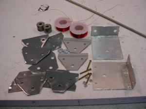

For those who had asked about a tutorial for these uncouplers, here are a few things:
1. Probably the easiest thing to do is to buy the O scale uncoupler which is around #11-$12. These come with 2 coils and double sideplates, and should work just fine with HO scale, built as the directions show. You can wire the coils in series and operate at 24 volts, or put them in parallel and you can operate them at 12 volts up to 16 volts. With the 24 volt series arrangement, the current will be between 1.25 to 1.5 amps. With the parallel arrangement and the lower voltage, the current will be doubled.

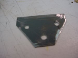

2. You can add some extra home-made metal sideplates to help focus the magnetic field even more. I made mine out of some thin sheetmetal. I cut the shapes with tin snips and then drilled holes in the appropriate spots. I'll post some pics.

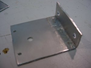

3. My layout is 2.5 inches thick... .25" of cork roadbed, 2" of foam, and another .25" plywood on the bottom. I devised some simple mounting brackets to mount the magnet to the layout. I used thin aluminum plates and bent a 90 degree angle for a mounting foot. Drilled holes for attaching to the magnet bolt and for screws to attach to the layout. Will post some pics.
4. On my particulat uncouplers, I mixed the O scale uncouplers with some HO scale couplers I already had. I'll also post pics of what I did with that.
Here are the parts I used, with some close-ups of the home-made sideplates and the aluminum mounting brackets. I used aluminum for the mounting brackets because it is non-magnetic. I was afraid that using a steel bracket would spread the flux lines out instead of having them concentrated through the sideplates to the area at the track.

Again, I will mention it is probably best to just use the O scale uncouplers as they are. You can discard some of the plastic mounting pieces that come with it though. The O scale coupler is strong enough to just be mounted under the ties. If you can devise a mounting system, you don't have to put all the plastic mounting pieces above the track that is shown in the instructions.

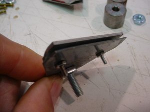

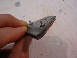

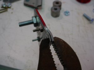

With my magnets, I first shaped the home-made steel plates to match the factory sideplates. Once they were cut out and drilled, I bolted them to the factory sideplate and then squeezed them with pliers to match the contour. Do this for each home-made sideplate.
The reason for the extra sideplates is to give more metal to focus the flux lines up to the track where you need them.

This particular magnet, I have added 3 extra plates to each side. Here is what one side looks like.
