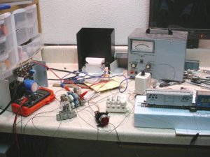

I am still experimenting to figure out what is the best system for the magnets, plus my "one-shot" timing circuit for the pushbutton worked flawlessly. My workbench is out of control though!

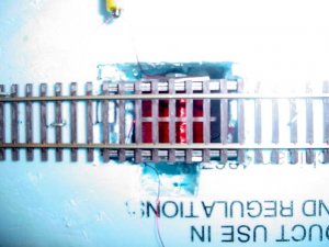

Coming along nicely. I've spent the last week gathering supplies and putting components together. I've got some lighted pushbuttons and installed LEDs in them, built my relay modules and time delay circuit, got my power supply into a cabinet, and have 5 of the dual coil electromagnets put together. I don't have the camera this weekend, but will get some photos next week.
On the electromagnets, I am using a 24V DC supply. The two coils are connected in series so each is getting 12 volts with a current draw of 1.5 amps or so. I also added extra metal sideplates which help "focus" the magnetic field to where it is needed. A 12 volt supply could also be used by connecting the 2 coils in parallel, but be aware that the 12 volt supply would have to be capable of putting out 3 amps.
The O scale Kadee electromagnets come with two coils and four sideplates for around $11. This seems to be the most economical way to get the coils. I combined the parts out of these with the HO scale electromagnets I already had, and I used some sheet metal to make the extra sideplates. I also made some mounting brackets out of aluminum sheet so that I can easily mount the magnets... my layout base is 1/4" birch plywood with 2" of blue foam on top.

The trick with any electromagnet is to focus as much of the flux where you want it. Flux = AMP turns > smaller wire = more turns & less amps > bigger wire = less turns and more amps.
Since the coil size determines the AMP turns per volt the other variable is volts. The plates are used to direct the flow of the flux. For maximum flux density you want the easiest path everywhere but the "gap", the narrowest possible gap and the gap as close as possible to the required action.
Since your two coils spread the plates and widen the gap you are losing a little density.
Looking at the pics I would try the following:
1 Coil at higher voltage. With your time delay (EXCELLENT IDEA!!!) and very low duty cycle you shouldn't have a problem with heat. Just remember the wattage (and flux) goes up with the square of the voltage. 12 volts = 18 watts. 18 volts = 40.5 watts. 24 volts = 72 watts. So one coil at 18 volts has more flux (and a smaller gap) than two coils at 24 volts. If Kadee uses the coil a 18 volts with a "manual thumb" delay for duty cycle then I would think the much lower duty cycle your time delay offers should allow the use of 24 volts with four times the density. Just don't hit it to often during testing.
Larger diameter bolt. Since you don't have a picture of the coils without the plates I can't see the inside diameter. Use a larger diameter (and shortest) bolt if it will fit through the coil. Drill the plates as required. DON'T USE A STAINLESS BOLT. Multiple or thicker plates also help.
From the picture the plates seem to span about 8 ties. Nice for having a longer uncoupling zone - bad for flux density. Unless you need a long area try cutting the plates to about 4 or 5 ties wide to focus the flux.
Notch the top of the plates so the come up even with the top of the ties. You could still cover these with ballast.
If I were you I might try getting some flat steel strap, about 1 > 1.5 inches wide and up to 1/4 thick, a drill a hole for a large bolt and round the bottom to match the coil. Notch the top to match the ties. Use one coil with voltage as high as heat will allow.

I just got through putting 24 volts on a single coil. I put 4 seconds of power on the coil, about 5 times in one minute. No harm done, but the windings were obviously hot, almost to the point of being hot enough to burn my fingers.
Next, I did a strength test, comparing one coil at 24 volts versus 2 coils in series at 24 volts. I did the test by seeing which coil set-up could lift a piece of steel from the greatest height. The 2 coil magnet could lift the steel from about a 20% greater height.
Some of my thoughts (which could be wrong): The strength of an electromagnetic is directly proportional to the Amp-turns, not necessarily the wattage. I say this because a certain percentage of the wattage applied to the coil is being used up as heat. The single coil and the double coil have the same Amp-turns--> the single coil has half the turns of the double coil but double the amps. The double coil has twice the turns of the single coil but half the amps. So the amp-turns are equal. I can't explain the 20% difference in strength, the double coil being stronger than the single coil. Some kind of magnetic saturation, or, with the single coil, much of the wattage is being used as heat?
With the single coil, we get 24 volts x 3 amps = 72 watts
With the double coil, we get 24 volts x 1.5 amps = 36 watts.
The double coil at only 36 watts is stronger than the single coil at 72 watts.
