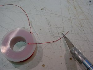

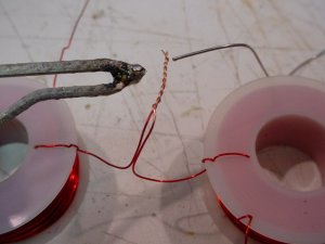

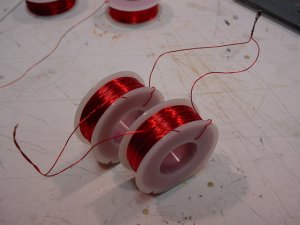

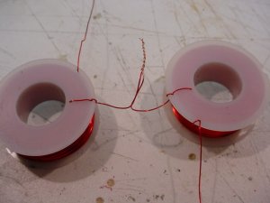

Next we need to solder the coils together, in series... for a 24 volt source. If you are using 12 to 16 volts, the coils need to be soldered together in parallel.
Scrape the red insulation off using a hobby knife, be careful with the sharp blade and the hot soldering iron.
It is important to orient the wires as shown in the photo if you are putting them in series. If you get it backwards, the magnetic fields will cancel out instead of add together. Same thing holds true for a parallel connection. You need to make sure the current is flowing in the same direction in each coil.

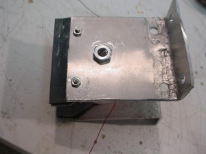

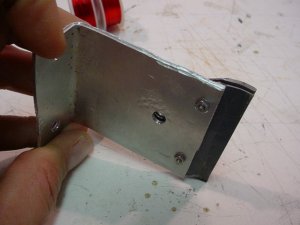

Time to put the whole thing together now.
Connect the aluminum mounting brackets to the sideplates, using some 2-56 screws and nuts. A note on the aluminum brackets: I made them so they were a little bit longer than the actual thickness of my layout. This will allow me to make fine adjustements on the height of the magnet sticking through the layout into the roadbed. The very top of the sideplates should be even with the top of the roadbed, well, actually just a touch lower so a piece of plastic can be glued to them so the track can be ballasted. More on that later.

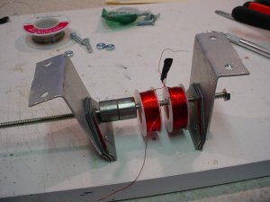

Slide all the pieces onto a piece of 10-24 all thread rod as shown. Tighten it up, making sure to keep the sideplates straight with each other. Also, make sure the coils are oriented properly so the magnetic fields add together instead of cancel out.

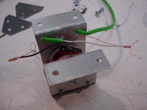

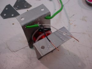

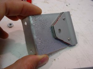

Drill a couple of holes in the aluminum bracket, then thread your feed wire through them, strip them out, and solder them as shown in the photos. Insulate the connections with some electrical tape, and you are done with the uncoupler magnet.

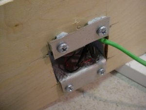

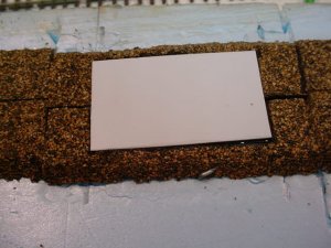

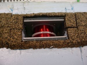

And here is the magnet installed in my test track. You have to cut out a hole so that the magnet fits up through the layout.
Use the wood screws in the bottom to adjust the height of the magnet. I stuck some blue foam pieces between the plywood and the aluminum bracket to act as a spring to hold the magnet firmly in place.
Hope this is of use to someone. Of course, the dimensions of the aluminum bracket would need to be adjusted for the thickness of your layout.

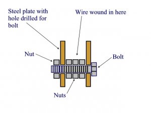

Loren, I thought some more, and if I was going to build my own magnets, I would do something like this. For the bolt, I would use a 3/8" bolt of the desired length. It needs to be threaded for the entire length, or you could use all-thread rod.
I would use some 1/4" thick metal or 3/16" thick for the sideplates, they would need to be drilled for the bolt/rod to go through.
Here is a cross-section of my thoughts. Maybe only 2 nuts in the middle would work, perhaps 3. You could wrap the nuts with some electrical tape if you wanted.
The number of turns of wire would just have to experimented with. An amp meter would be helpful so you would know what is going on.

Sounds like a good idea.
Some thoughts & changes:
Use a 1/2" bolt and a piece of 1/2" copper pipe for a spacer.
Make sure you use magnet wire. The insulation on plastic covered wire is to thick to allow the number of turns you need.
To space the plates 1/2" apart and have about 1" of windings you have 1/2 sq inch of cross section for wire. Assuming about 50% of the space for air and insulation this gives 1/4 sq inch of wire.
This would give about 1,000 turns of #26 wire. About 420 feet. About 17 ohms. about 3/4 AMP (12v). #24 wire would increase the amp turns by about 50% but would triple the current. SO... I would start with #26 wire. A Drill press with a slow speed to turn it while winding would also be useful.
On ebay 1,500 feet of 26 gauge wire is about $20 + $10 shipping. I am sure you could do a little better but if not that means about $10/coil. Doesn't look like enough savings to make it worth while.
If you want to try your own start with 26 gauge. Don't make the center larger with nuts. That only increases the length of the first turns, increases the resistance, reduces the current & amp turns. Since I doubt a 1/2" bolt would be saturated they won't help increase the flux. Try and get at least 1000 turns. Be willing to do a lot of work to save a couple of dollars - but - to be able to say "I made these"
