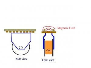

The uncoupler magnets work by attracting the coupler pin on the Kadee couplers to each side of the track. Check out the diagram below. When a car goes over the magnet, the trip pins of each car are pulled to opposite sides of the track. Once the cars are uncoupled, you can back up to the uncoupled car and push it to were you want to set it at a spur. When you pull away from the car, it won't be coupled up, it will stay where it you left it. This is the so-called "delayed action" of the Kadee uncoupling system.

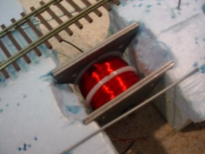

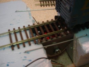

Okay, in my experiments, I came up with this. I took TWO electromagnet uncouplers and put BOTH of them together with a longer bolt. I used all of the steel side plates = 2 on each side. I wired the coils in parallel. Now we're talking! This thing is strong enough to seperate the couplers without even having to cut into the ties for the steel plates to stick through. It can be mounted completely under the ties like the #308 undertrack magnet.
Now, the doubled up coils are drawing 2.5 amps at 12 volts. I have a 24 volt DC, 5 amp supply that I may try out, but I will wire the coils in series instead of parallel.
Yeah, this will double the cost... each electromagnet is about 7 bucks, so $14 for the doubled unit. I have 4 places where I am thinking of using them, so the cost isn't that extravagent. I could get some electromagnet wire and build some stuff myself, but it will be simpler to just buy the Kadees and double up.
Anybody see any problems or catastrophes brewing here?

I've been playing with it for 20 minutes here on the bench, and so far it is working great.
