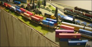

I made several of these from Norbtach's pages about a year ago. It is nice because they already have a weathered look to them. I will probably have to redo them soon as they are getting pretty beat up. I also learned how to make my own so I made domestic sized containers. Unfortunately, our tunnel module was made by a Canadian, so domestic containers do not fit through it. :-D International ones fit just fine. I took the graphics and combined them into one to make the double stacks.
Containers

Jesso, are those all paper containers? They look great man, i should have printed more. Too bad not many choices in N scale.
Sorry for double post, i cant seem to edit my previous post. Just found out that if you reduce the HO scale PDF files to 54%, you can get close to N scale.
All of my containers are cardstock paper and they all came from the first link. The graphics have to be worked more on Norbtach's than on the other one, but that was actually better for me the way I did them. Norbtach has a much bigger selection of containers, and I wanted to have as many colors as I could on my trains.
If they are the HO pdf ones, make sure that when you print that the computer doesn't adjust the size of the pdf for the print margins. If you are doing the graphics ones, you will have to make the calculations and resize accordingly. Admittedly, I have only printed out N scale ones so I don't know if the HO ones are incorrectly sized.
They are incorrect as far as comparing them to the plastic containers you buy at the LHS. :)
I use them, just not next to each other and the human eye cant tell. :)
I'm not sweating it! :)
thnx for the help. I took off the margins, but didn't work. I can just put the behind in the back area i guess. I found out, because I don't have cardstock at the moment, if you print on regular paper, put together, and glue(white glue) strips of paper on the inside, the glue hardens as well as the paper/container. I am trying something new where I print the containers on paper, then glue a sheet of paper over the design, cut out, and make containers. I will get back on when I find out the results.
I printed some of the containers on regular printer paper, folded them up and slid them over a box built out of .020 styrene. It worked great. Not nessesarily something that will pass up close inspection but with the three foot rule they are ok.
