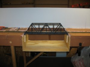

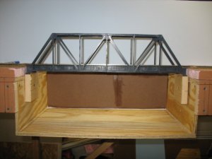

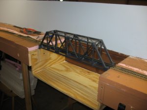

Hello everyone, i finally got a start on adding a bridge scene to my layout. I have it boxed in and everything supported once again. I decided on makeing the depth 6" from the bottom of the bridge, what do you all think, is it too deep? Also, i added a couple of pieces of 1" x 4" scraps to support the bridge temporarly until my Chooch bridge abutments arrive hopefully in a couple of days. Can someone recomend some ways of makeing this box look like a river bank? I have never done a bridge before, so all the help is really appreciated. Thanks!
steve:thumb:

Well, start with some foam or what ever your comfortable using for mountains and instead of building up, build down. Is the river bed going to be dry or wet? Think of the shape you want to see. " V " Shaped, " U " shaped? Its up to you and what you'd like to see. I mean, you have to look at it. LOL :)
Like this....
W F FW
A O O A
L A A L
L M water M L
Build down was a figure of speach, sorry to confuse you. :)
Does that make sense?
It appears the forums messed up my diagram......
Try this....
I don't think depth is so much of a problem as it accentuates the reason for the bridge in the first place. What you need to do now is plan out how you will meld the bridge, bridge supports and scenery to make this area look prototypical i.e. slopping river bank, dry stream, wet stream, slow moving river, rapids, dry gorge, etc.
You could have the bridge supports made from concrete, wood or stone resting on a bedrock formation. Using foam slope the river (or whatever) banks from the bedrock/bridge supports to the bottom of the 6" structure depth and add scenery as appropriate. The possibilities are endless. Let your imagination run wild.

As for filling it in, just angle the sides, lol!
Alternatives
trainsteve2435 said:
Can someone recomend some ways of making this box look like a river bank? I have never done a bridge before, so all the help is really appreciated.
:cry:It doesn't look like you have much depth to work with, which would minimize your choices as to what you can do to make the river seem to "disappear" in the distance. If you had more depth, you could have curved the riverbank to either side so that the scenery hides where it's going.
:thumb: Since this doesn't seem possible in the space available, if you feel comfortable trying some background painting, you could paint this type of effect on the back wall. (Before you start, either remove the masonite in the back or hide it with some drywall mud and paint it your background color).
Hey Frank, thanks for the ideas. Yes, i wish i had more depth to hide the river, but i have hidden stageing behind where you see the bridge. Im gonna try my habd at painting an illusion of a dissappearing river somehow, any ideas? Thanks!:wave:

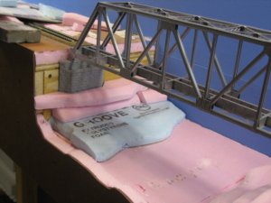

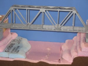

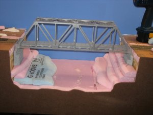

OK, heres what i have gotten done so far. Im not sure how to desguise the tops of the supports, so please give me your suggestions. Also, all comments are welcome as im new to this type of details, so please feel free to comment. Thanks!
steve:thumb:
HI: I believe your bridge is sitting on the wrong part of the abutments. I checked the photo on a box that my Walthers bridge came in and it shows the bridge on the lower, ledge of the abutment with the portion that you have your bridge sitting on between the roadbed and the bridge. You might check some prototype photo's.
