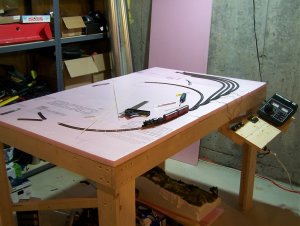

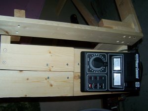

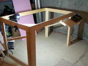

Well I finished up my table and added my new controller. here are some pictures.
Next I will adding the pink foam to the top and planing the placement of the layout.

Hey McB....You might want to put another set of cross-braces on those legs (so they make an "X"), and add a couple of 1x4 stringers across the top to lay the foam on. You don't want the top sagging under your weight as you work on the railroad....

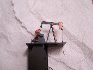

Well I started to Assemble my PumpJack.
Made a few mistakes but I'm ok with it, I used the gel style glue instead of the liquid and this made a mess of the fine details.
I also didn't mix my paint well and will need to sand it down and try again.

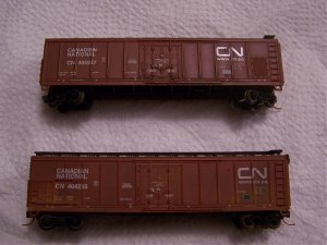

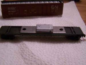

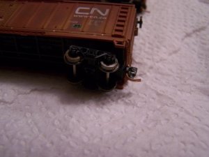

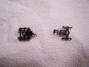

I did some Upgrading of my Rail box cars tonight.
I added Micro Train's roller Bearing Trucks with couplers.
Switched out the plastic wheels for Atlas metal ones.
Added some Weight.
And tryed some Weathering.

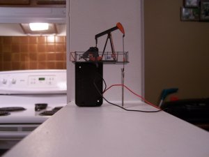

Well I got the PumpJack finished tonight.
I tryed using 12v but the jack ran to fast to be realistic, I found that 3v was about right.
I would place video up but the wire is a little bent and cause's it to run a bit rough. It is getting better over time, so hopefully soon I can add the video.
Let me know what you guys think.announce1
