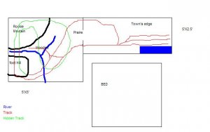

Well when I was little, trains were for going really fast and runing into lego men on the track:rolleyes:. Now I have lots of free time and growing tired of model cars. So i have decided to get back into trains and try this modeling idea ( my little self would kick my Butt for not running into things:D). so first off like every one else ( except someone that makes a layout from calgery to golden with 700 scale miles of track:thumb:) i have no space for a layout, and little money. i'm going to place it againts the wall and my bed. I drove through Jasper national park and was like I'm modeling this, so here we go, my layout is a 5X5 and 5X2.5 together.
i want moutains then forest, then praire, then a towns edge with some staging, i'm placing it on the water front so it looks like i have a port. i want to have some track under the table so when the train leaves into the mountain cave it's a little while before it comes back. I will be running 70's-present CN Rail and Via rail so i will need to be able to run passenger cars, i have a couple of problems.
#1 If i'm runing a 10-15 car frieght train with one engine, and and 6-8 car Passenger and steam loco, can i use the 4% incline in the hidden area?
B Sence i have limited space will my train have a problem with a 12' radius turn in the 2.5' area of my layout (this would be close to town limits so the train most slow anyway :D)
III What distance should i use from the centers of double track, and for staging, I know sence nothing turns in staging it can be closer, but i have no idea how close.
any ideas would be nice. oh ya i'm going to post everything so stop by for some laughssign1

Question # Four i'm plaining on using moderen Via rail cars, but a Steam train (not weathering it to give the rebuilt look for added seat value:thumb:) So my question is if i have a 12" radius curve how big a steam train can i use, i'm guessing no 4-8-4:cry:
What i'm thinking is a 4-8-4, 2-8-2, or if need be a 4-6-2
Hi mcbane.
Track spacing for N should be around 1" to 1 1/8". If you are going to pick up cars in the yard, you might want to measure a car plus a finger and space them that way.
I'm not sure about 4% grades, but N used to take some pretty steep hills.
You may have to check reviews of your desired locos in the magazines to see what a minimum radius is. I managed to get my N gauge around less than 12: radius, but that was 25 years ago, and things were different then.

everyone that i know that put in 4% wished they did not (including me) in any scale, engines just cant pull up 4% as good. on my new layout i got 2% for curves max! i have one spot of streght 4% thats only 24" long and with 12 cars it go at a slow creap up it,

Okay, now some comments from someone on the other side of the fence....
#1. If you check out the link in my signature of my home layout, you will see that I have a 9'x7' L shape and all but one of my grades are 4%. I have found that the less rolling resistance you have on each piece of stock, the more you can pull. If it gets to where my locomotive is having a tough time up the grades, I simply do what they do in the real world - I double 'em up. The reason I used 4% is because I was trying to get as much height difference as possible in as small a space as I could. It worked. You will have to run shorter trains with 4% grades. For me it was either 2% or 4% as I was using 1" foam. 3% made my runs too long and came out 1/2" off in between layers of foam anyways.
#2. A good way to find out if the 12" radius is going to work for you or not is to lay down a 12" circle of track and test out your loco on it. The minimum standard radius in N scale is 9-3/4". I've done several coffee table layouts with one having a minimum radius of 6.5" so go figure.
#3. The Kato track spacing guide recommends ideal track centerline spacing to be 1-5/16"s apart. That may vary by manufacturer however. As cidchase told me in another thread, "1-1/16" gives a prototypical 14' spacing." As far as staging centerline spacing - that should depend on which manufacturer and size of switches you will be using. You will see what I am talking about when you start laying out your switches.
I had a thread that contained a lot of this information you are curious about. If you like, check it out here...
http://www.the-gauge.com/showthread.php?t=22973
1" track centers represent 13' in reality, which was the old standard for straight track. Nowadays, real track centers are usually 16' or so. Also, on a model and especially in the smaller scales, track centers often have to be larger than scale for access reasons and due to tighter curves than the real thing.
Passenger cars may run on 12' -it's like 22" in HO - but in a very cumbersome fashion. Unfortunately, it doesn't seem that you have room for much more, but every half-inch helps. Model curvature requirements aren't affected much by speed, unlike the real thing.

For the plan you have drawn I would not build it against a wall. That 5 foot reach will be impossible to fix problems let alone build scenery without crawling onto your layout.
Fot the size of the space you plan on using, you should be able to layout a trackplan that has smaller than 4% grades.
Craig
thanks for your input my room is 11.5 wide and I am placing the layout on wheels so i can bring it out from the wall if I have to and the place's in my layout hard to get to will be the large mountain.
Do you feel that i can run the track under the table using the 2% incline? and i have been toying with the idea that one track lead into the mountain will already be two inch's higher.

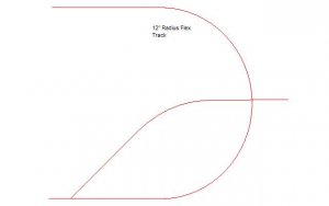

thanks for the info
ok does anyone have some ideas i could consider? it's 2.5' wide and i need to turn the train around with a staging area behind it, long moderen cars and a steam loco must b able to make the turn.
