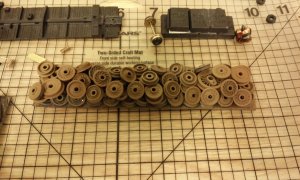

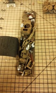

Happy New Year to everyone! It's been about two months since I've last posted on here, so time to catch up a little. Before I came home before Christmas not much was accomplished, with minor work being done on the Bachmann Trackster van that Bob from the Clarksville MRC gave to me. The front wheels were out of round due to crappy manufacturing, so I swapped axles and added metal wheels all around. At some future time I'll add pickups to the front wheels so all four wheels conduct electricity.
While at home I visited my old model rr club back home while in Wisconsin during their open house. At first I did some switching in our paper mill area and then took a break since a lot of guys were running their stuff on the main. I was bs-ing with one of the guys in our maintenance office and while I was out playing.... or should I say operating... someone donated three boxes of train stuff. Needless to say about half of the stuff was your typical Tyco and Model Power junk from the mid to late 70's while the other half was decent Train Miniatures, Athearn and MDC stuff. The club was in the process of thinning out their inventory as it was so they let me have first dibs. I managed to save about a dozen boxcars, about a half dozen reefers, a tank car, a flat car (this sucker looks ancient, maybe a Red Ball or earlier as it has cast metal dummy couplers and the trucks are three piece screw together brass beasts with a full cast metal frame and real wooden deck), a 2-4-0 Bowker, a AHM tiny diesel and a Mantua 0-6-0 Big Six switcher. The club, looking to thin their collection, also donated a Bachmann 0-6-0 and a boxcar that was missing a door (which I think I have a spare). With all that being said, I think I had a pretty great Christmas!
I already have a few plans for the stuff I've acquired. The club's old 0-6-0 is currently in the UP's grey stripe scheme and will be repainted for my daughter's train that I've been slowly working on for the last two years. There was also a Hershey's Tyco reefer that I grabbed for her. The Mantua Big Six will go on to the Whiskey River Railway roster as that's a locomotive I've been watching for on eBay for a while but couldn't find one under $40. It does need a connecting rod bushing to be fully operational. Many of the cars will also go on the WRRy roster while some will stay in their original paint and be used while others will hang out for future employment.
I've started disassembly on the Mantua Big Six and the AHM switcher. The drivers on the Big Six need to be quartered and with my NWSL quarterer at home as well as the bushing issue I'm setting it off to the side for now. The AHM switcher surprised the crap out of me when I popped it's shell off, the thing already had a can motor and was insulated on both sides of the frame.
It also has four wheel drive and four wheel pickup which I think I might convert this to DCC. All that I needed to do to get this thing to run fairly well was to clean the commutator and the track it was on and it ran back and forth at different speeds pretty well. However I'm not sure if I want to keep it painted in it's current paint job or not, the Soo Line number it wears (714) is actually supposed to be a GP30. We will see though.

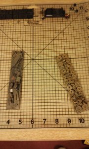

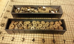

I have been keeping busy over here doing odd jobs and making random things. One of those random things is a pair of gondola loads for the WRRy gons that I purchased before coming to Korea. One of the goals on the WRRy is to make every visible load removable. Using what I had available, which was 1/8" aluminum sheet, I cut it to the size of the inside of my MDC 40' gondola. I decided to make two different loads, one being scrap metals and one being old railroad wheels. I Gorilla Glued everything in place and then hit it with both a coat of rusty dirty brown and a coat of the Japenese equivalent of Dullcote. And here's how they came out.
Reactions: zathros
Looking good, little stuff like that will come in handy; when you are working on a layout, or on a fleet of cars later, it is hard to find time for loads. Even I did not have enough log loads for my old operations, much less my new ones. red auto body primer, and flat black sprayed close to simultaniously will mix on the work surface, and make a good aproximation of rust. thake care!

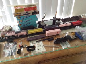

Bill, as your requested...
That's the whole project I've been working on for the last almost three years. Most of the cars had paint, it was just a matter of finding time to apply the dry transfers/decals (most are dry transfers from my mom's artsy collection from when she was in college), adding weight to cars, adding Kadee's, and doing detail touches. My daughter's train has the reporting marks MTX, Madalyn's Train (privately owned). The hopper, tank car and caboose still need to have Kadee's added, and the tender needs some major paint cleanup as my masking tape started coming off while I was painting (leftover Korean brand masking tape... not 3M quality at all).

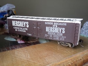

Also I have a Hershey's reefer that I'll let her borrow since I kinda like it but I'll see how she likes this first. It's just a Tyco car that I've fitted with Kadee's, added weight to NMRA standards and weathered the trucks. It's simple and I like it. I'm not sure if there's a prototype for this car, but would be neat if there was. Once the construction of the WRRy starts to take place it will make the occaisonal guest appearance on the ice track or the team track in town.

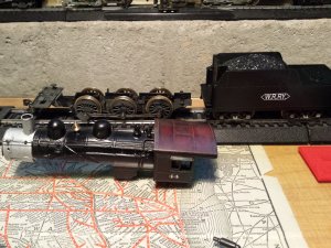

Just because I play with 1:1 scale now doesn't mean that I've stopped playing with 1:87 scale. I've worked on a few more of my W.R.Ry. cars and locomotives since I've last been on here. Most of my updates have been posted to the W.R.Ry.'s Facebook page https://www.facebook.com/Whiskey-River-Railway-183968593063/. I'm not 100% sure but I think you'd need to sign up to see everything. Anyways ex-Caseyville & Scouttown #4 got its repaint into W.R.Ry. colors finally with a Mantua tender swap.

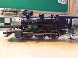

I've drilled the tender frame for sound and I'm toying with the idea of switching the cylinders to slide valve. As of now it seems like a straight-forward project but we'll see how much adjustment I have to do to the valve gear. I also need to fit a headlight to the top of the smokebox per W.R.Ry. protocol. However since I'm using a Precision Scale headlight that's completely empty I need to know how to either fill the headlight with clear epoxy or which MV Lens kit will work. I think it's the 3293 headlight I have. Any suggestions?

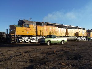

Here's a little teaser for now as my computer is no longer able to access WiFi and has the majority of my pics from along the line, this is my daily driven 1973 Dodge D100 Adventurer with the 360 engine, three on the tree, A/C, power steering and AM radio.
And whatever that big school bus looking thing is in the background. ;)
Hi Tyler. I do LIKE that schoolbus!! Your pick me up truck is pretty cool too.
What kind of Dismal is that? How many horses? Inquiring minds want to know.
