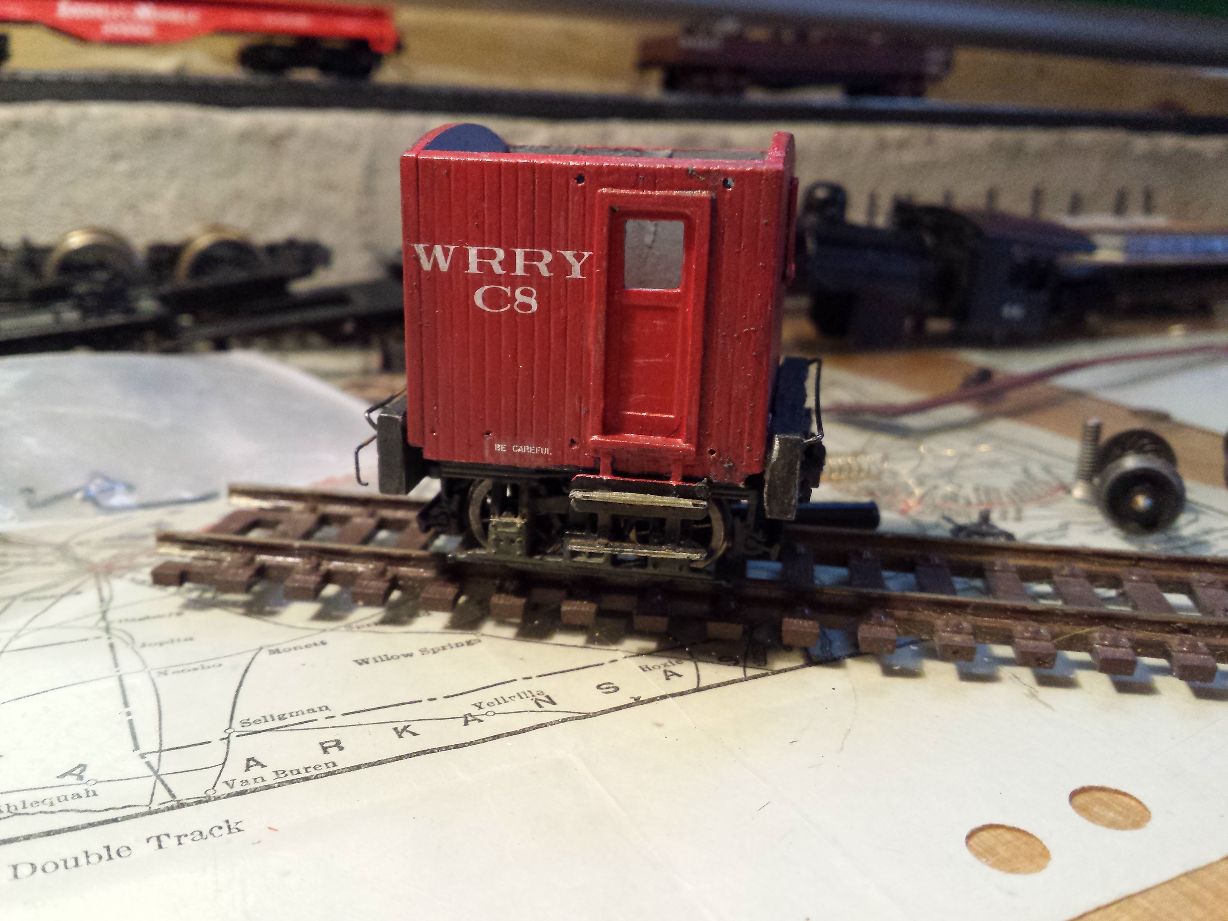

Since I had the iron hot I soldered up my connector that I bought and received last night. Looks like I need to sharpen up my small soldering skills a bit, but all connections are separate with no solder bridges. I'm excited to get this installed into #44's tender as its been forever since I've last installed a sound decoder, let alone a steamer. Eventually the wires will be painted to camouflage them.
