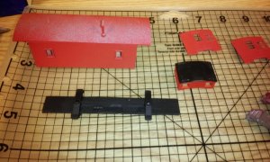

While I haven't been making any progress designing Camp Pierre or any other module for potential use while I've been here, I did get a little handy working on caboose C1 and inspecting the Bachmann van that Bob gave to me. I took down dimensions of the original motor to see if I can find a potential replacement and that's about it. I know it was a tight squeeze to let Thomas have DCC, but this one might be tighter as I think even a Z scale decoder may be too big. More to follow on that later.
Caboose C1, however, has had slightly more progress done to her than just measurements. A few days ago, I painted her underframe and internal weights black and today I cut down the toolbox that will be mounted on the underside of the car. The original toolbox was from one of my Athearn caboose kitbashes that are now C5 and C6 and the cast metal detail was left over from a old work car that was crushed on it's way from Korea last time I was here. Weather permitting (since it's monsoon season here, lots of rain and humidity) it should be painted sometime this week. I haven't had a chance to hit up a hobby store, so right now I'm working with flat black spray paint and Gorilla glue.

Glad you are getting some model time.
Glad to see you are getting some down time and a chance at some relaxing model making.

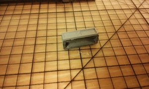

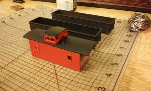

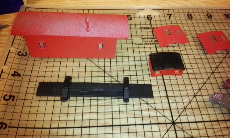

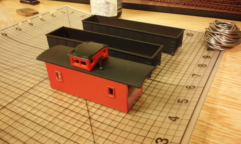

WRRy caboose C1 got a little more work done to her yesterday. I painted her roof and the toolbox black. I do have a issue I haven't had before, when I peeled back the masking tape some of the paint on the window castings came off with the tape. What I'm probably going to do is pop out the castings, strip the paint off and try again. Hopefully I can find the right paint on the internet, as I used the Floquil Caboose Red aerosol paint and hopefully they'll ship it to me over here without an issue. Finding it over here would be almost impossible as Koreans don't seem to believe in model railroading. I haven't found any luck at finding another model railroad hobby shop, and the only one I knew of is in Seoul. They mostly carried N scale stuff, and what little HO scale stuff they did have was all RTR stuff. Especially with Floquil going out of business soon I'm sure I don't have a easy task ahead of me.

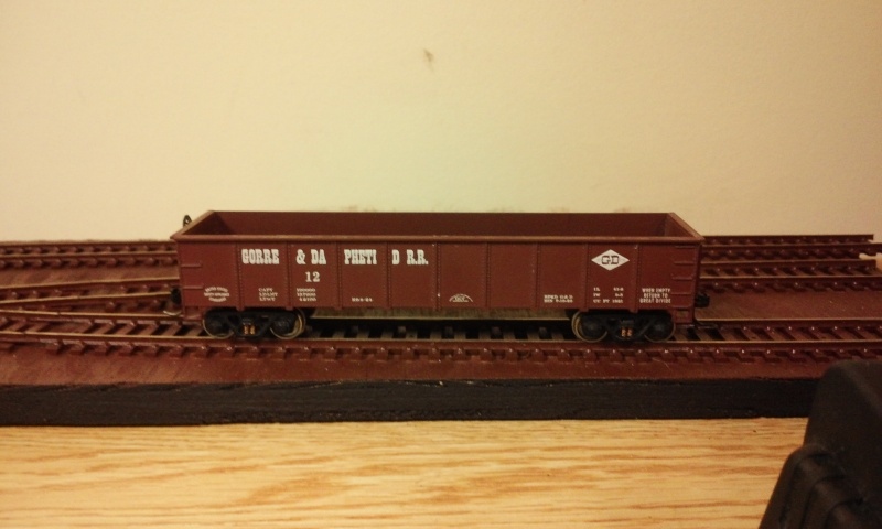

About two or three weeks ago on eBay I bought a set of five old Roundhouse gondolas from River City Railroad. I don't know where they get the undecorated MDC cars from, especially in any quantity, and sell them for $17 for the set plus s&h. But hey, it's great for me! The WRRy now has enough gons for a while, as I have two painted and on my roster, and will have three or four more. I'll keep some undecorated in case I change my mind or find some other decals to decorate it for another railroad.

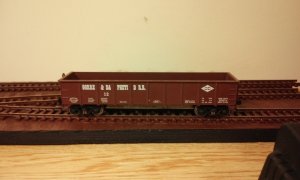

Speaking of gondolas, I found the gem in the last picture on eBay also for the steal of $8. Any of the Gorre and Daphetid cars that MDC made in the 80's usually command a pretty high premium these days, most cars go for $20 or more with the passenger cars going for even more. This car came with a pretty nice pair of fully sprung trucks with metal wheelsets and Kadee #5's already installed. The only issue I have is with the trucks, they're too modern to be rolling on the WRRy, but for now they'll work. All in all I found another great deal.

Good workmanship on the caboose. I like the little layout you got going there too Tyler. Is that part of the plan you sent a while back??
The gondolas will make a great addition to your fleet. I donated a 1980's era G&D MDC Box Car to the club that I used to use as a track cleaning car. Maybe I should pirate it away and sell it on Evil Bay??? Nawh too much work and the holes drilled in the bottom for the slider and the heavy weathering job would probably keep folks from bidding.

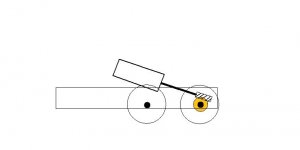

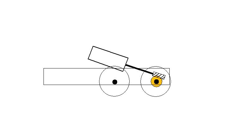

Looking at the destruction manual for the AHM Americans, instead of doing a tender drive could you just swap the geared driver to the back and mount the motor in the boiler?
With the bigger Casey Jones boiler on top of the frame there should be enough room to stuff it in there. Granted I don't have the lokie in front of me to try it, but in my mind everything works as planned. :p
There is more room under the boiler, however the worm is mouted very low, just at or slightly above the top of the frame. Using Bachman 4-4-0 tender trucks ( I bought a pair), I can lower the tender enough to get a straight shot into the mechanism.
Tender drives are widely reviled , but many of the issues were a result of old motors, and simple electrical systems. the oldmotors that would kick in hard at a high speed, would cause the tenders to rock. a tender rocking the wronr way on a traditionally wired locomotive cuts off it's electrical supply. When gravity brings the tender back down the process is repeated, causing jerky erratic throttle response. Once you put electrical pick ups on the insulated side of the locomotive, and replace the 1960's style motor with something with a lower starting voltage, the traditional complaints about tender drives no longer aply.

Bill, the pic below is how I was thinking of having the plan laid out. I can't remember if I gave you a small enough motor to jam in there or not, but by having the motor in the locomotive this way it does three things:
1. Keeps the loco aesthetically pleasing to the eye by not having a mystery shaft run from the tender to the loco.
2. Adds weight over the drivers improving tractive effort (not like I expect this to be a powerhouse anyways, in the WRRy world it's a 1870's locomotive reboilered sometime between 1905-1915)
3. Eliminates any possibility of having any tender rock.

No contest on the mystery shaft, as an aesthetic issue, it con not be argued with.
The weight is not a valad arguement, any space not used by the motor could be filled with lead, or Tungsten welding rods that are going to weigh way more than a motor,
with a good drawbar, motor and mechanism tender rock is not much of an issue, that is something we saw with motors and designs with thier birth in the 60's..
a motor to fit in as drawm would indeed need to be tiny, as part of it would have to fit inside the farame. I have motors that small, but they are gear reduction motors, and are way to slow for a 4-4-0.

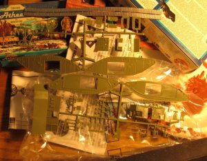

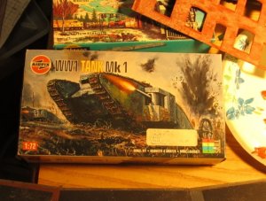

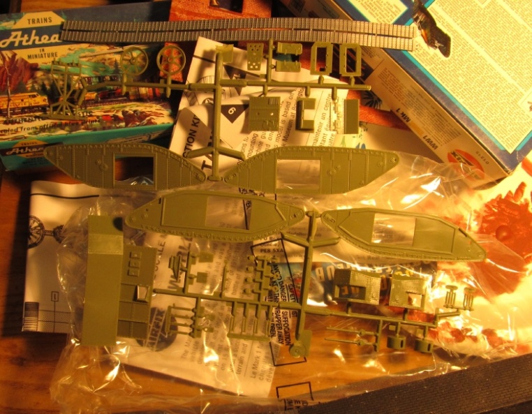

Tyler, thought you'd like this. not sure what I'm going to do with it. option 1: flatcar load. Option 2, park it near a VFW post. Option 3, convert it to a log skidder. I know they made log skidders out of Sherman tank hulls after WWII; although the Shermans probably had a much more reliable drive train.

Out of all the options, I'd have to go with a display piece outside of a VFW. From my quick research the VFW was started in the early 1900's to support soldiers returning from the Spanish-American war and the Philippine Insurrection so it'd be in place during a WW2 setting, such as the Whiskey River Railway is. However, being that I have nothing permanent yet, I think that a VFW post on the club layout would be a neat touch. It would also be a neat little way to show the club's appreciation for the vets that do walk in too, as well as Bob, Jesse, Eric and myself... and anyone else I've forgotten.
Just a thought, and thanks for thinking of me.
