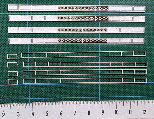

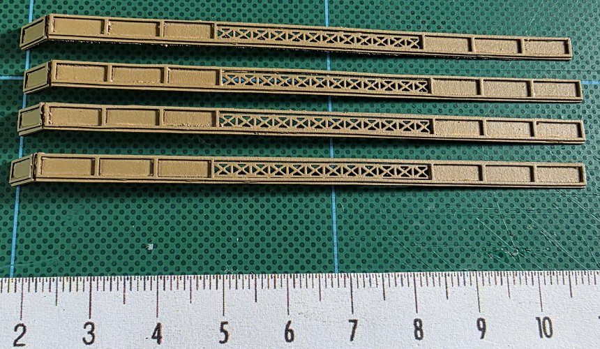

Now, one last thing, the railing that runs around the platform. Here you'll see another self-harm exercise with microscopical lasercut pieces...
The difficult thing was not the cutting part... it was handling the pieces without destroying them... but the effort was worth it!
and after the paint job the result was really good!

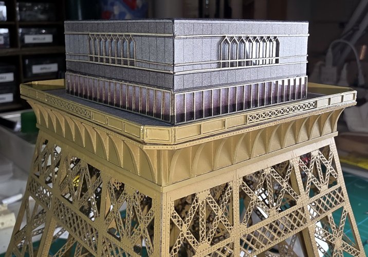

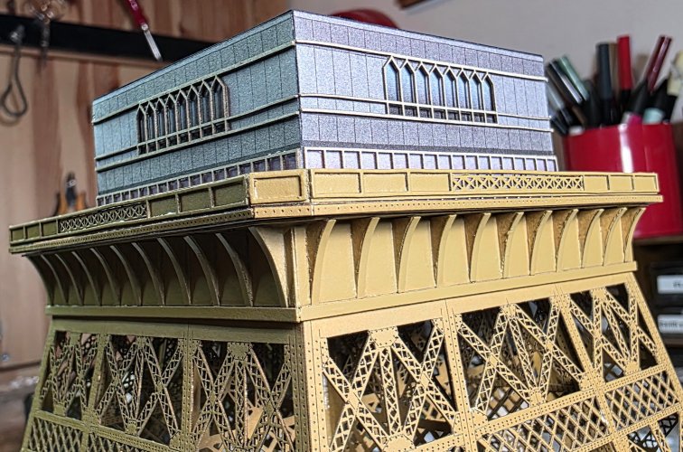

Here I am with a little update: the second platform.
This time the work to detail the sides was significantly easier, the shapes are simpler and not decorated.
obviously, remembering what happened with the first platform, I covered ALL the surfaces with smooth cardboard.
Once painted the piece is looking very good

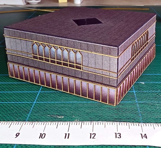

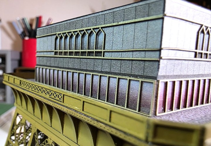

Now let's turn to the second floor building... This time I wanted to hurt myself realizing all the windows frames (that are about 0,5 mm wide)...
The glass was simulated with a piece of plastic pasted with a generous amount of PVA glue that, once dried, become completely transparent.
Then I applied the upper row frames after having opened the windows in the cardboard.
...and placed other transparent plastic pieces from inside
and, eventually, I placed the lower row window frames over the plastic previously glued.
