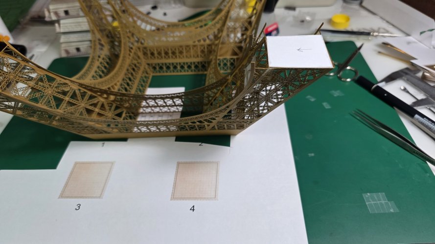

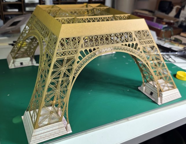

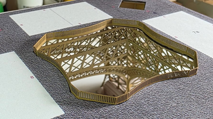

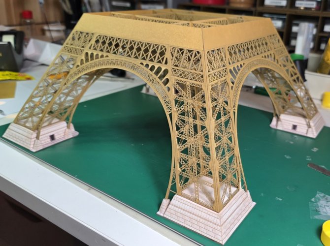

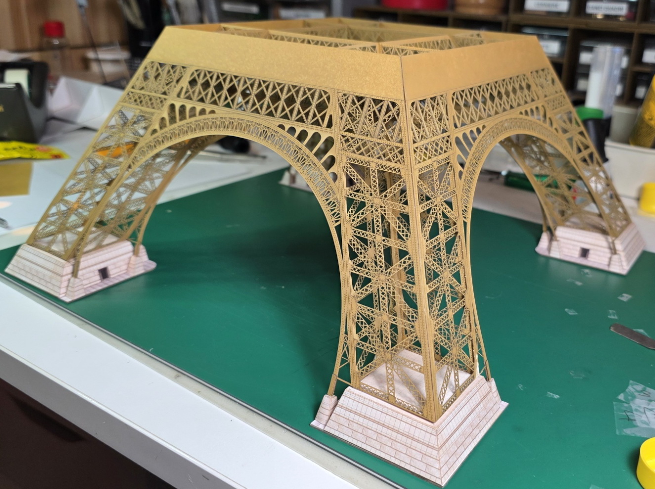

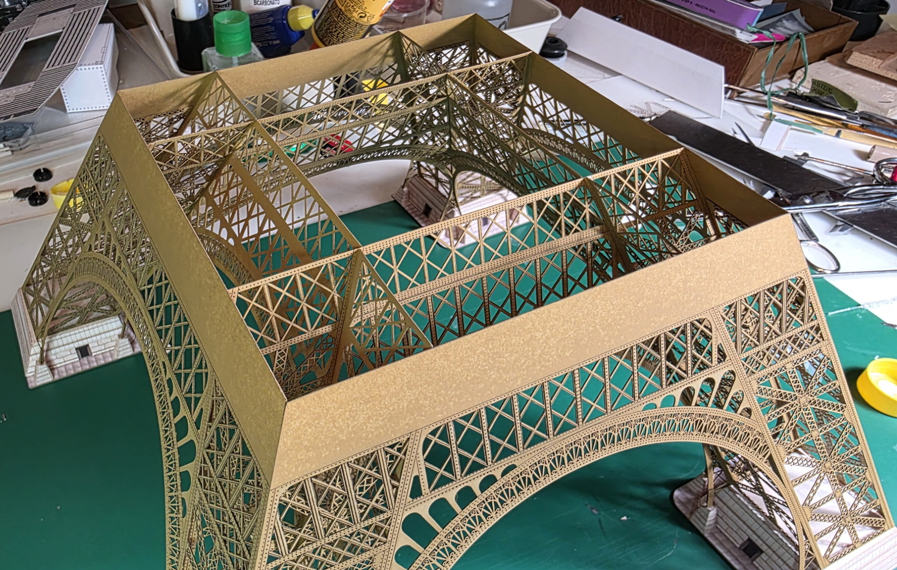

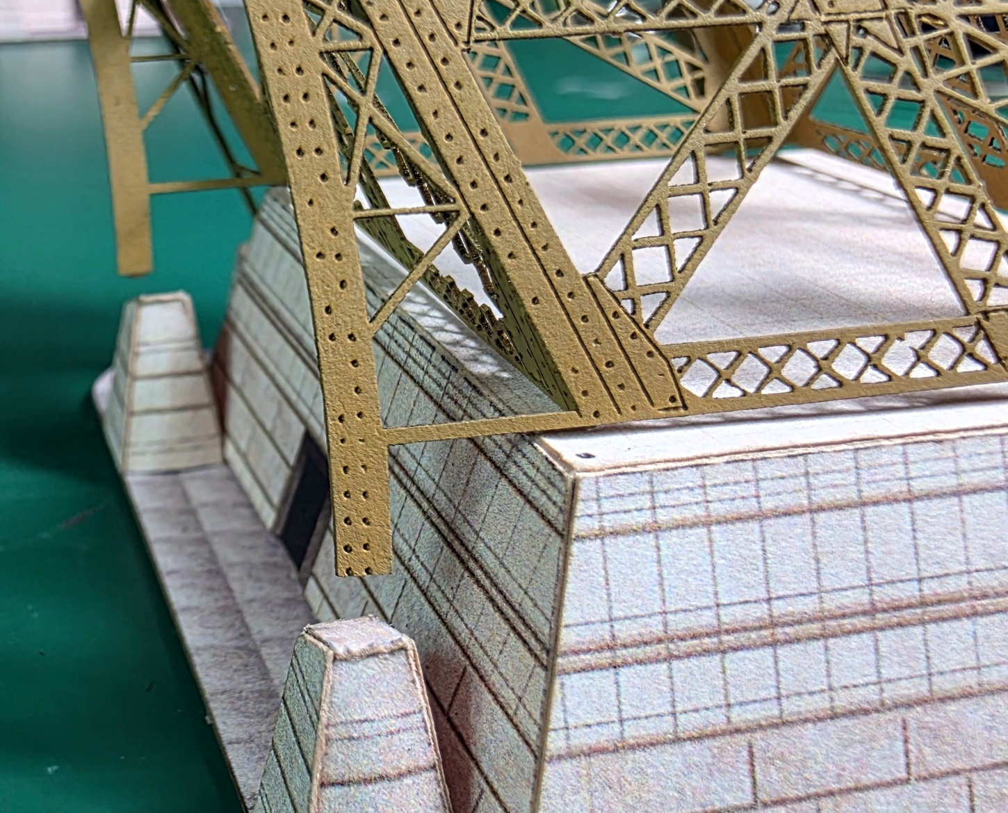

The main base structure is now almost complete. I should give her shoes now lo let her stand up on her legs.

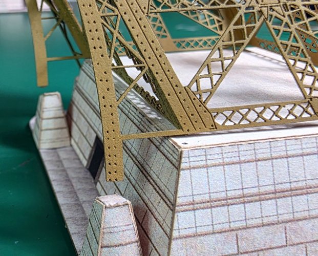

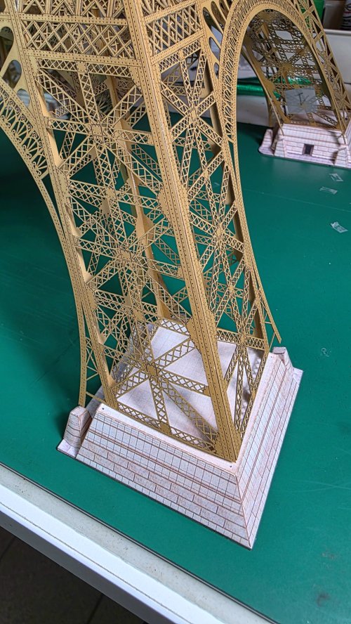

But there are two problems:

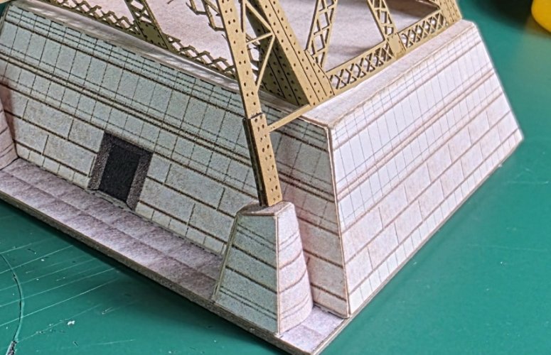

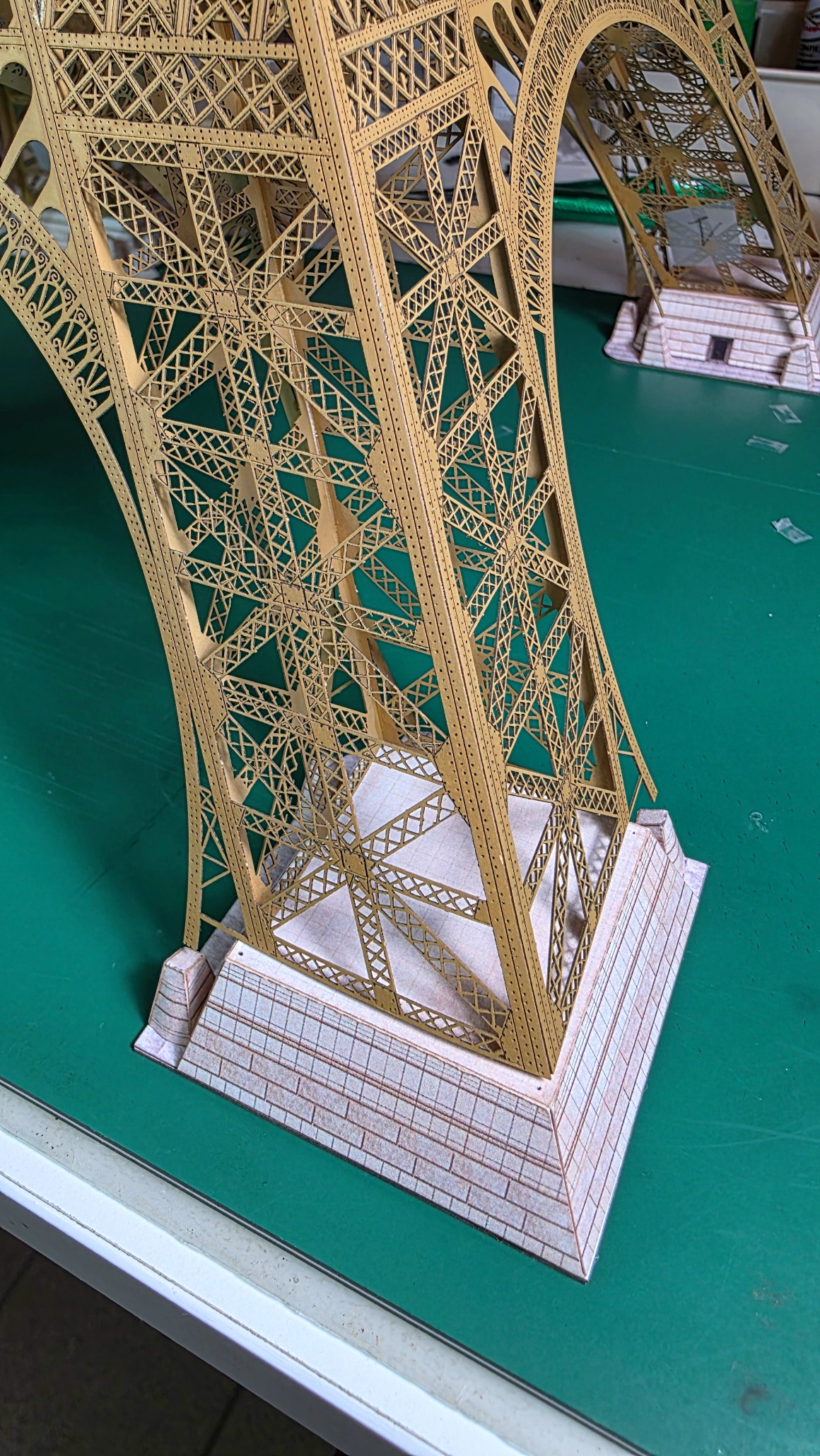

1) the contact points between the base and the "leg" are too little and discontinuous
2) the curve beam doesn't reach the base block where it is supposed to be joined

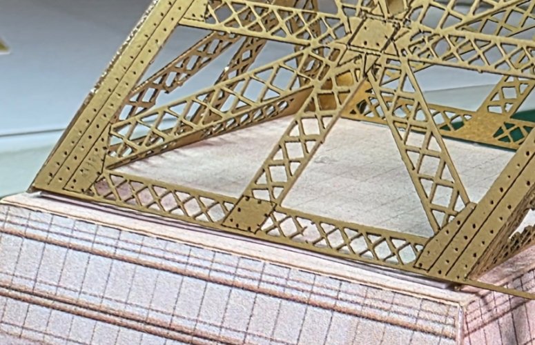

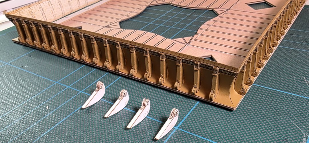

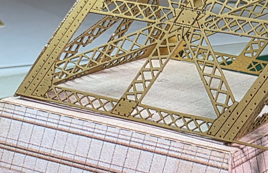

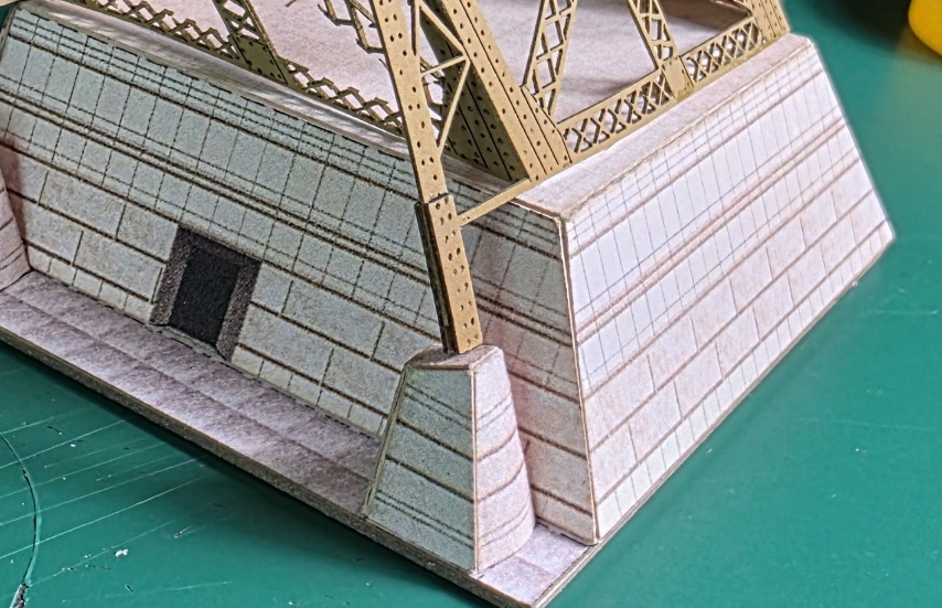

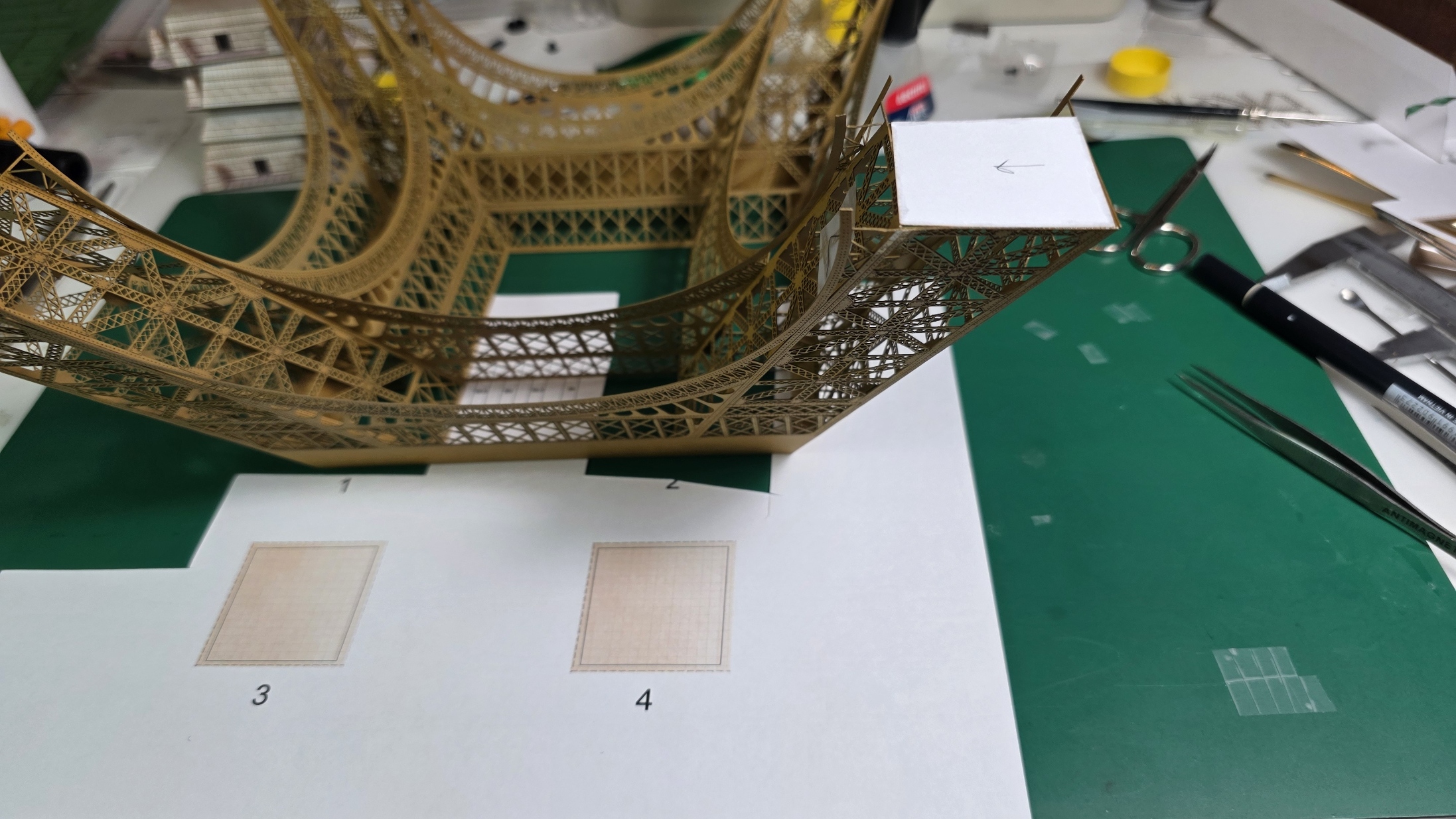

To front the first problem I realized four squares with the same texture of the base and the exact dimension of the aperture inside the "leg". Those can be joined with the structure much easily putting the glue along the edges and creating a solid base.
Once glued to the base the new added pieces are barely visible.
For the second issue I was forced to create little sections of beam to prolonge the short ones. This is a detail not very realistic but I wasn't able to think anything better

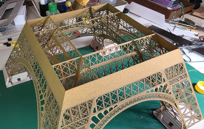

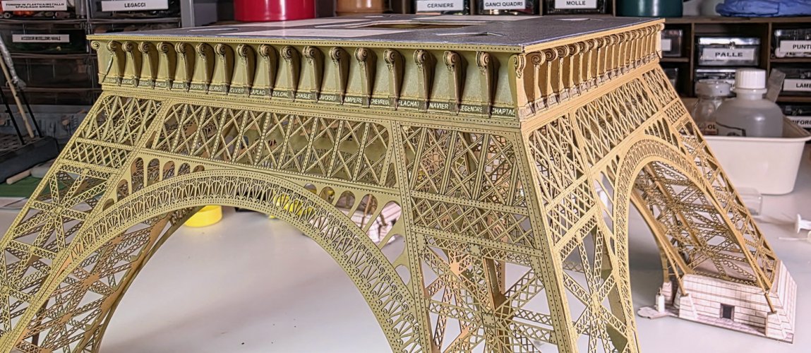

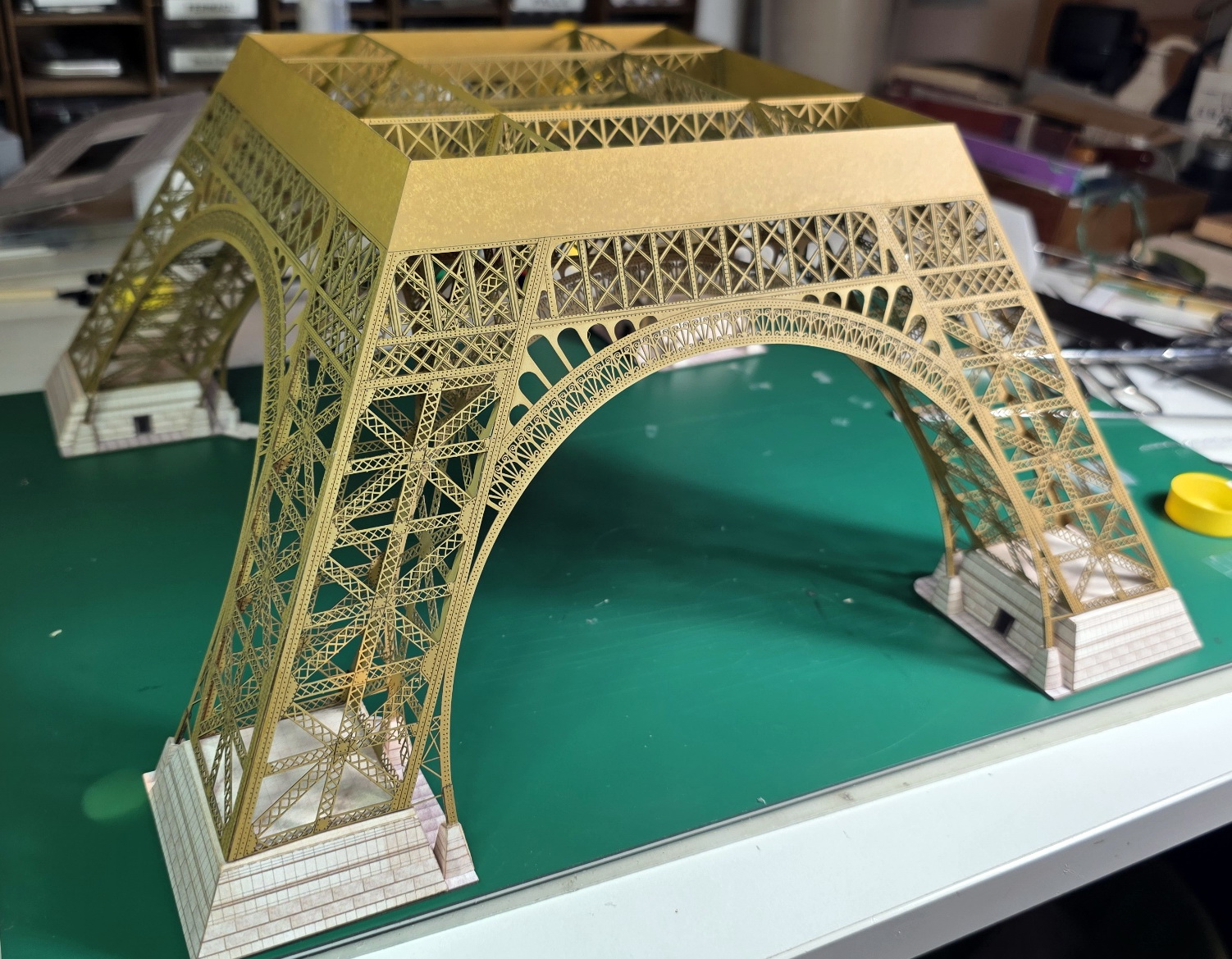

And so this is the point I reached so far. I'm satisfied with the result: I was afraid the thing to be too fragile, the pieces are so delicate... but once joined in this complex structure they form a very light and strong base, just like the real counterpart I think.

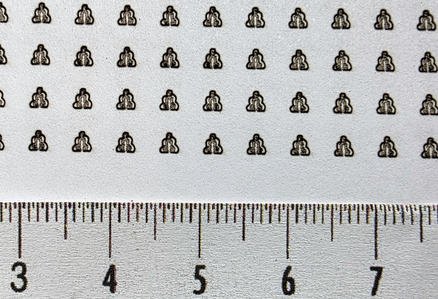

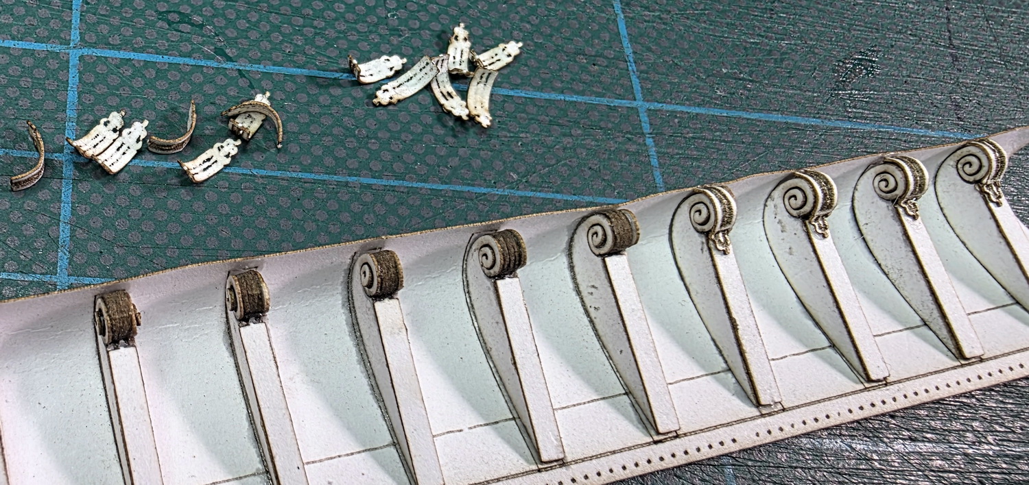

WOWWWWWWWW!!!!!!... and, just to add troubles to my work, I thought it would be nice to add the decorative leaves...
The laser did the hard work but also I had my part: to manipulate and paste those little things was not an easy task with my big fingers...
I thought to be at a good point and ready to do a test paint...

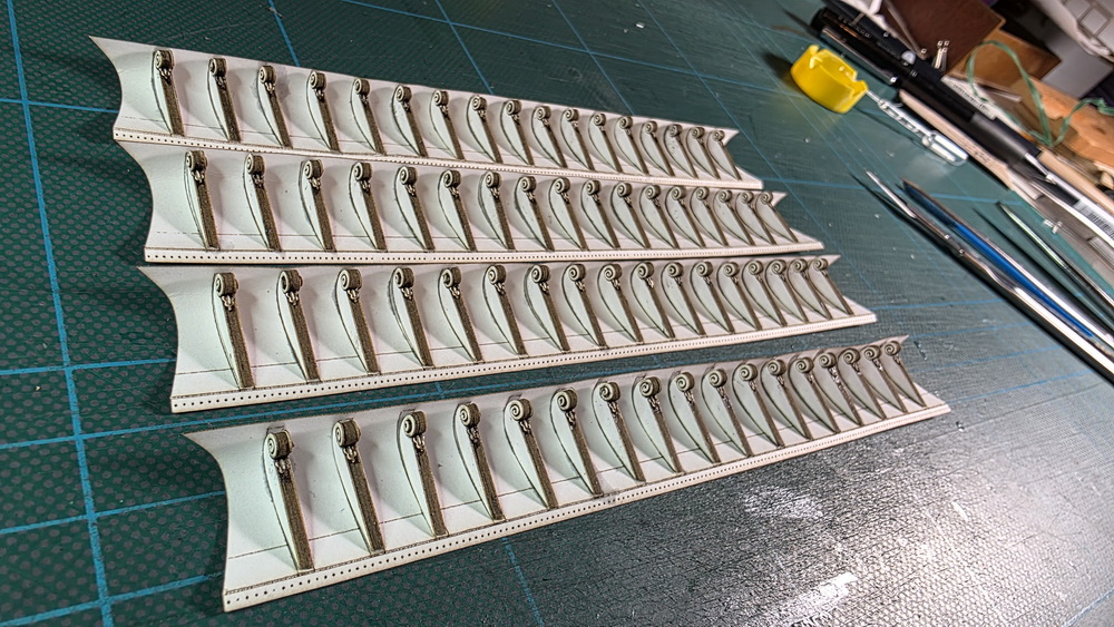

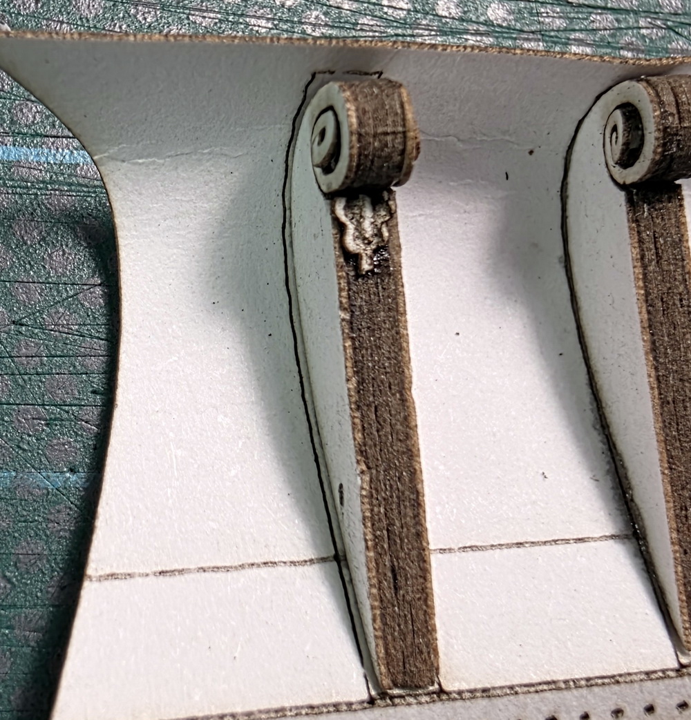

But the worst of the issues is just around the corner... the paint was absorbed by the cut surface, the cardboard has a porous structure in the cut side and the result was horrible... I had to figure out how to fix this...

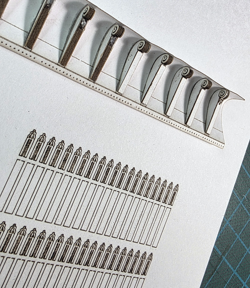

The only solution was to realize a new front side for the supports, taking the opportunity to adding further details to the front of the "curls"
This way all the surfaces will take the paint in a regular way

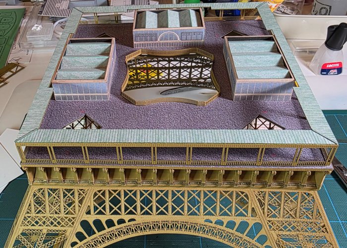

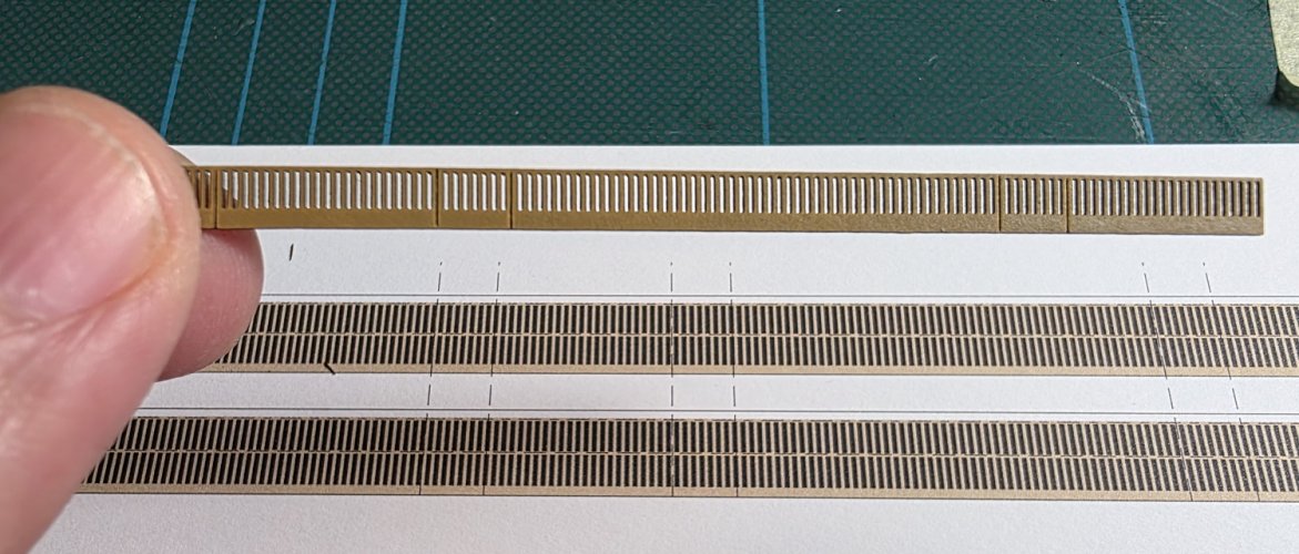

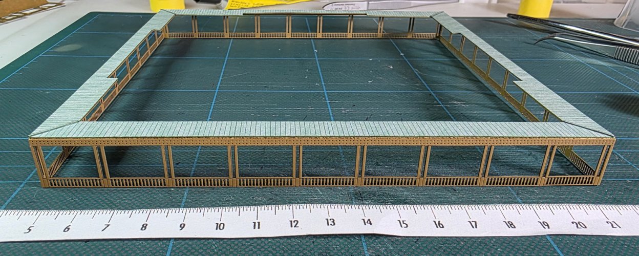

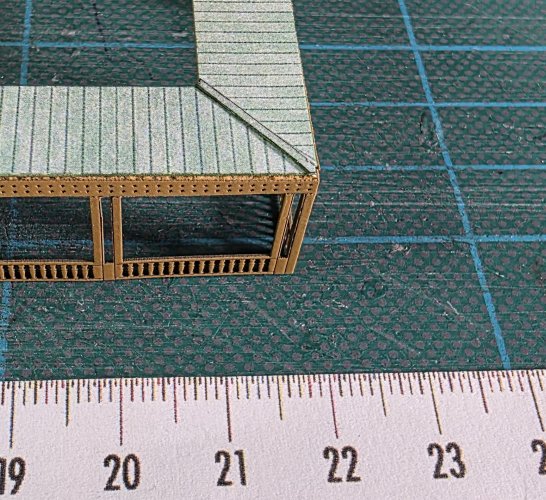

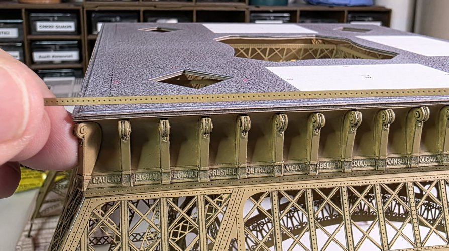

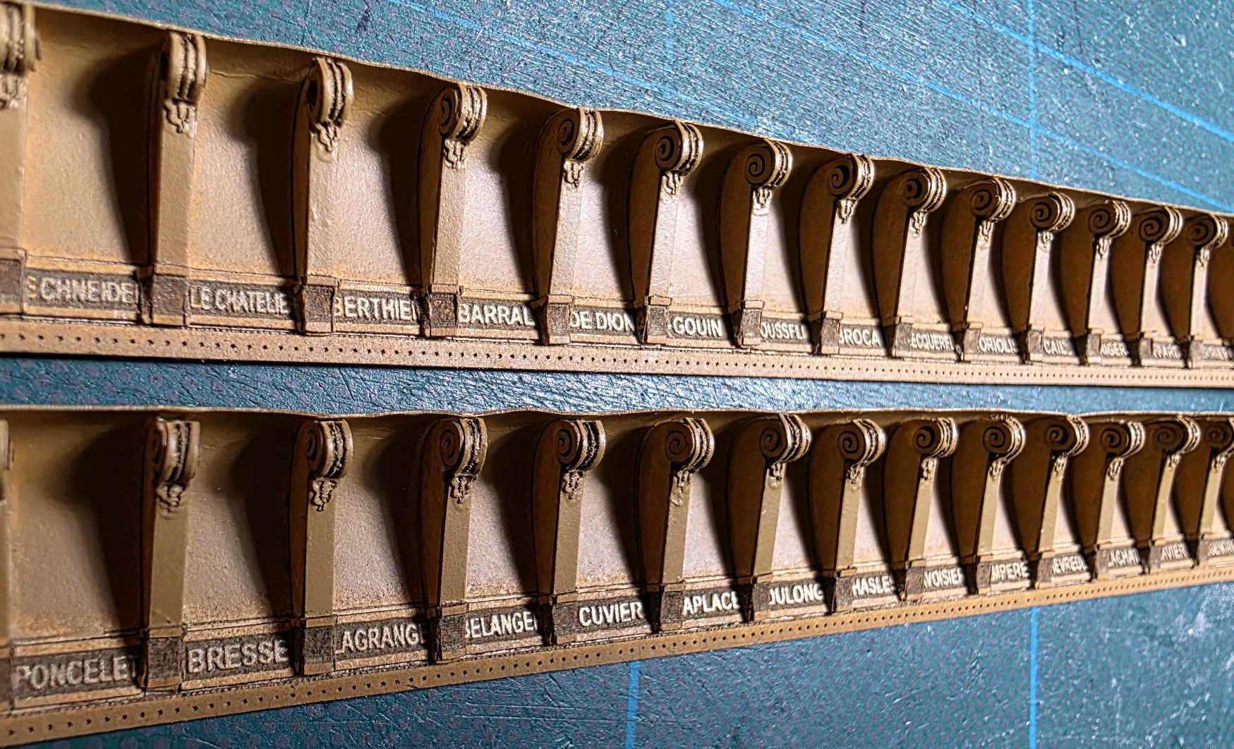

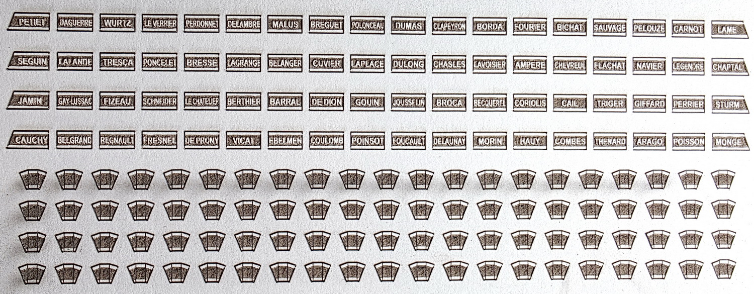

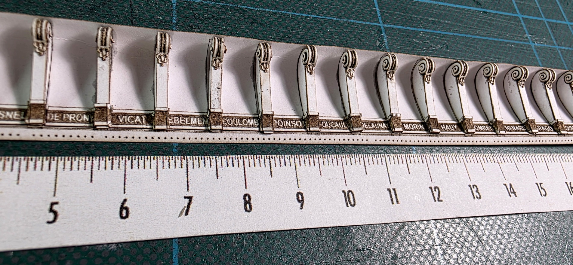

Now there is a last thing to do: the plates with the names of the French scientists that surrounds the four walls. The names in the Schreiber model were not correctly written: I found the right form and sequence of the names in a wikipedia page specifically dedicated to this argument. Drawing the plates and exporting them to the laser cutter was not a difficult task.
A little more complex task was to place them one by one along the walls...

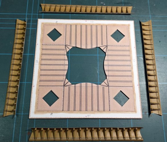

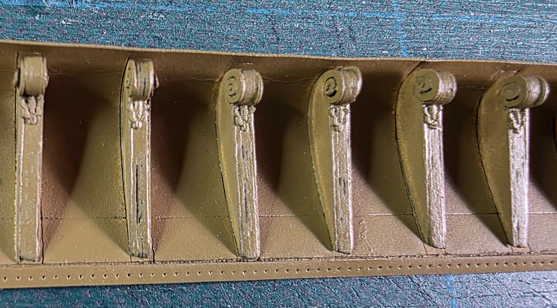

Now, after a new paint job and with some touches with a gold pencil to enhance the embossed names, the walls are ready to be mounted in place.
