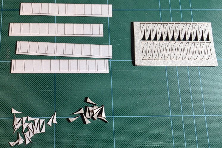

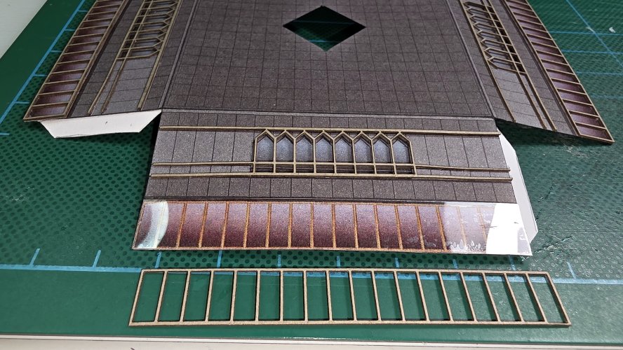

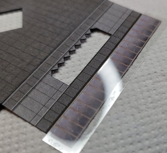

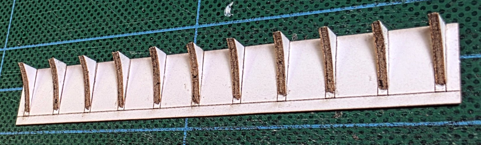

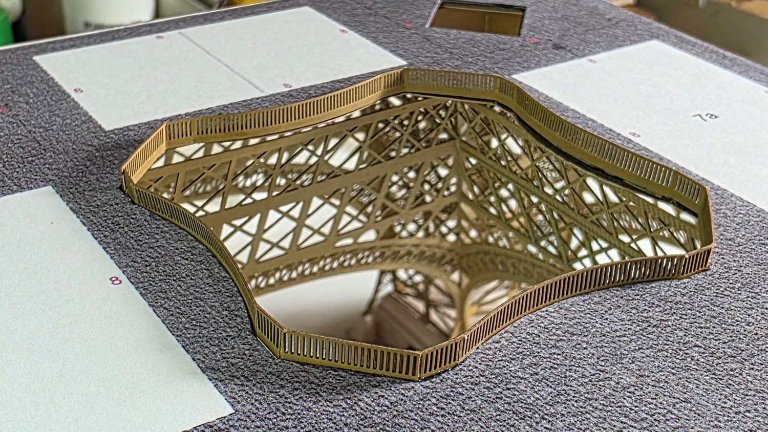

Wow!Now a look to the inner railings,

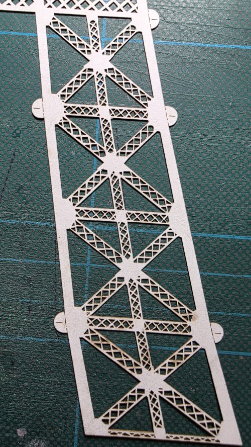

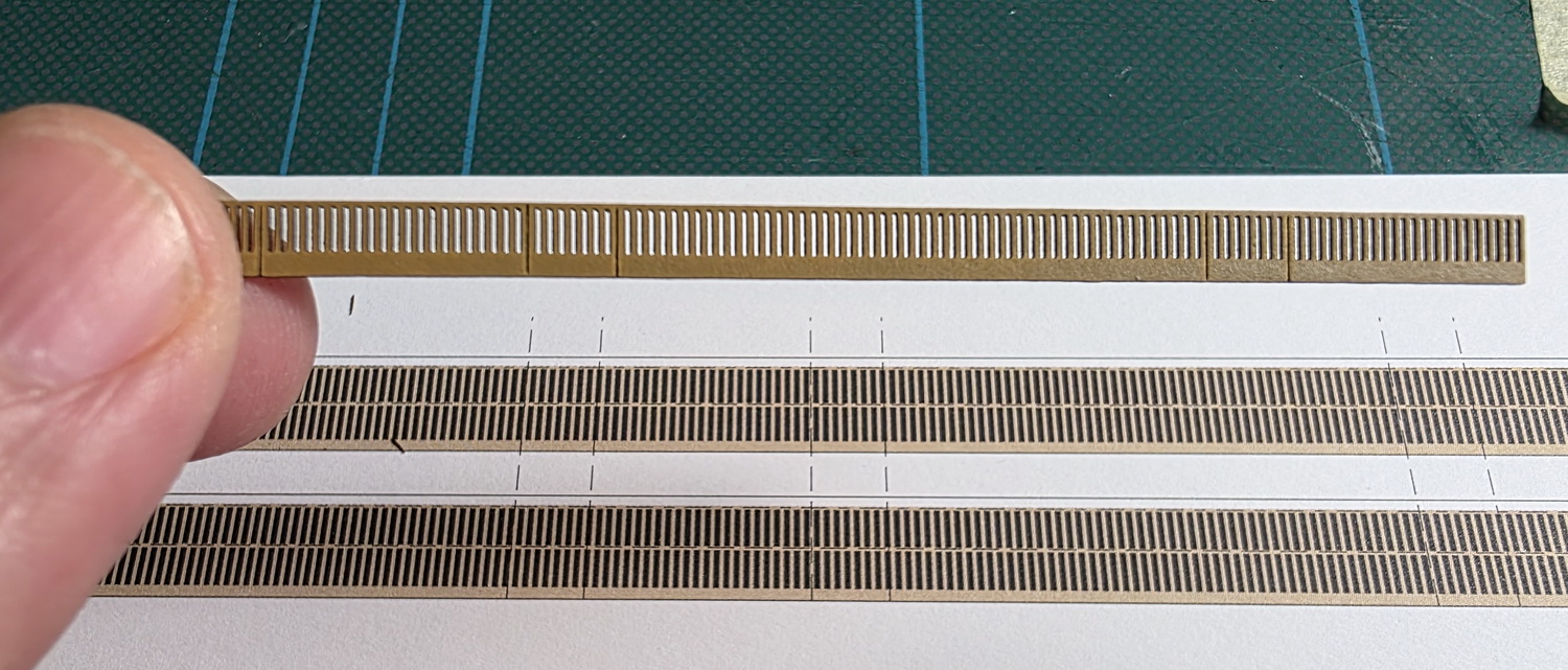

In the back you can see the original Schreiber piece. Obviously the openings are not intended to be opened. No human hand could do it.
But the laser can... and so the railing is done...

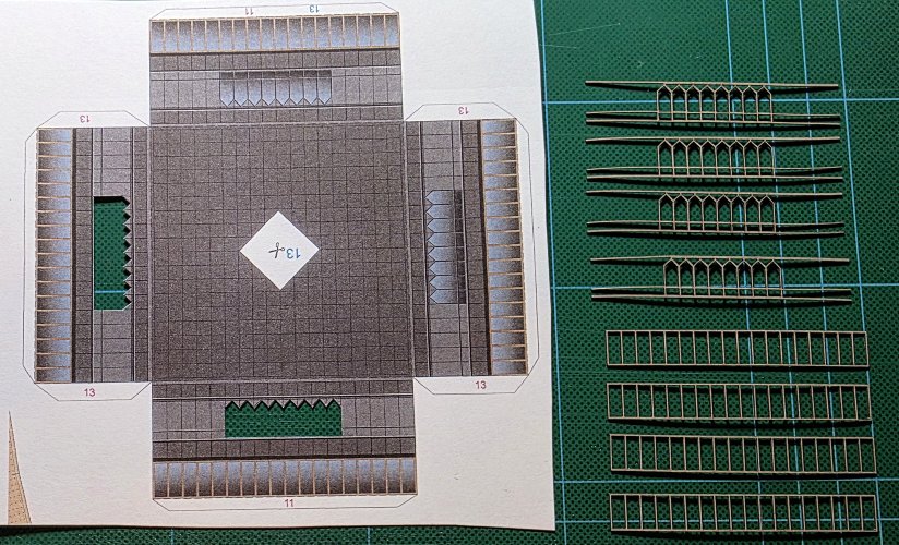

... and placed, with good eye satisfaction...
same thing for the outer railings

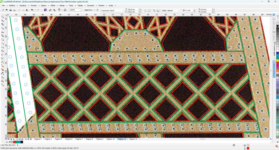

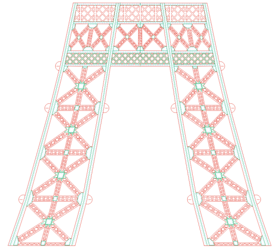

In the back the original one and in front the laser cut one. I also modified the railing drawing to resemble the little columns that form the original one
the four sides once joined
View attachment 230321View attachment 230322

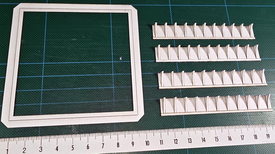

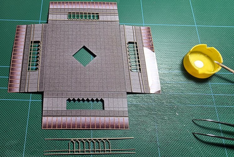

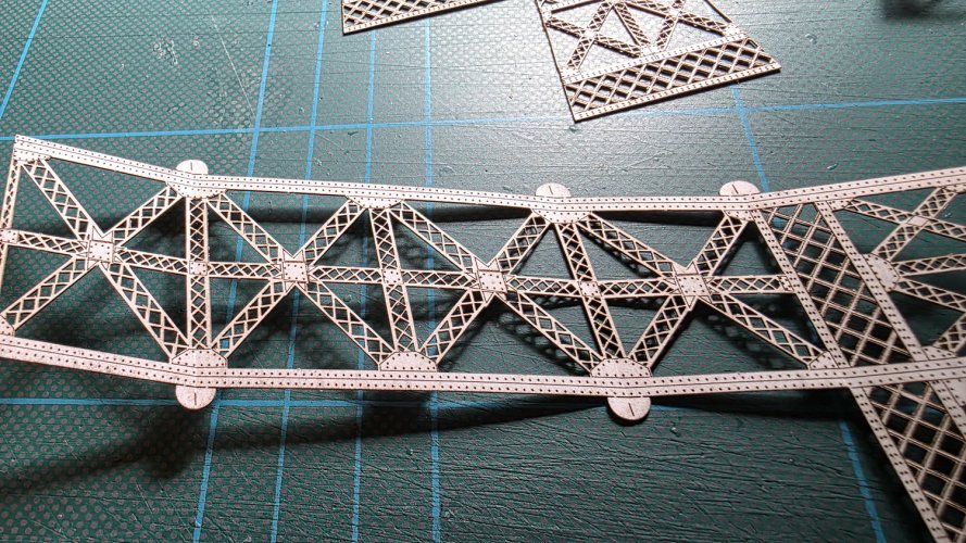

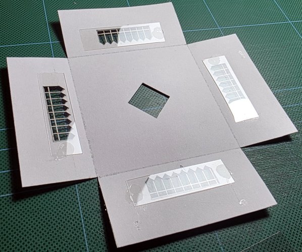

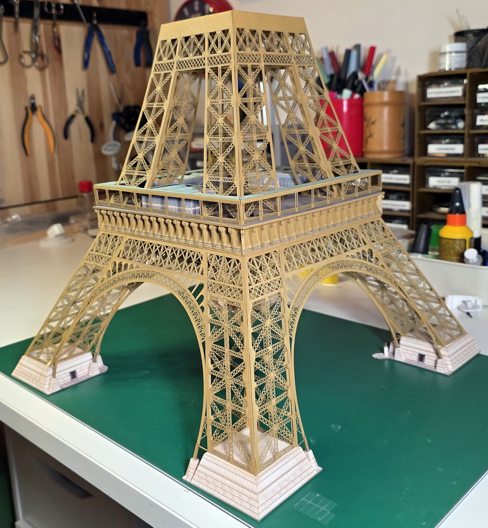

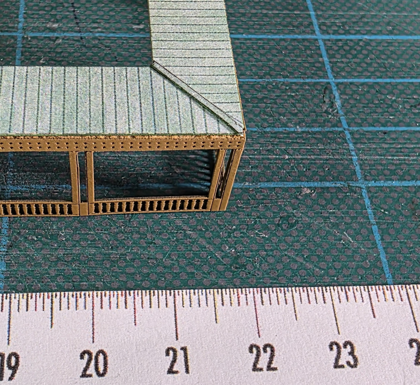

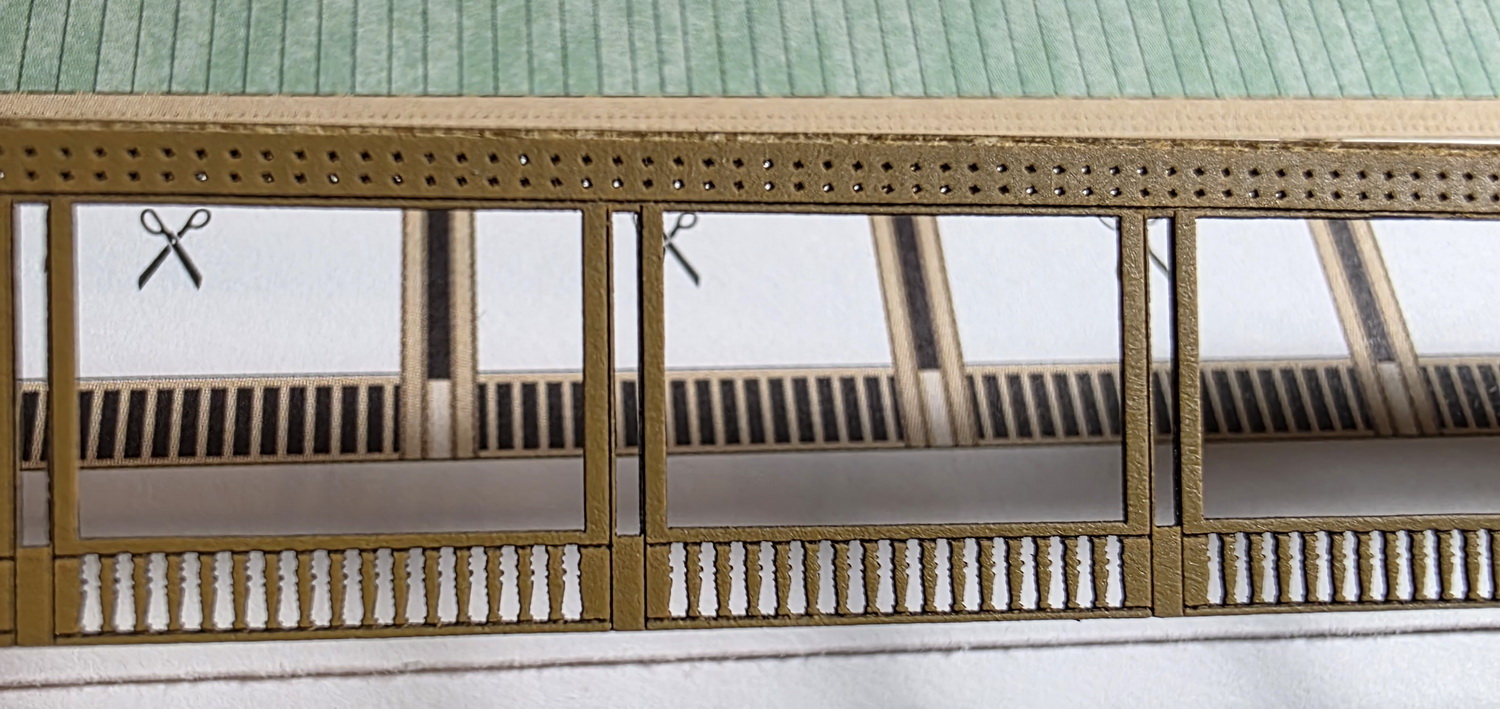

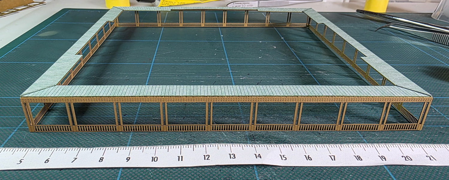

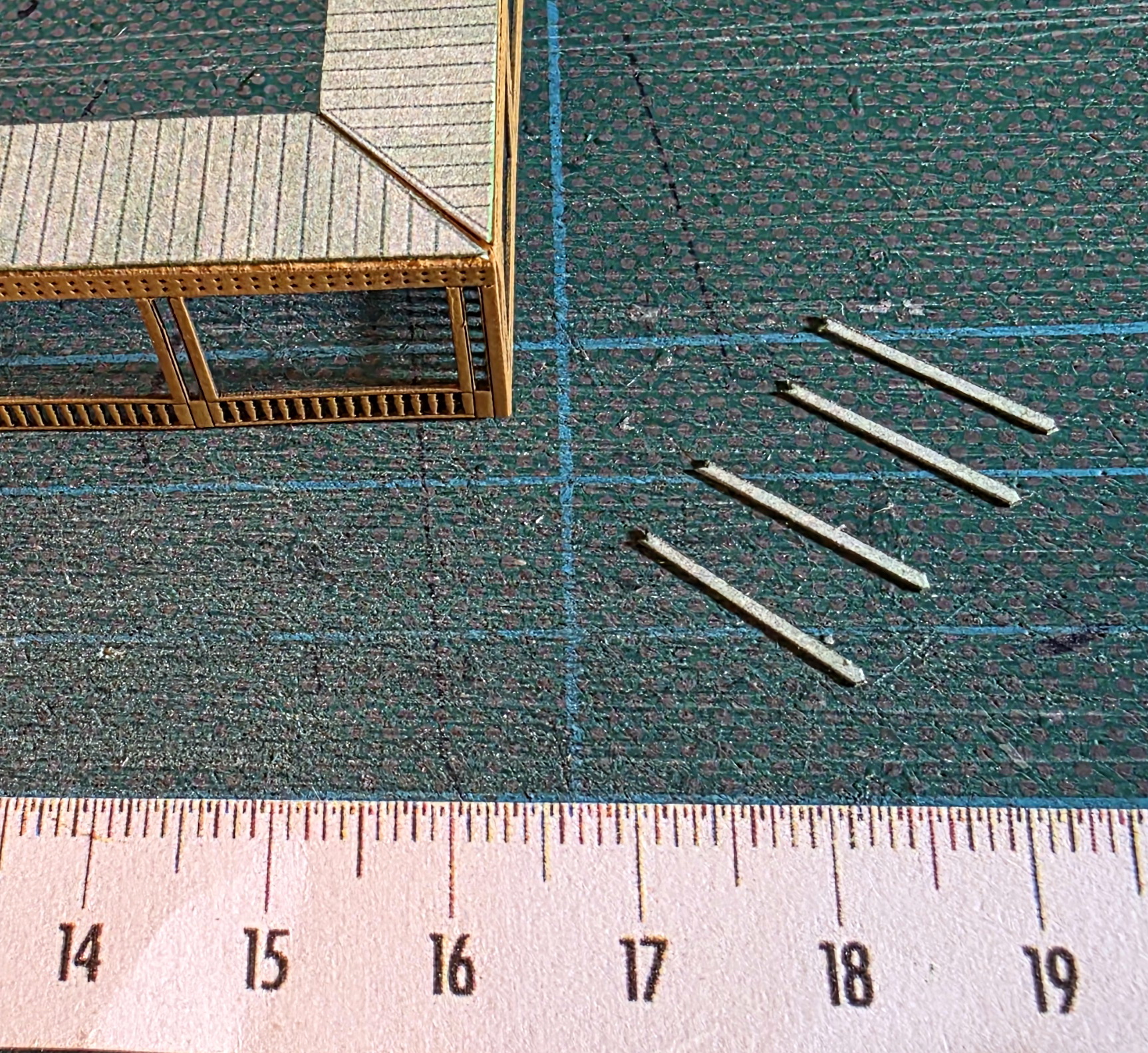

The union of the roofs left big gaps so I realized four strip to cover them and give a better look to the part.

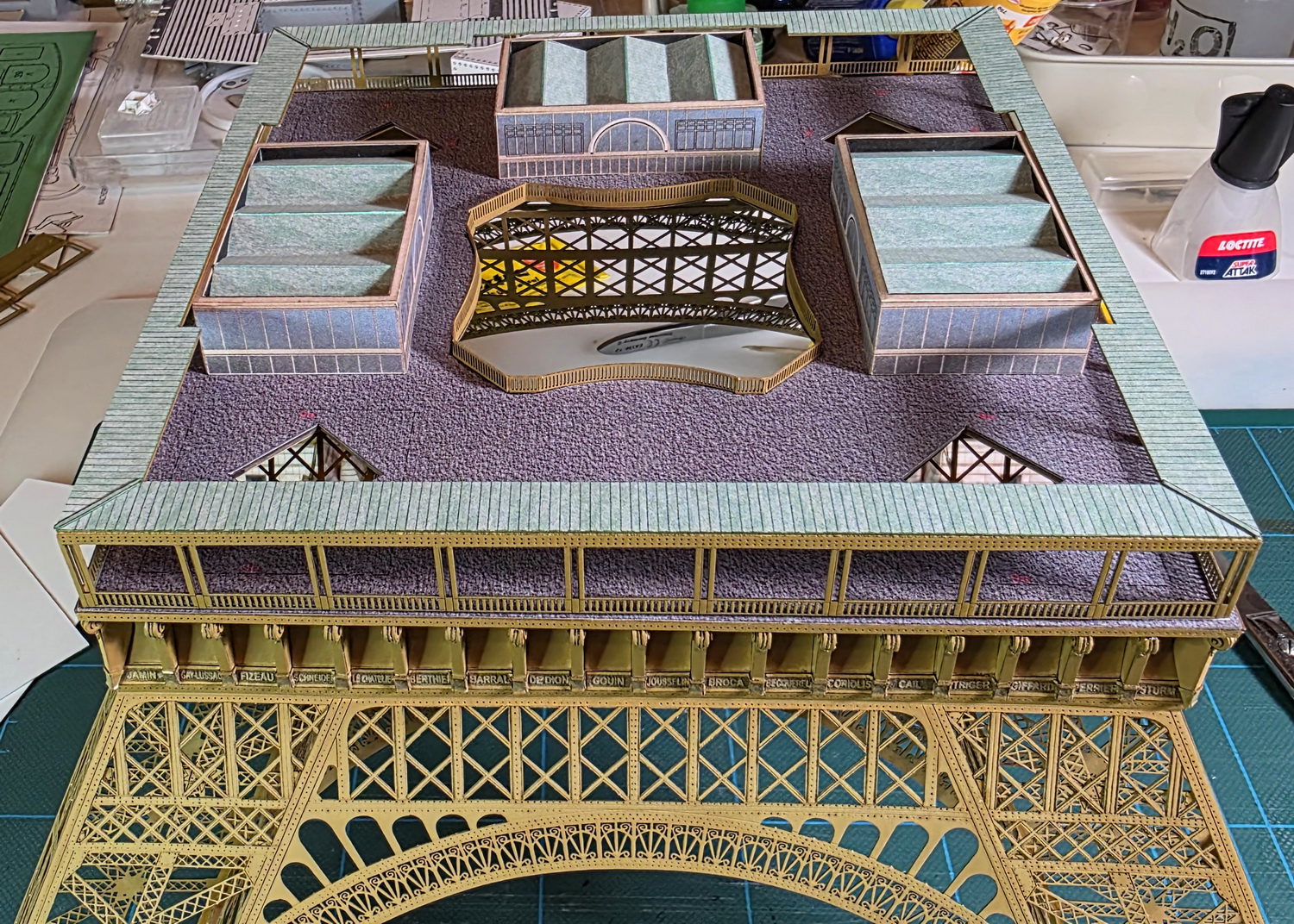

Now the platform is completed. The balcony is just placed, not glued, tho be able to take it away it when I'll have to deal with the next stage.
This is the actual state of the work. Now a new BIG tracing work are waiting... See you soon with the second stage

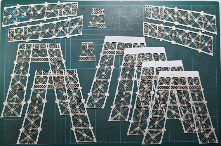

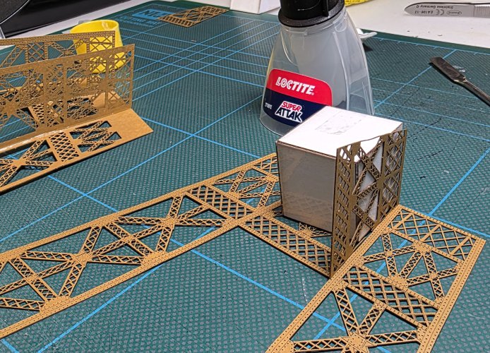

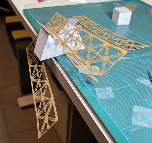

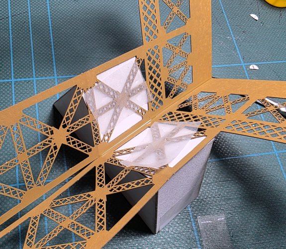

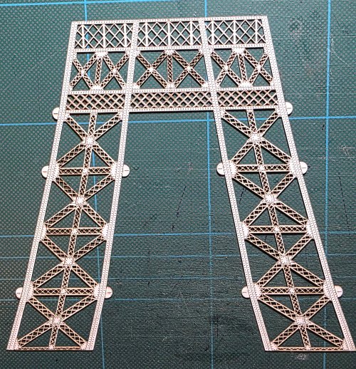

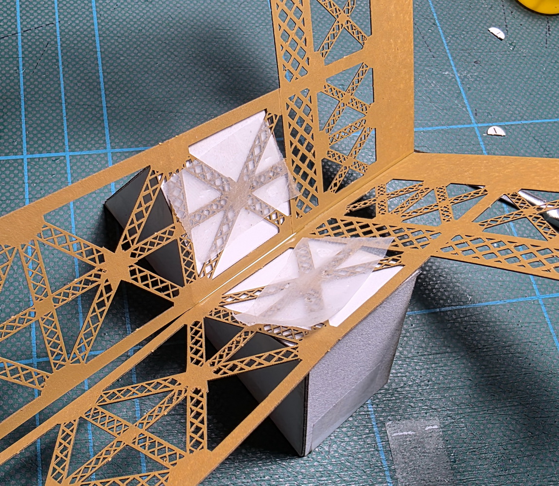

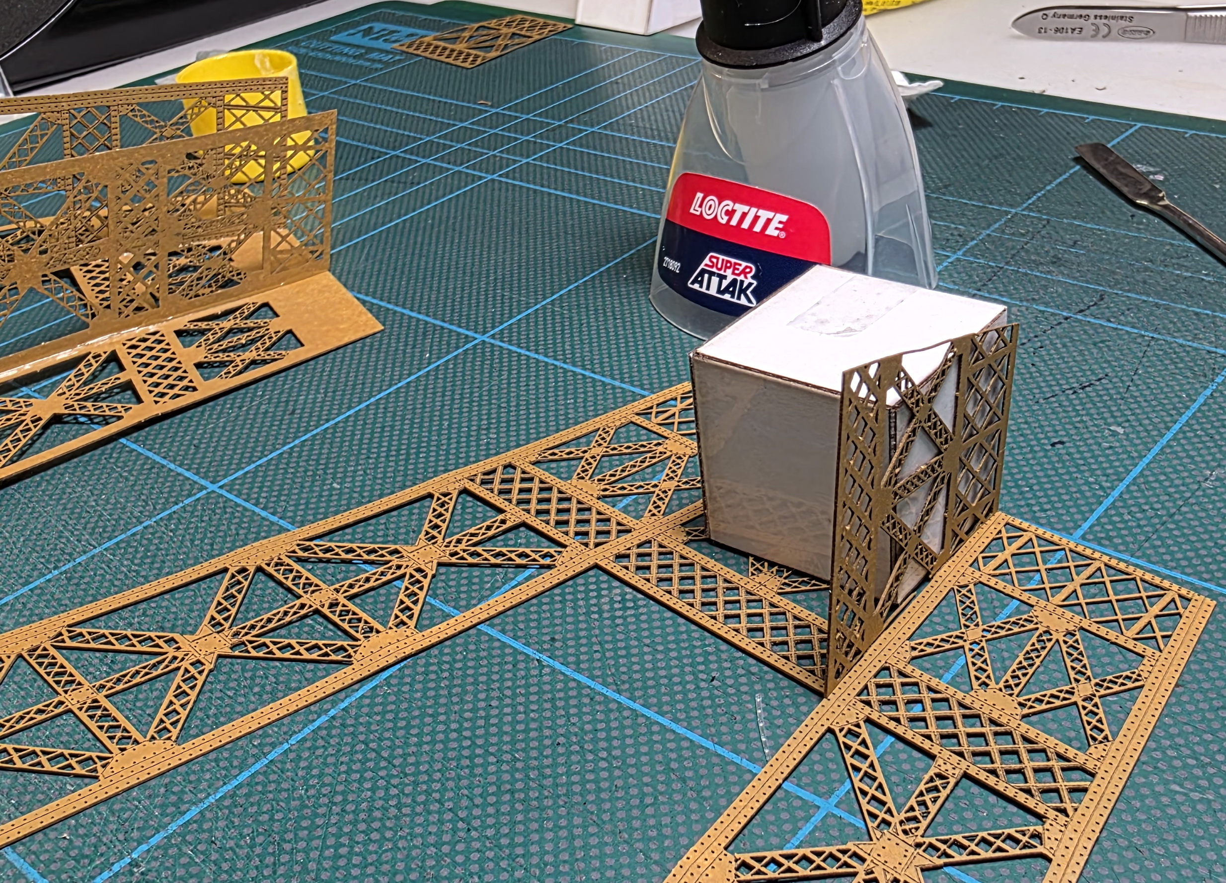

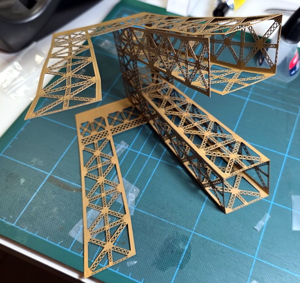

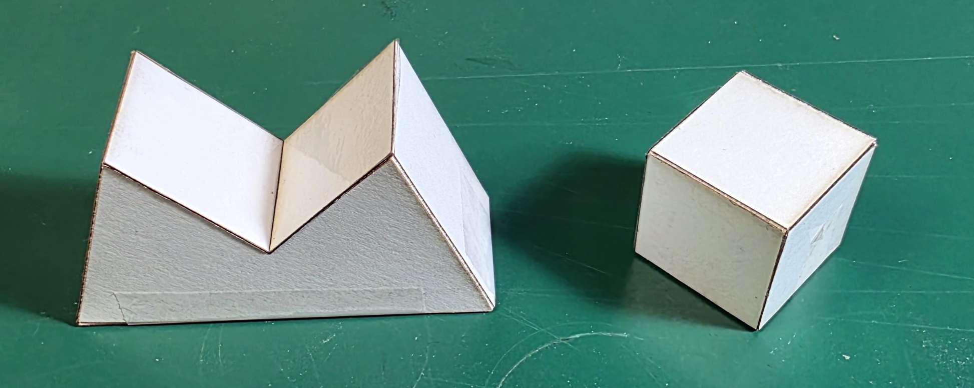

What an amazing work of art!After having painted the pieces the challenge was how to position the pieces to glue them edge to edge in the correct position. As the surfaces are not straight I'll have to glue one section at the time and to help me I built these two shapes that I weighted with some metal nuts inside.
Ths way every section, kept in place with little pieces of Scotch Magic Tape (very good for this purpose), was glued with a fine line of CA placed with a little dropper. The operation was repeated for every linear section.

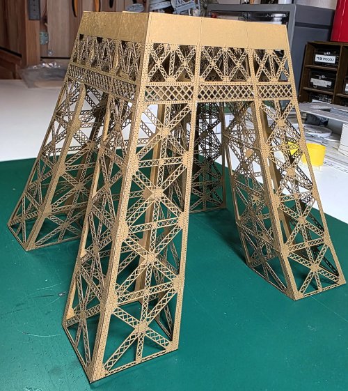

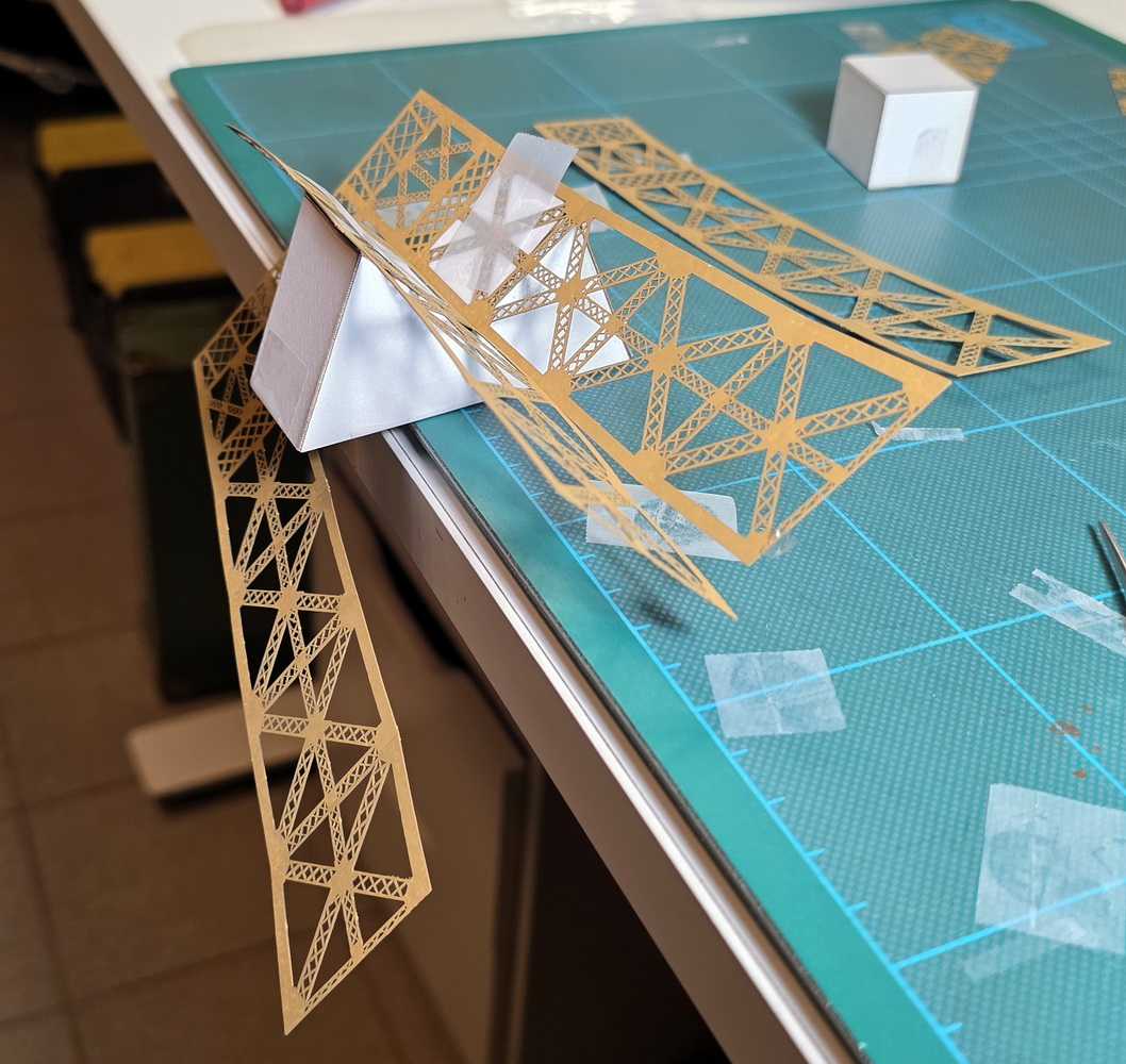

Sometimes the positioning requires some effort of creativity. This image explains why I put weight inside the jig.
The little cube was used when the jig has to be placed inside the structure like in this case.

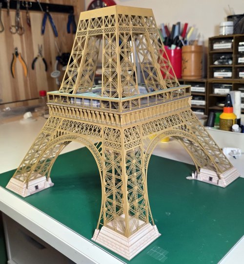

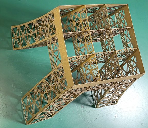

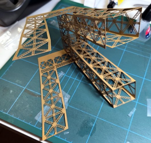

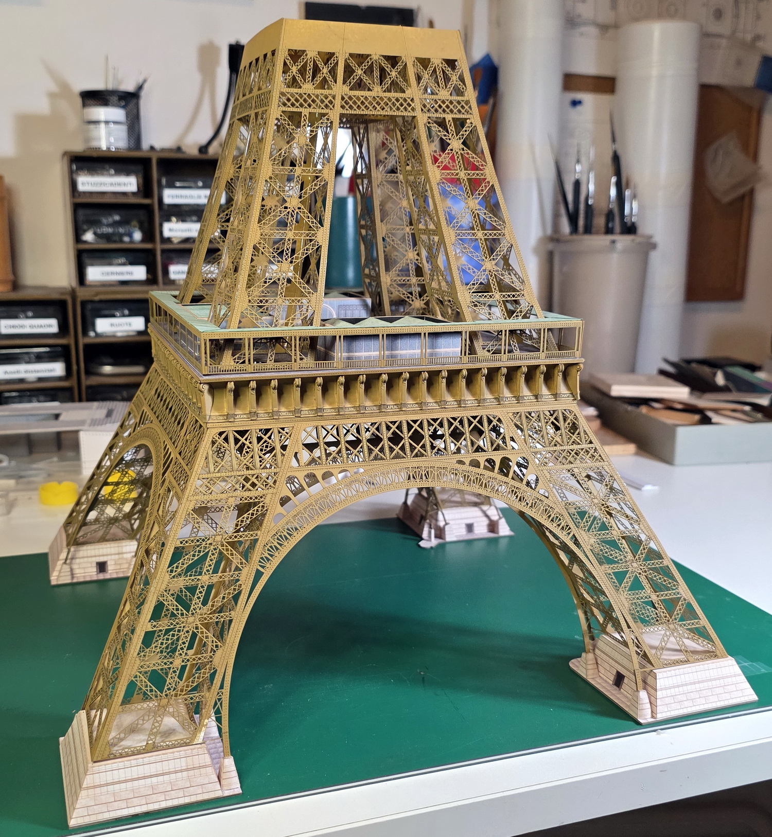

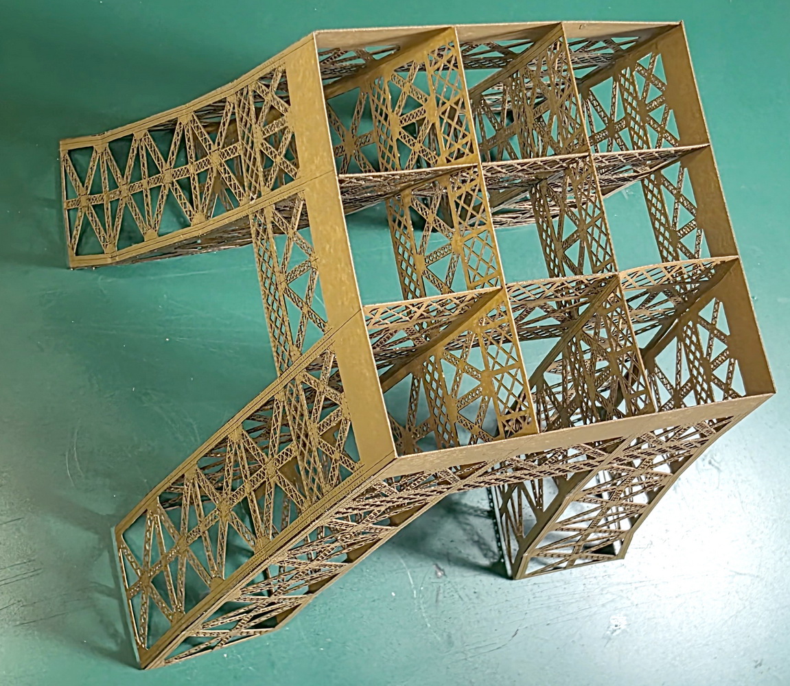

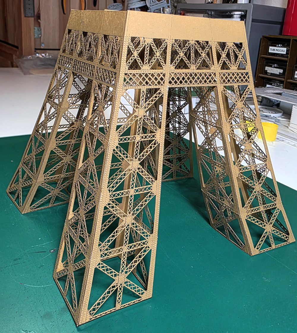

Gradually the middle section gains its shape

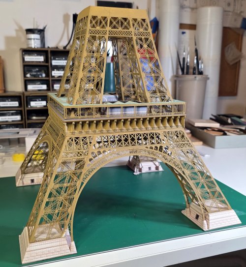

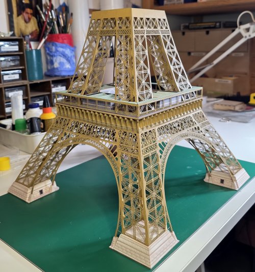

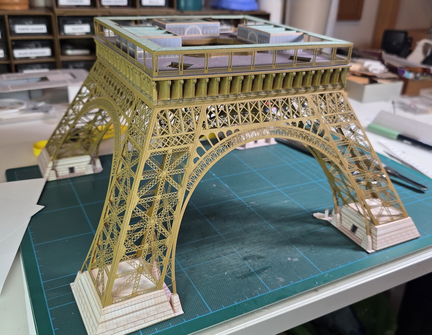

And, after several glue and wait and glue and wait and glue and wait.... the work is done! All the four legs touch the floor without any gap, so the structure is straight and not warped, I'm very satisfied. This phase of the build worried me somewhat but fortunately all is gone well.

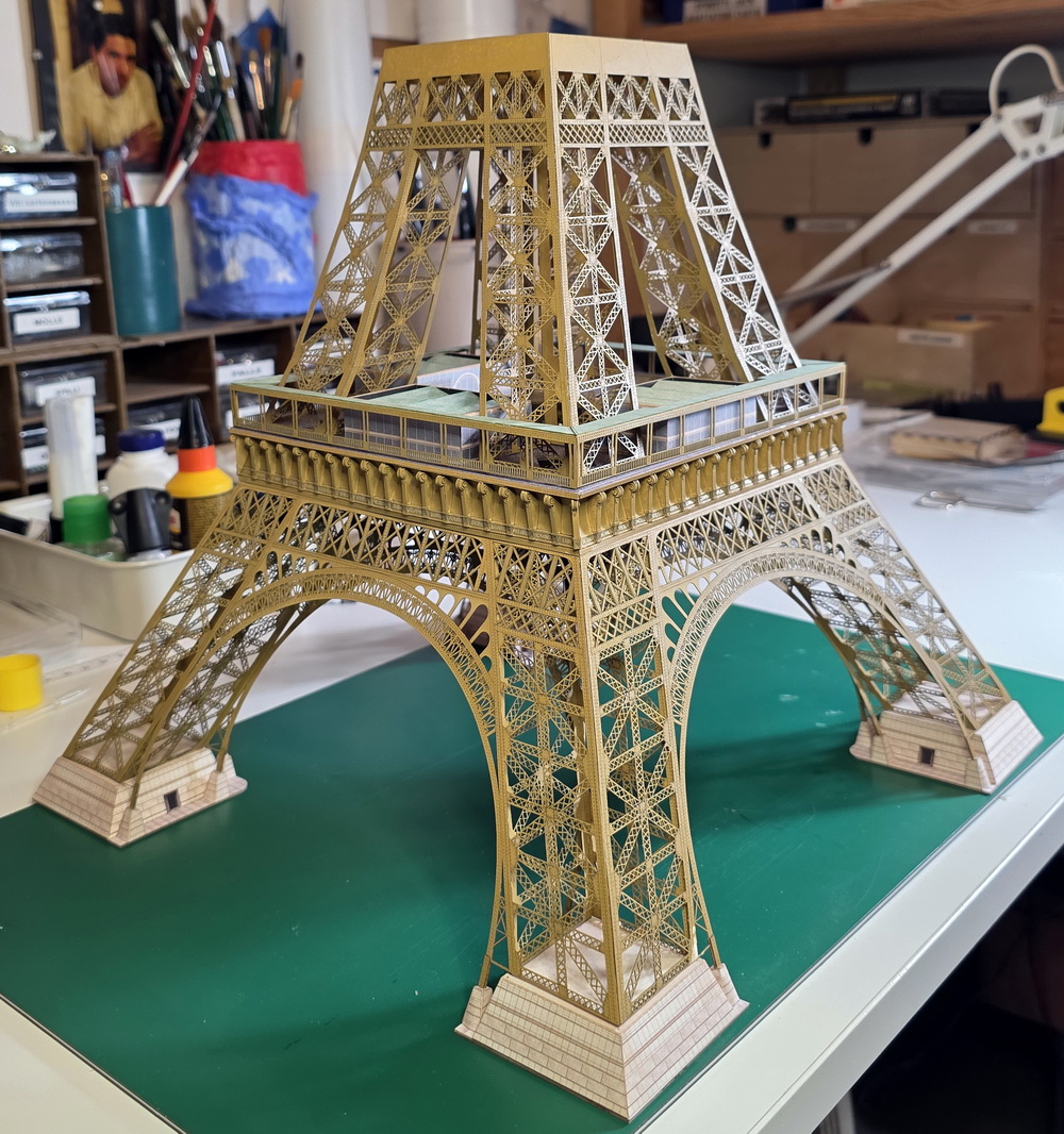

And this is a view of the whole thing at the present state. The sections are not glued but only placed one over the other. I'm thinking about some way to keep the model disassemblable to make easier to transport it around.
That's all for now, soon I'll start to make the second platform,,,
