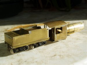

i'm working on one:
Kevin
Brass is fun to work with, also styrene is a fun medium to work with as well, but the brass is Ideal for small and large locos alike due to the added heft of a brass locomotive. Plus, there's tons of brass detail parts out there.
I would suggest that you base some of the drive train off an engine you already have, or use the entire drive train for a good running locomoitve you wish to sacrifice *(Frame, motor, drivers, cylinders, and siderods) to make life easier for your first scratchbuit/kitbash.
Nachoman, your loco is coming along great! I don't think that I would be able to use brass, I just don't have the tools and machines for metal.

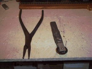

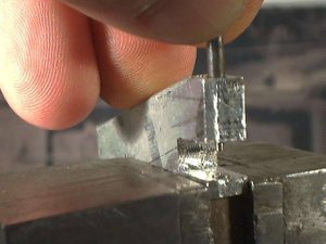

All of your projects are very good! Ray I was very impressed with your engines, considering that one is supposed to be lionel, I am guessing that you work in O gauge like me. How did you do the rivets on your engines? What tools do you use when building your engines? Care to share any tips, you seem to be quite a master at loco scratchbuilding.
I model in O, (2 and 3 rail) HO and N scales. I used to do some 1 1/2" modeling.
I made a few different tools to emboss rivets.
On a few of my first projects I laid the sheet metal on a piece of wood and used a nail to emboss each rivet. (crude but effective)

Lionelalltheway, you can also emboss rivets free hand with just a small nail or similar. This method requires that you use thin material such as 0.010" thick styrene or 0.005" brass. You draw your pattern onto the part, place the part on a magazine (upside down), and then start embossing. With a little practice you can get good results...and then you either super glue the brass or use liquid styrene cement/lacquer thinner to glue it to the backing. If you can find a wheel like Ray has with the right spacing...it is a wonderful way of making evenly spaced rivets. His press allows thicker materials to be "riveted".
