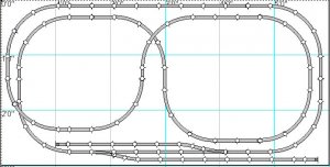

I've been messing with the track layout. I managed to get this folded dogbone worked up and it doesn't stray too far from the scenic ridge layout. I even managed to make all 11" curves. I'm just not sure I'm going to be able to put tunnels where the track runs under it's self on those curves. Do I need strait areas to do overpasses?

You don't need your overpasses to be straight, but it is easier to find straight bridges. You could always modify one, build your own, or find a curved one. I love the way curved bridges look, but I didn't put any on my layout.

Well, it's not going to have any bridges.
It's going to be solid land mass with tunnels under it. That's why I'm wondering if I can make curved overpasses from the foam and also wonder how the portals would fit.
Absolutely, you can make the overpasses any shape you want. Mine are curved. You just trace the shape you want on the foam and cut it the same as you normally would. You can use a knife or small sawblade (messy) or you can use a hot wire cutter (not messy.) I found a battery powered hot wire foam cutter brand new on ebay for $15. Made this job a breeze, and no little white dots to vacuum up. Before I had that, the shop vac got quite a workout.
The portals will fit however you want them to. You don't need to put them where the Scenic Ridge trackplan tells you to. You can move them anywhere, then just build your mountain to match. The mountain gets made from crumpled up newspaper with plaster cloth over it, so the shape is up to you.
Mike
