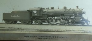

Thanks for posting the photo of the NKP Pacific. I don't have an Athearn Pacific on hand for comparison, but I believe that the cab/boiler assembly on the Athearn Mike is the same as on their Pacific, so I compared your NKP visually to one of my Mikes. The boiler seems to be a similar diameter, although with the smaller drivers on the Mike, it's hard to say for sure. The steam dome looks pretty similar, although the sand box looks to be different. Not sure about the running boards, but it's fairly easy to raise or lower them as required. One big difference is the cab: the one in your prototype photo appears to be quite a bit longer, from front to back. The back seems to be in about the same position, relative to the frame, as the Athearn, but the front of the prototype cab is about 2' or 3' closer to the front of the loco. The piping, air tanks, etc. are easy enough to change, if need be. That trailing truck is available from Precision Scale, or you could use one from a Tyco/Mantua Mikado, or, as I did on my Bachmann USRA Light Mountain, from a Rivarossi Pacific.
The tender looks pretty close to the Athearn one, and the correct trucks are available from Bachmann (see the photo above), so you can also have current pick-up from the tender.
Whichever route you choose to build your NKP locomotive, good luck, and please keep us posted on your progress.
