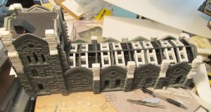

I made frames for the skylights; am going to use grant line casement windows. Other than the Central Valley steel girders, stairs and railings in the tower elevator, they are the only commercial parts. once the glue is fully set, I'll cut out the foam core at the bottom of the skylight wells , and paint the wells white, to help reflect the light from the LED light bar.
Then I'll deck the roof with stripwood, inserting the grant like windows (now skylights) agter they have been painted and glazed. May look at Hobby lobby to see if they have some copper foil I could make a copper roof from. or I may carve foam shingles and paint them gray with a purple tint to look like some really neat slate roofs I have seen.

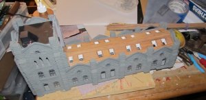

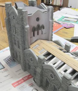

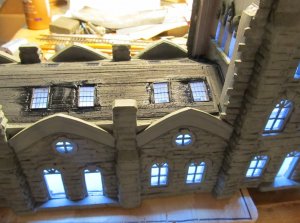

I have started building the wooden decking that will suport what ever roofing material I end up using. I have started framing in the skylight openings to fit the Grant Line window castings I'm using for the skylights. these are the first comercial parts used on the exterior of this stucture. I used some Central Valley steel beams, stairs and railings in the interior of the tower.

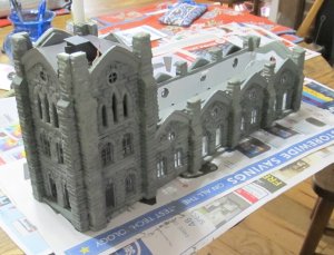

I painted the unpainted foam stones. there are some collor diferences in the photo. the pewter gray acrylic pait is lighter and shinier before it dries; and I couldn't wait to take a photo.
Nelson
I left out a stup this is the ceiling side of the roof stucture, after the skylight wells had been cut out, and the inside of the skylight wells painted white; to reflect light beter, as well as hiding the fact they are made ofut of foam, and foam core.
I build very tight fitting frames around the Grant Line window castings I will use for the skylights, and then decked in the rest of the roofing. Next I will paint this wodden decking black, and that will be the base for the final roofing material. the step after painting the decking black will be to paint the Grant Line window castings, and glaze and install the skylights.. the bright LED;s will make the skylights pop!!

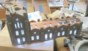

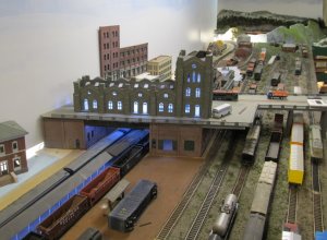

I carried the station to the club, to test it in place with the new roof. the brightly painted white ceiling helps magnify the lighting effect from the LED lighting strips, and as I hoped, the skylights look impressive. the two closest to the tower have the Grant line window castings in them and look really good. I took this photo without the flash. this empasizes the LED lighting, but hides some of the stone detail.
from a stricly scale point of view, I have too much irregularity in the stone work, and too much reilf in the stone walls, but artisticly it works. I have the stone work essentially done everywhere but the back side of the tower, which does not show in this setting. I will complete it anyway, a signature structure like this, hopefully will out survive it's current location, so one must provide for the possibility it may be viewed from a different angle later. that sone work is easily matched right now, but if material availability changes, it may be a bigger challenge later.

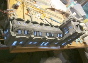

I was worn out and went to bead early last night. Woke up at six am to give the dog his insulin shot, an new daily ritual, when I'm not allready up getting ready for work. odlly enough I felt wide awake, and went to work on union station fitting glazing in the remaining skylights, and pressing them in place. there were some small gaps in places, and places where the white paint from the skylight wells was visable on the top of the roof. I painted around the skylight frames with black aclryic paint to cover any white paint, seal any light leaks around the skylights, and to glue them in place.

PS on the layout the building is plugged int a 12 volt circuit I built specifically for building lighting. Sticking out of the tower roof are two sets of wires twisted together. They complete the circuit to the tower roof, and the tower top floor which are removable for maintenance detailing and cleaning. I have a 9v battery set on those wires to light the LEDs on the workbench. on the layout it is brighter than this,

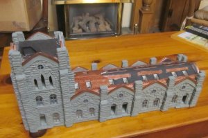

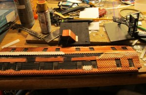

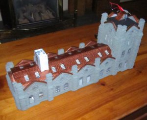

Have been going nuts with the cardboard shingles cut with a pinking shears to get the french shingle pattern. I am applying the shingles and then painting them copper with an acrylic paint from Hobby lobby. I forget the manufacturor, but the color is called old penny, and it is very convincing. I have enough on so I can start putting the stones on the back side of the tower. installing these things is adicting. It was hard to stop this AM; to go up to the RR room and clean track. Dr Tom came over to study my new set up. we were able to run trains in the new Harlow block, the Harlow yard block, and a part of the crooked creek block. lots of vacuming and track cleaning and lord knows what repair and maintenance needs to be done, found three broken olsder joint in just one hand laid switch. I hope the rest of them are in better shape.

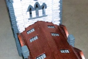

I liked the look of the copper french cut shingles so much I added coper trim to the gables. I think the roof on the stairway shed on the tower roof will get a copper shingle roof to. I will use cut up coffiee filter and black acrylic paint to do a tar paper roof on the top of the tower. Next time I make a ot of french styke shingle strips I will try to document the process with the camera, so I can share the process, as close as I have ever gotten to card modeling..

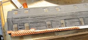

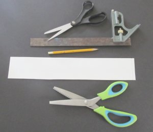

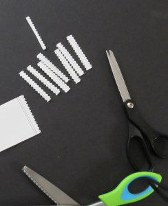

nIn the top photo I have the essential tools an materials a rectangular piece of card board. I'm using some ghost line card board I picked up @ hobby lobby. I'm not using the ghost lines, as the side the ghost lines is on is slicker than I like, and won't paint with the acrylic "old penny" paint well without three or four coats, instead of one or two on the back side of the cardboard.
I use the square to keep the cuts square. I put a line near the bottom to use as a guide cutting the cardboard with the pinking shears to keep the bottom zig zag cut square. the courses of shingles at the very bottom of the roof and avove and below the skylights , I have plain rectangular strips with no zig zag cuts form the pinking shears. I start laying strips cut with the zig zag pattern on the bottom and a straight cut on the top between the bottom of the roof and the skylights. Once I'm past the skylights, I cut strips that ate zig zagged on both sides. the top zig zags ate covered up by subsequent layers of shingles. having two edges that are zig zagged just keeps me from having to switch sissors every cut, saving me some time.
cutting these shingles is just as deadly tedious as carving and applying the foam masonry. Thankfully the effect is at least as impressive. In this photo one can clearly see the 9Volt battery propped up on the roof, with its terminals touching the exposed twisted wire connections of the buildings lighting circuit. when I have the long roof, and the roof on the tower roof stairway shed shingled and painted, I will need to finish the masonry on the back side of the tower. then I will need to un twist the wires on the lighting circuit, and remove the tower roof and the tower's third floor, so I can clean the inside of the station, install some doors, interior details , and Ho scale people. I have been working on this for just over two years; but I may be just two or three months away from finishing it. this is scary, I never finish anything!!

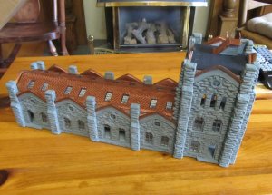

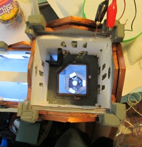

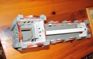

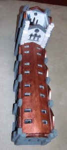

I am making progress on the roof, have the tower roof tar papered using coffie filter paper and black acrylic paint. I have the stairwell access roof shingled. since I took the roof off the tower to tar paper it, I also took the 3rd floor out. and I got another coat of white paint on all of the interior walls I could reach (everything but the first floor of the tower). the white paint is now more reflective, so the lights will be brighter. while the floor is out I'm going to try to make a ticket desk for the center of the tower, making it small enough to fit in the hole between the balconies . then I'll try to add some people and other details in the tower. it will be easier to put that stuff under the long roof which is easily removeable, as the wires have to be disconected to get the tower roof and the tower top floor . I'd like to make something slightly bizzare in the top floor of the tower, like a Super Hero's secter lair, but not suer how to present that.
Reactions: toptrain1
I have the roof done. next I will be cutting and gluing stones on the back side of the tower, working to build pieces for the interior, making the internal staircase down to the lower levels, and adding some scale people to make it the busy place it needs to be.

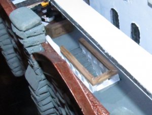

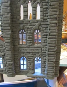

almost done with the last of the stones on union station. There are a few triangular shaped stones that need to go in the shadows to either side of the arch castings. I will be working on interior details . I may want to add a massive stone fireplace to the inside, possibly with a fire simulating LED. that would draw the eyes into the windows. It would also require a massive ornate smokestack.
I have the stones done on the back side of the tower, and just a little paint touch up to do on the gray stones. At the club, in its proper setting one can see into the building a little better than I had thought possible earlier. I decided a view break, with some interesting detail, would be useful, and so I am putting a massive stone fireplace in toward the end of the long section, between two of the buttresses, where it won't interfere with the skylights.
the section of foam I am going to carve the fireplace out of is notched at the top, and helps support the LED lighting strip that runs down the length of the building just above the level of the windows. The chimney is larger than one would expect. this is based on the Nashville Union Station that has a large smoke stack disguised as a tower There would be a massive boiler somewhere to heat the above and below street level of this structure, as well as possibly to heat passenger cars that were not hooked up to a steam locomotive.
when I get the fireplace carved for the inside of the building; it may be hard to resist one of those LED effect packages that replicates a flickering fire. that would really draw the eye into the building. As it is I am mighty close to being done with the main structure, I just have a boatload of interior detail to come up with.
