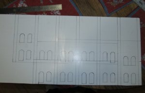

I had some Ghost line foam core, white foam core with a grid of light blue lines to aid folks with graphic design on the foam core. I started laying out wall shapes directly on the foam core, sketched in window and door locations, and when it was penciled in and satisfactory I traced over my pencil lines in ink, and then cut up the wall sections, and assembled them to become a mock up. I like the look of the building, so I will begin building it right on the mock up, so the mock up will become the base for the finished building, saving me a step.
Usually when I scratch build something, I have some commercial window and door castings in mind that I build the design around, but this time I could not find anything that I was excited about, and this brings me to the stretch part of this project. instead of using commercial doors and windows, I am going to make masters for the windows doors and some other architectural features. so I will be trying to learn mold making resin casting for this project.
I'm going to try to cast the windows and doors and the arches above the windows and doors, and I will cut dense foam to make the rectangular shapes for the cut limestone for the building. there will be a narrower clock tower sticking father out from the center of the tower. the terminal will be above grade with the tracks and platforms underneath the station accessed by stairs leading to the interior of the building.

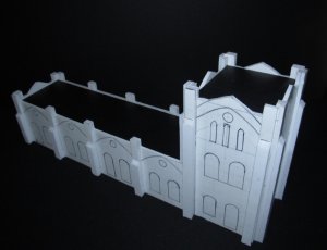

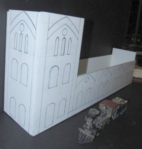

ASL   U S w bttss.jpg ASL w&d blks#2.jpg it has some butresses
I have added some buttresses to the foam core structure. I am really liking the shape, so I am no longer calling it a mock up, as I am rather sure the building is going to grow out of this frame.
I took it to the club last night, and built the mock up for the below street level box it sits on, with cut outs for the main and the station tracks . unfortunately I forgot to take the camera. it looks pretty good in it's intended location, and it will help the looks of the big yard considerably by breaking the view up a little.

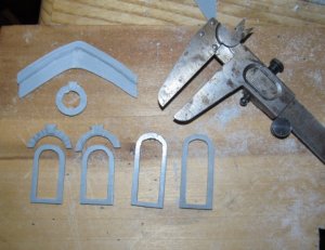

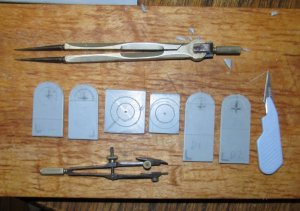

I have some blanks , cut out of thick styrene, that I hope to shape into the masters for the molds for the windows and doors.
I used the antique drafting tools, which were my grandfather's, to help get the shapes right. I also want to make some molds for some architectural details, as I get further along on this project, and have a better idea about where I am going with this project. Once I have some windows and doors in hand I can start cutting out the window and door openings, and painting the inside and outside to seal the cardboard part of the foam core against moisture to help prevent warping, Then I can start carving foam "stones"; and begin the masonry work, which will hopefully transform this from a foamcore mock up into an impressive limestone edifice.

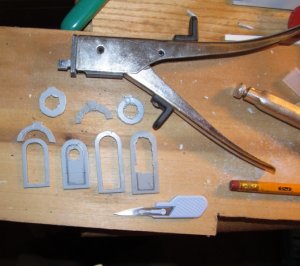

ASL wnds&drs#2.jpg progress on the window and door blanks
I have made some progress on the window and door blanks, drilling a hole through them big enough to get my nibbler (from Micro -Mark) through the hole, and then I can nibble the inside opening to close to what i want, and Finnish it off with files and sand paper.
when I have them all done I'll glue them on a flat chunk of styrene, and start gluing mullions and doors in place to make the masters for casting sufficient windows and doors to do this building,
I'm glad I'm just making masters, this is taking forever, I am reminding myself why I don't make windows and doors much. If I wasn't making two each of the windows and doors I'd be much farther along, but this way if I *** one up all will not be lost.

Neat nibbler. I haven't seen one like that for years! I have an air powered one. This one is nice for delicate situations. :)
My first experience with a nibbler was an air powered one I borrowed when doing custom speaker installs in autos. I never bought one, cause I hated those jobs, and if I had the right tool I'd have gotten all of them. When I saw this one in a Micro-mark catalog, I bought it on a whim one year when I set out to spend my yearly train budget on tool from Micro-mark. It has been extremely useful in shaping brass and plastic parts and pieces, both speeding projects up, and giving cleaner results at the same time.

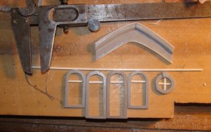

ASL US  wndw & trm msts#2.jpg U gave started work on the arch section master, and got a lot more progress on the round window master, and the window and door master.
I have yer to start on the tall narrow windows for the tower. I will have to make them shorter than drawn on the mock up, to allow room for the round window and arch detail as they are shaping up.
I'm taking a lot of time with the masters, but I recon it will be well worth it, as progress on the building should take off one I have windows and doors. In any case this will be a focal point at the big yard, and will be well worth the time taken to make the model excell.

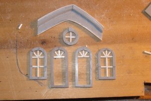

ASL-AUS w&ds#5.jpg I'm making progress with the roof arch trim. the round window and the doors and widows. the window archs come off lopsided every time. I'm going to make a mold with the roof arch and the round window in it, as I will need the exact same number of those two parts.
I have started the laborious process of putting in window mullions. they are oversize, but considering the trouble I'm having getting them right that is probably a good thing.
still trying to wrap my head around the look I want for the doors, and how to best achieve that.
ASL-a US w&D  #6.jpg I got the mullions in the windows, and the arch treatment done on the doors. still don't know what The doors will look like, but I will cast them as is, and cast the doors later. that way I can model some of the doors open should I wish, and more importantly make progress before I get the doors figured out. the door openings are about 8.5 feet tall and three and three quarters feet wide. That might seem big to some of Y'all, but the doors in my front hall are just slightly smaller.

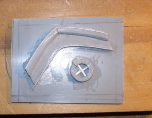

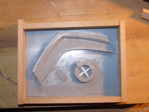

asl-1a mld1a.jpg asl-1a mld1b.jpg work on the first master
I have the first master done, and made a mold box around it. I'll give it over night to dry, and try to make a mold tomorrow.

I usually try to do a step by step , with photo's to help teach folks, as Many folks helped me learn this stuff over the years. with the casting , I might not be as detailed, as I am in the middle of the learning process myself.
Back in the 1970's I did some experimental casting of small parts, using liquid latex molds (like the ones I have used for rock mold for scenery), and with rtv silicone like folks used to use for automotive gasket applications. For those parts, I cast them in epoxy , mixed straight from the glue tubes More recently I have done some large plaster (hydrocal dental stone) castings in molds made from liquid latex; creating the iron furnaces and coke ovens for the iron industry, that is the side line for my logging railroad in HO.
For this project I will be starting with a mini casting kit, from Alumilite, which I purchased from Hobby lobby. casting materials, and instructional materials are also available from Micro-Mark, and I expect I will end up using a lot of their stuff if I get into casting big time.
The master I made for the roof arch and round window is almost ready to pour a mold. all that remains to be done is to thouroughly seal the wood dam. That mold would probably use up most of or all of the mold making material in the kit though. I'm planning on working on the station from the ground up, so I will need the windows and doors first, and wont need the roof arches and round windows until near the end of the build. so I'm going to work on the master for the window and door mold, and make that mold first, cause once I have the windows and doors, I can start work on the exterior of this station, and that is where this will start to get fun.
I'll try to show step by step what I am doing, but this is early in the learning process, so one would be very much advised to read my stuff lightly, and the instructions for whatever material they are using very carefully .
