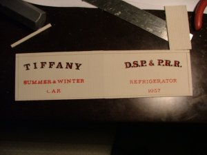

#2 The lettering wasn't quite aligned...most noticeable where the black & red don't overlap...no one knows what color the lettering was on these cars...red or black is fine...mentioning the color will also make many-a south park fan's blood boil (I lean towards the white faction...some say straw yellow...some think mint green...the waycar debate is similar...white vs. straw yellow)

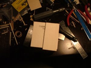

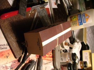

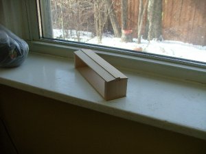

The first picture is of the unmodified core...which I hacked 6" off of the height of the end blocks. I also flipped the roofwalk support sideways...to get nearly the proper width...and notched the ends to offset for how it would have been raised by my alteration...suddenly it is the right height (or nearly...the floor will sit 2" too low...and the sills be 2" too short...oh well...it is close enough.

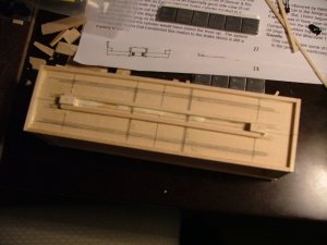

Next I trimmed 4" of width off of each block...and 4" off of the floor...since it was a serious kitbash now...I also trimmed 4" of length off of the floor and off of the roof parts.
I then glued the core together.
Next I laid out the floor with my calipers, my scale ruler, and a pencil. I mounted the altered bolsters, the shortened center sills (which were shortened to provide material for the end sills), the end sills, and the side sills (not following the floor...but rather my calipers so they'd be square).

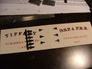

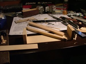

Next I filed the hinges to shape. I quickly learned that cutting them was easier & more accurate than filing...after I'd done the first 6 :rolleyes:. This picture shows both...the alignment issues on Tiffany and DSP&P aren't quite
obvious.

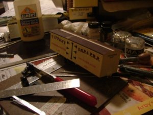

Next I cut the sides to size...centering the lettering & making sure they'd fit nicely onto the core. I also trimmed the ends to length and mounted them.

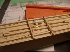

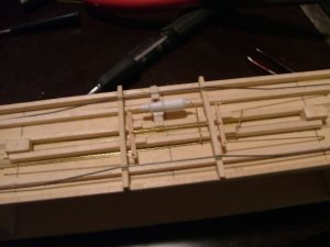

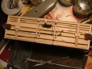

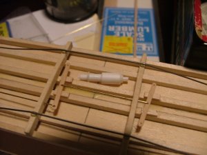

Next it was under frame time. I visit my LHS and picked up some 1/8"x1/8" (6"x6" in O scale). I used my calipers and a razor saw to turn it into a 4"x6" for the needle beams. I also mounted a pair 3/32"x3/32" intermediate sills (appx 4"x4"). I used some Coronado castings for the QPs...and CA'd 0.025" wire which I'd formed to serve as trussrods...with each end inserted into a hole in the end sill.
I formed a pair of brake levers from a scale 1"x3"...and drilled 0.021" diameter holes in them for the brake rods. I also drilled a pair of holes through the needle beams...2" from the tops. I made the brake rods out of 0.020" brass wire.
Next came the brake cylinder which I fabricated...from some simple tube & rod stock...unlike what is commercially available...mine is accurately dimensioned for first generation Westinghouse automatic brakes that were applied to the DSP&P cars over the winter of 1883-84...and mine cost around $0.05. I then mounted it onto a fabricated mounting bracket which I mounted to a 1/32"x1/8" piece of balsa...per the prototype cars that weren't built with air brakes.
I then formed the brake lines from more 0.020" brass wire. Now all it needs is some black paint on that underframe :mrgreen:
Next up will be the coupler pockets, the doors, adding weight (it needs 2.5oz), grab irons, the roof, and the trucks.

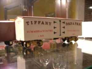

I've got the car pretty close to complete. It still needs the roof walk, end fascia, and the brake hardware for the B end (it is already equipped with a complete brake set...I could have been operational if I hadn't elected to use glue)
The brake rigging is identical to the brake rigging in my DSP&P B&S boxcar thread.
