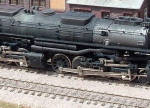

The siderods are usually nickel plated and very resistant to chemical blackeners, including Hobby Black. Silver siderods, while not typical of all roads, were still seen on steamers, even heavily worked ones, so don't fret too much. I weather mine with everything else, then cover it with a coat of Dulcote...haven't lost a wink of sleep in 32 years in the hobby:thumb:
Some plated siderods seem to be more resistant than others to the effects of chemical etchants like gun blue or model railroad products like A-West Blacken It or Hobbyblack. In any case, if you're going to use these products on your models, it's best to disassemble things first. Many plated siderods seem to have a light coating of oil on them, which will prevent the necessary chemical reaction. With the rods removed, they can be easily degreased. Another thing that can interfere with the etching process is oxidation, and most products recommend that the parts to be treated be cleaned with fine steel wool first. This is something that should definitely not be done while the parts are still attached to the loco: a loose bit of steel wool can end up in the drive train, or be attracted to the magnets of the motor. The other reason to have the parts that you are blackening separate from the loco is to allow you to wash the parts to remove all active traces of the etchant before reassembly. If etchant is left on the parts, it can continue to "work", and may actually damage some parts - bearings and places where moving parts are in contact are particularily important areas where the etching process must be stopped.

One other option for blackening siderods is NeoLube, a graphite lubricant in suspension. Not only will it blacken/darken the side rods, the graphite lubricates the moving parts. It does not "handle" well, so you may need to reapply occasionally. It is also VERY slippery, so be careful not to get any on the treads of the drivers.

I've painted side rods before to good effect...but I don't have any pictures of those engines.
