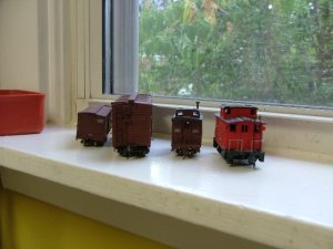

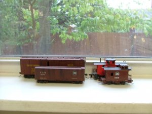

Here are a couple of pictures that might help...
The standard gauge box car is a 40 footer by Silver Streak. The standard gauge bobber is by Mantua. The 3' gauge bobber is from Grandt Line and the 3' boxcar is a 30 footer from Grandt Line. All are HO scale.
If you're looking for the easiest HOn3 to model...I'd recommend the Rio Grande. Grandt Line's D&RGW freight cars run about $20 US and are just plain gorgeous. They just need a little additional weight added. There are also plenty of other suppliers such as Rail Line, Labelle (which offers passenger cars for around $30), and Precision Scale. Motive power can come in the form of brass engines (which sometimes go for close to $200 for older ones) or in the beautiful new engines from MMI (a Precision Scale division) or Blackstone models. The old MDC/Roundhouse HOn3 outside frame 2-8-0 is a decent model to letter for D&RGW #375. The inside frame isn't really a model of anything.
Free lance is nice too.
As far as bolt counting which goes with the hobby, all of us have a "good enough" level. For me this is having a locomotive and cars that stand up to a moderate glance of a knowledgeable railfan. For instance, a hudson lettered in D&RGW bubble bee is not an acceptable locomotive for my railroad. But either a Bachmann On30 mogul for a C&S Brooks mogul or the fore mentioned MDC 2-8-0 are acceptable. On the other hand, the more interest I have in something, the more detail I want.
I recommend starting off with D&RGW stuff since it is easy to come by. If you find that you prefer the Cincinnati Northern, Irish railroads, or the Kansas Central...you have a good feel for HOn3...and have something to run until you rare equipment finds its way to your railroad.
