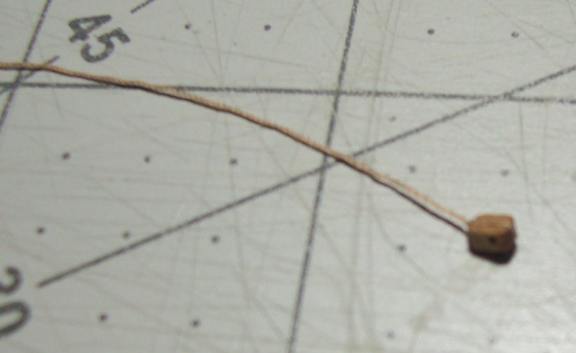

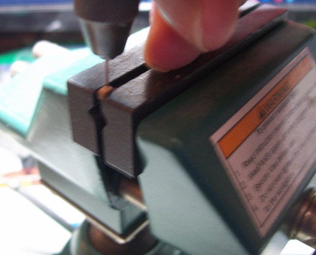

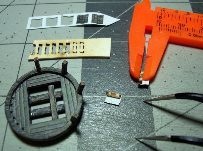

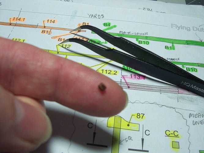

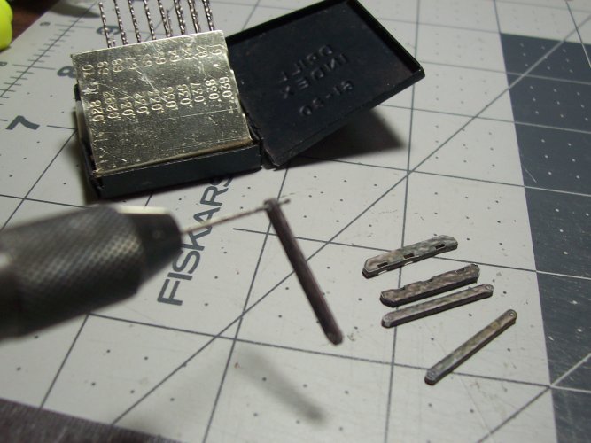

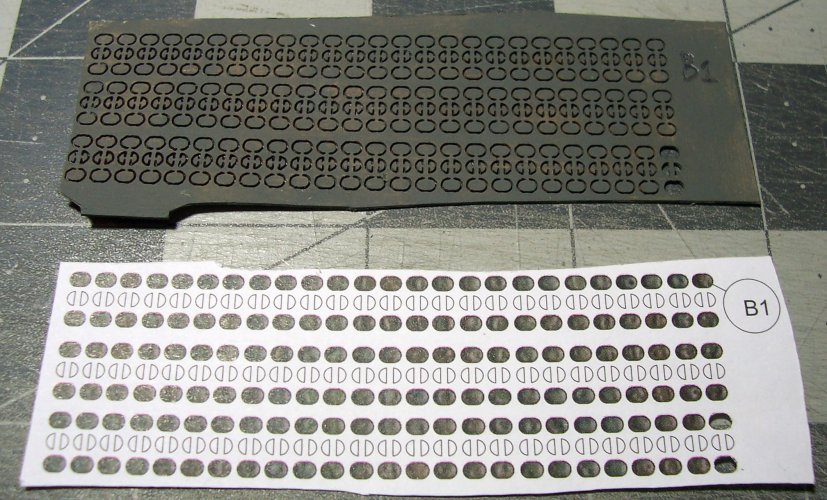

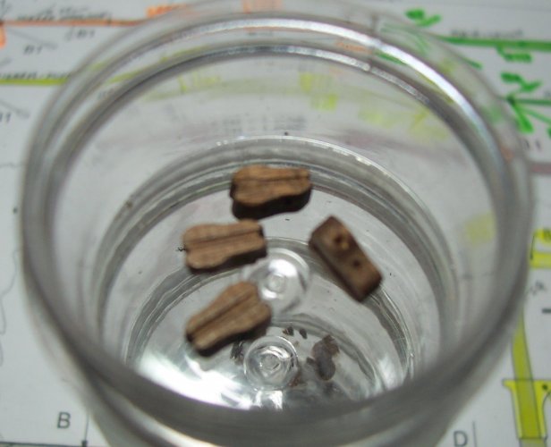

So, here I am chilling, and drilling out one of the blocks ready for rigging. This is a very tiny, oak, single block of 2.5mm long. Honestly, the paper ones provided to build with the kit are not good
They are okay as a last resort, but they have too many problems such as weakness, accuracy of shape, functionality, and so on. You have to choose your challenges well, and my advice is to buy some third-party blocks! Its totally worth it!

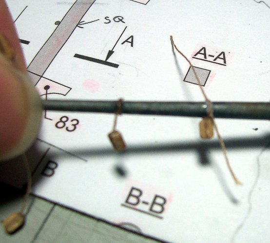

Here's one of the single blocks ready to be installed on a yard.

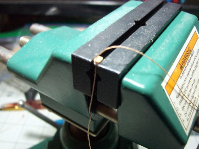

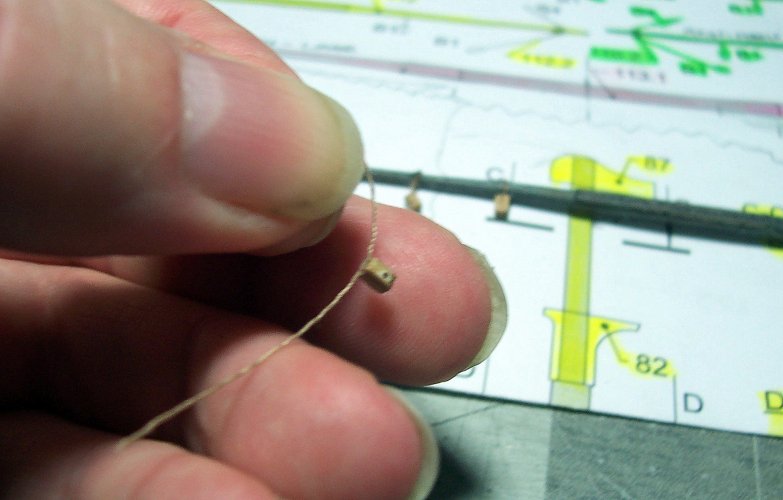

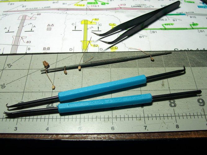

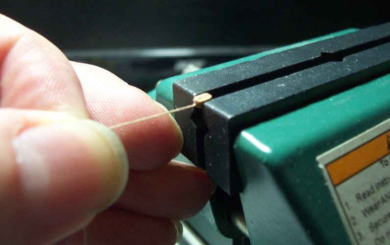

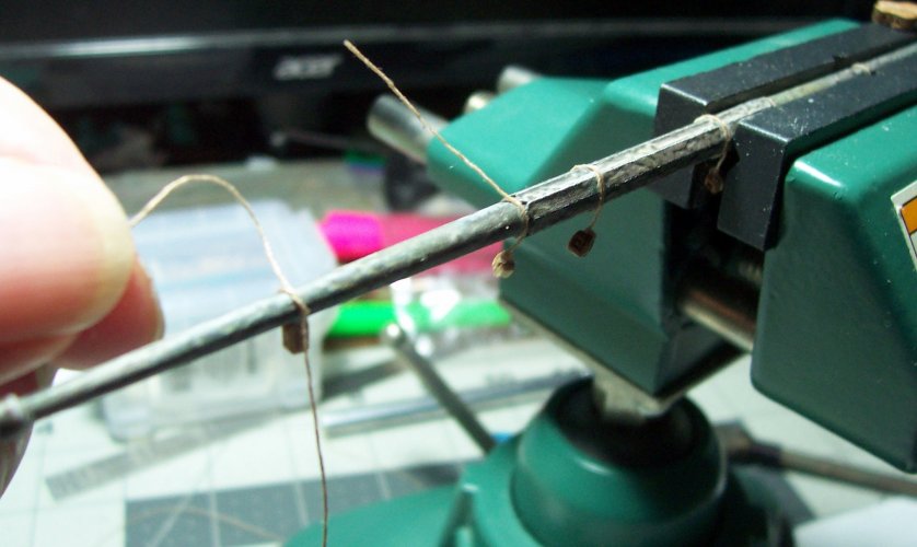

I found that gently holding the block in my ship vice works well for threading it. I always drill through the hole to make sure its clear of any wood shavings that makes it hard to thread the line. This is how I tie the line around the block. I pull it tight and use some CA glue to dap the joint. Then I trim off the one end.

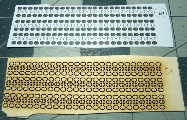

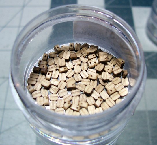

Here's my 2.5mm single oak wooden blocks to use on the yards according to the plans.

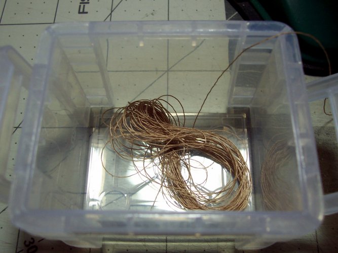

This is the rigging thread for the blocks. This is running rigging. In other words, it will not have been painted with the tar compound used on the standing rigging for other areas of the ship. It will be just bare rope, natural colored.

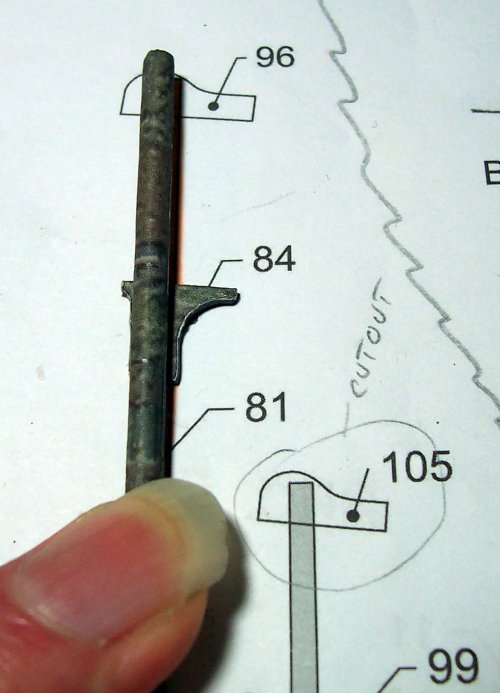

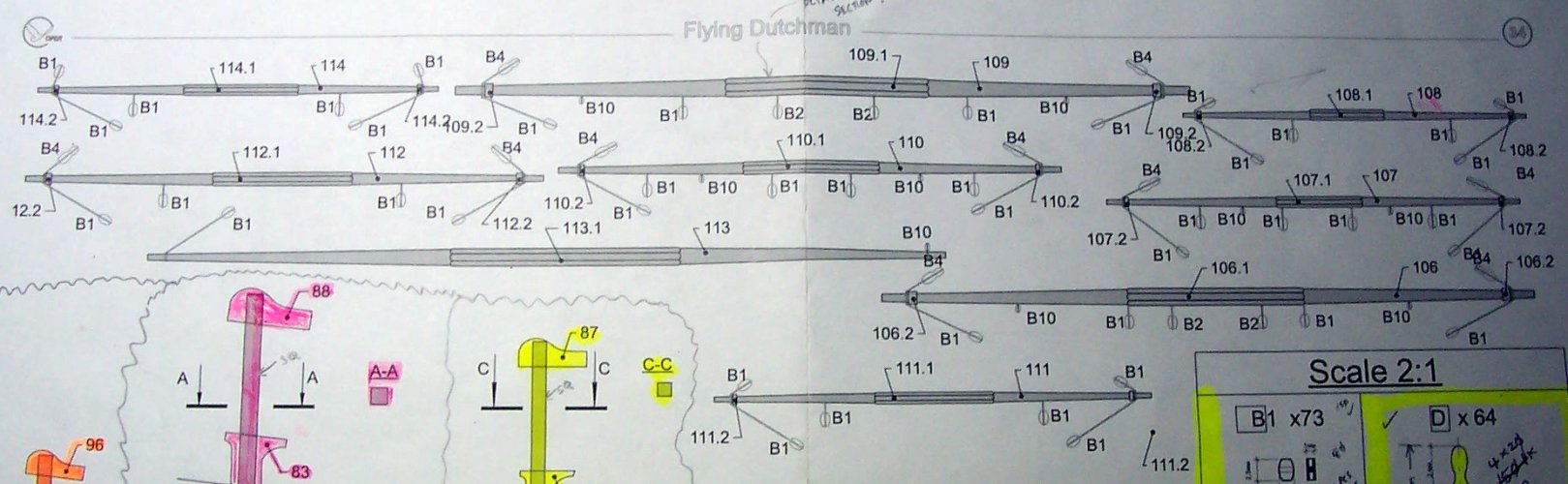

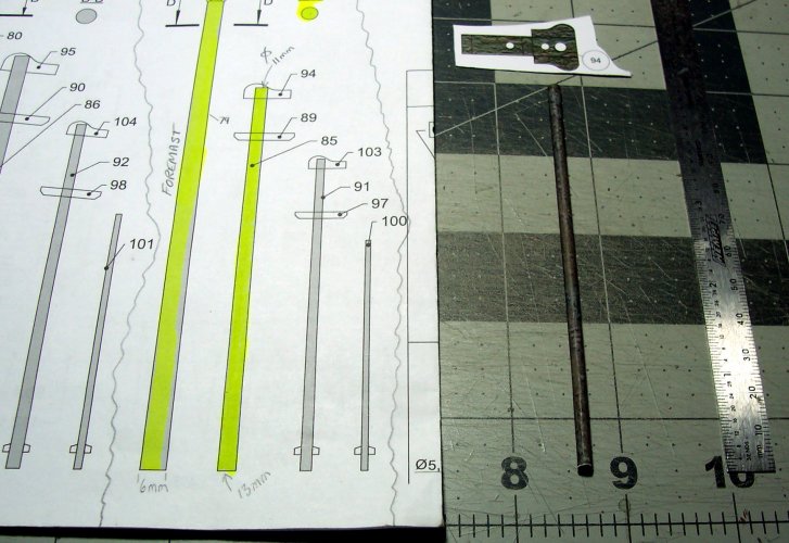

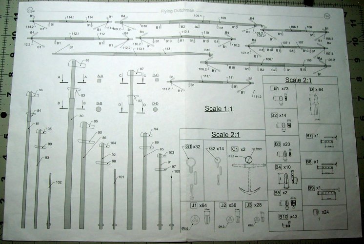

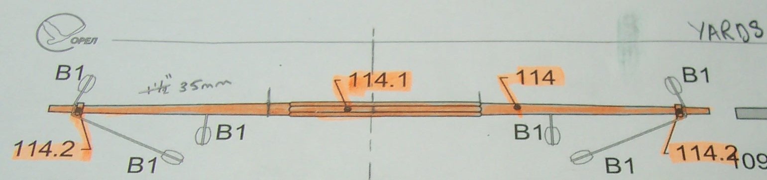

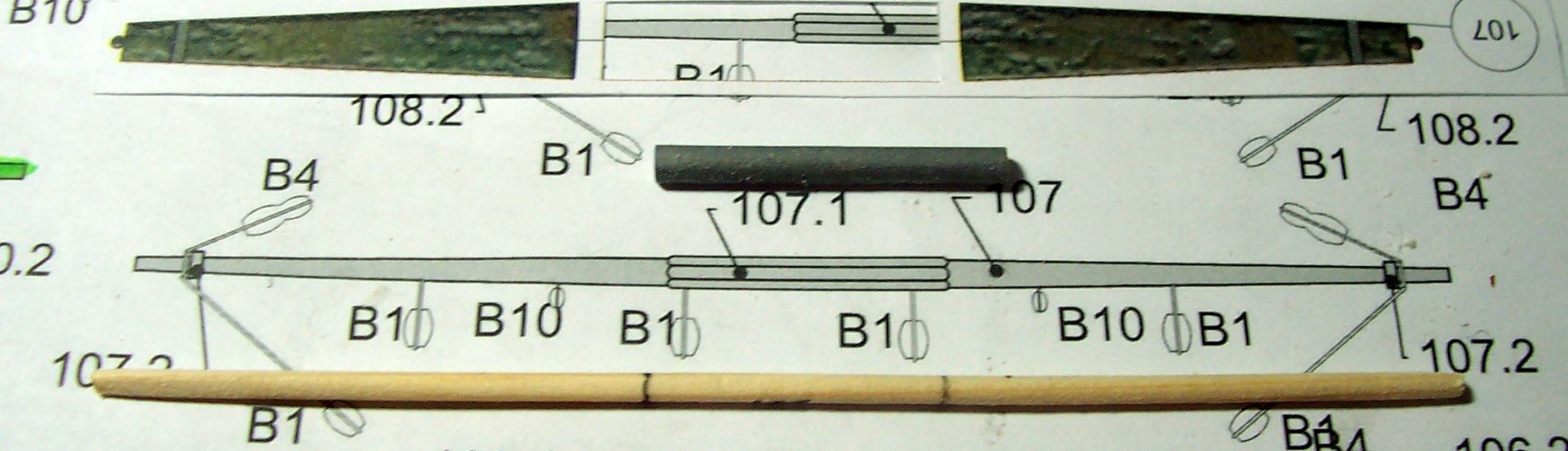

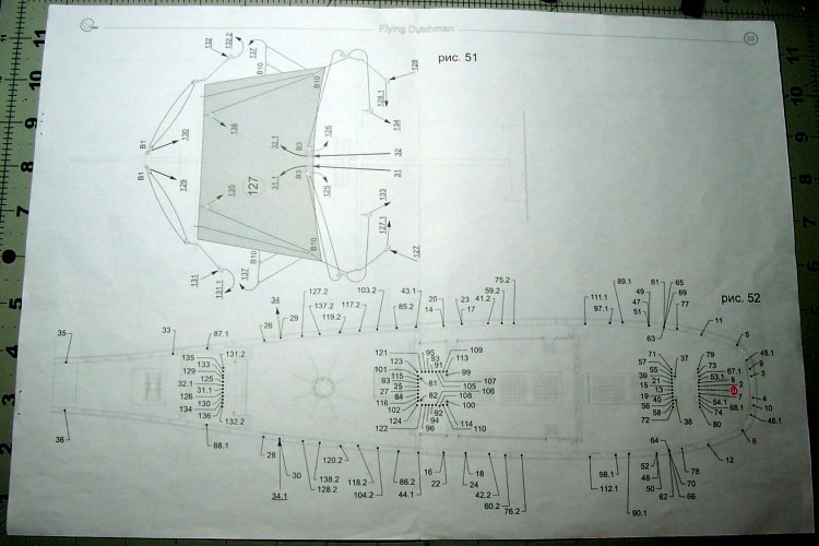

The plans indicate the correct sizes of the rigging needed.
On the far left of the yard, is a fiddle-block.
I bought a couple of ships model belaying tools (blue handles) to assist with the rigging process.

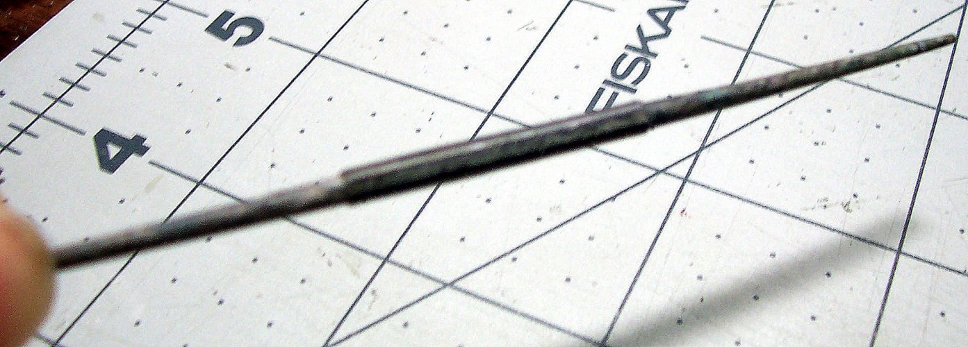

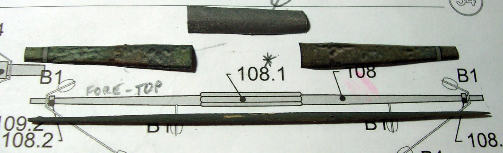

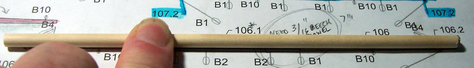

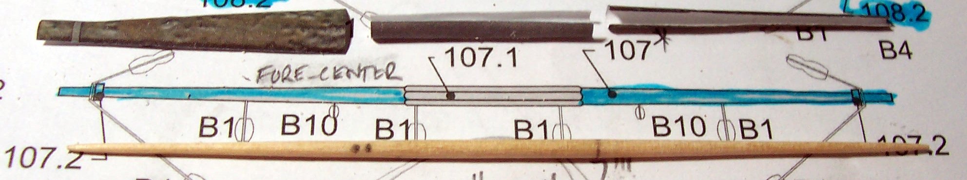

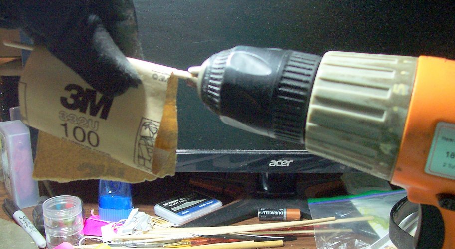

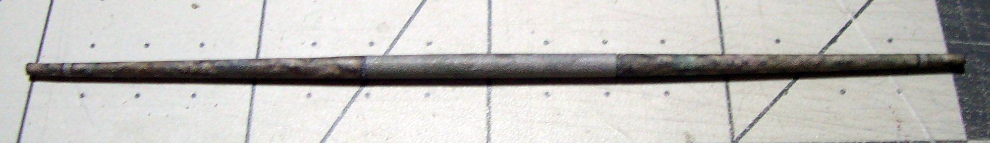

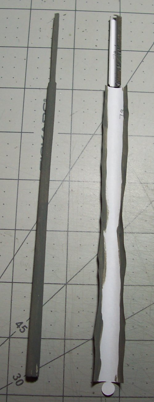

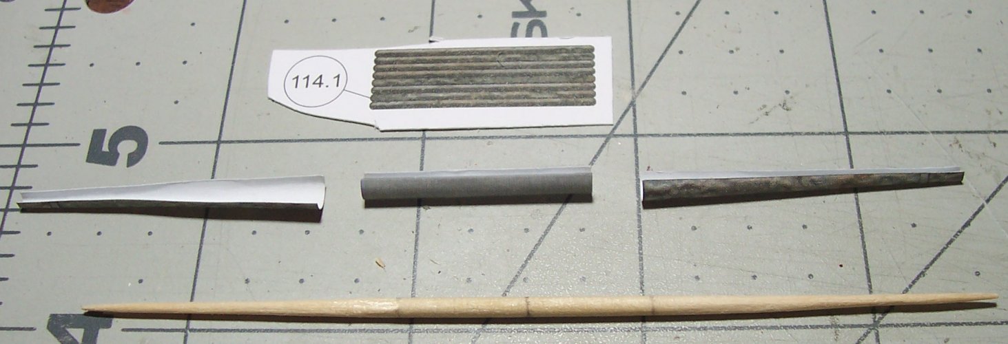

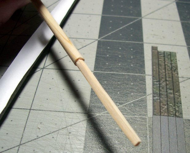

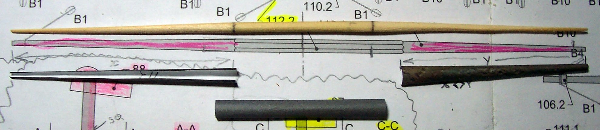

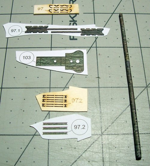

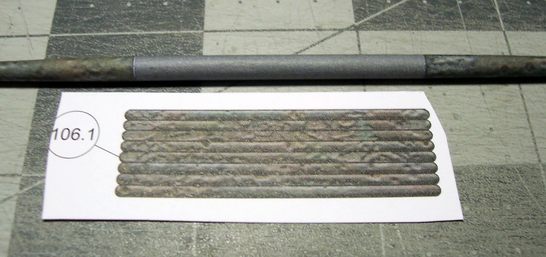

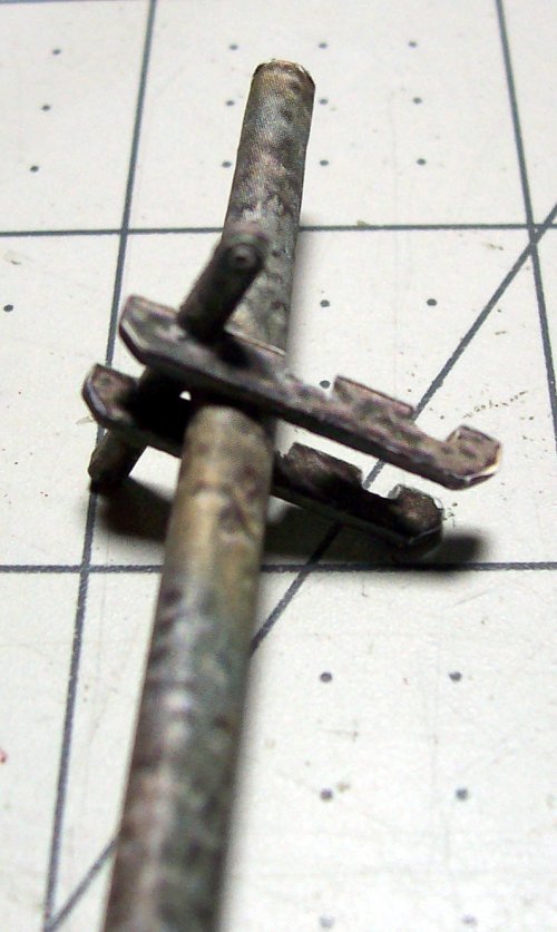

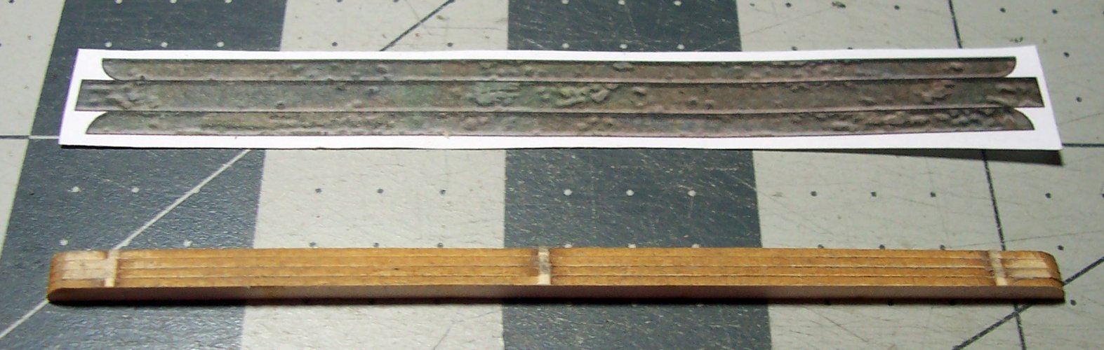

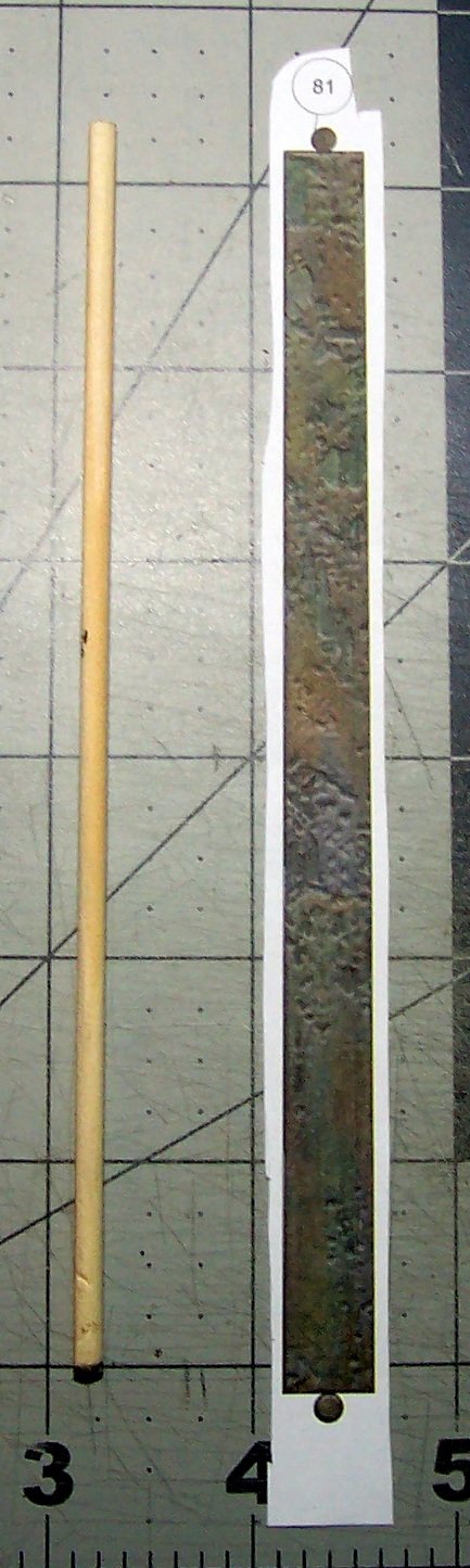

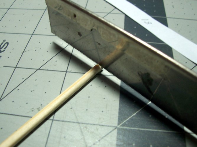

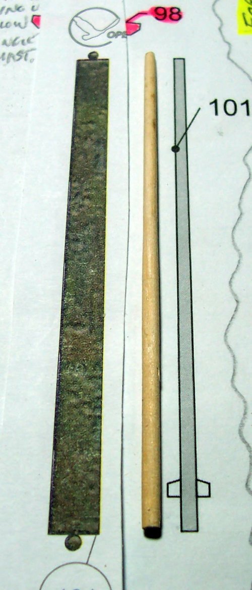

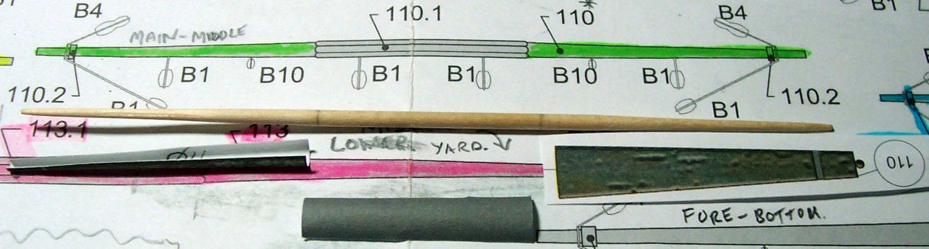

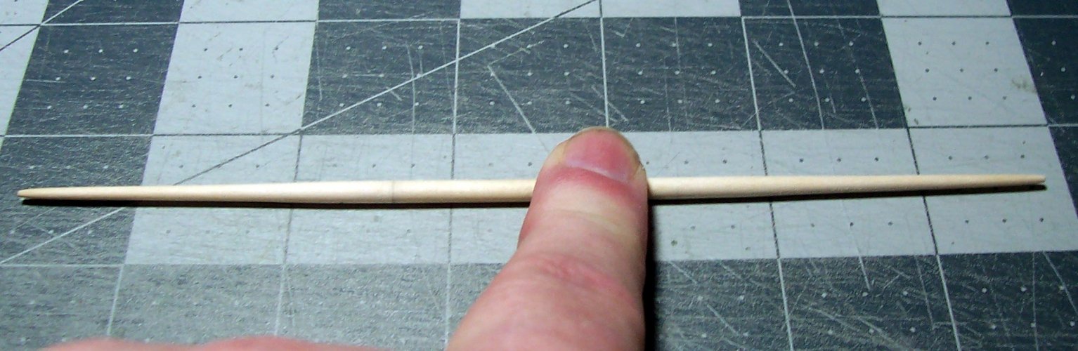

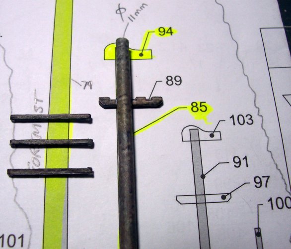

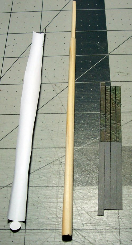

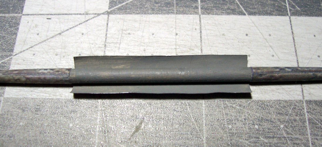

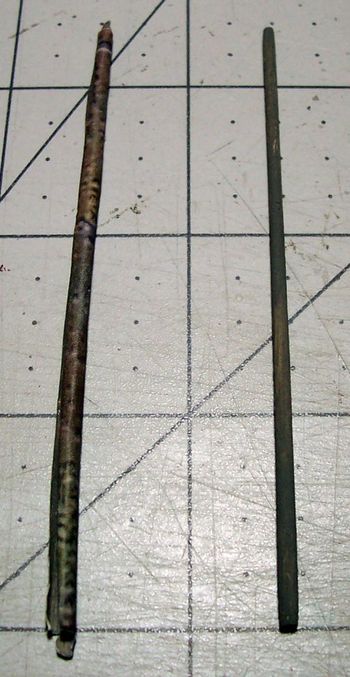

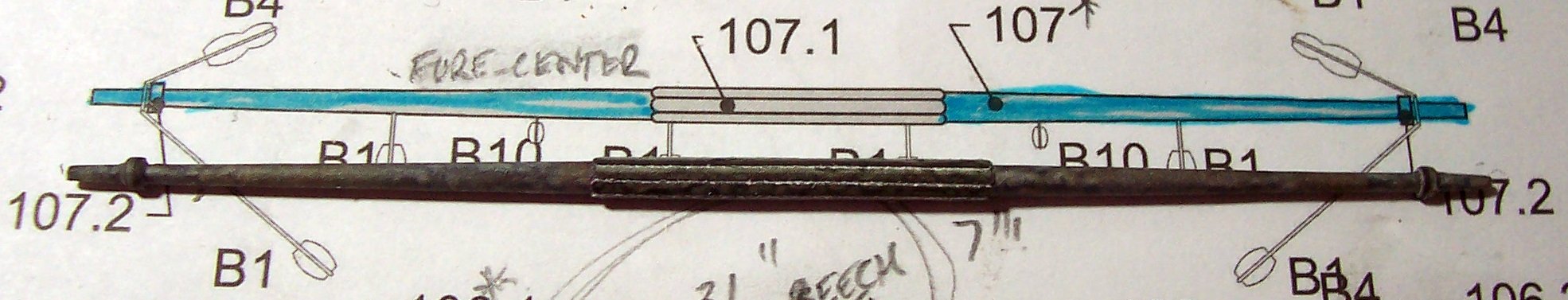

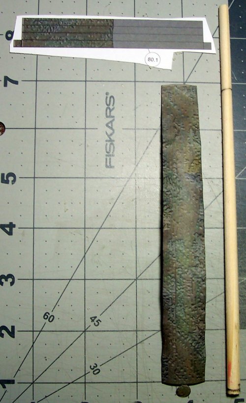

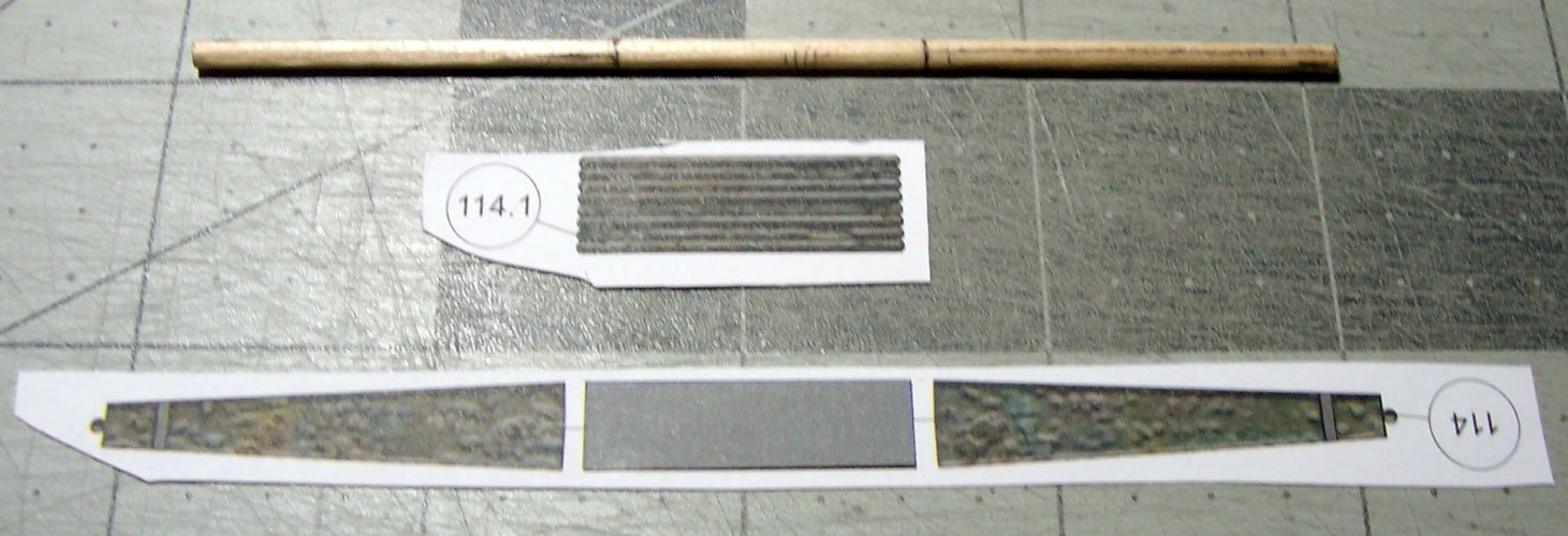

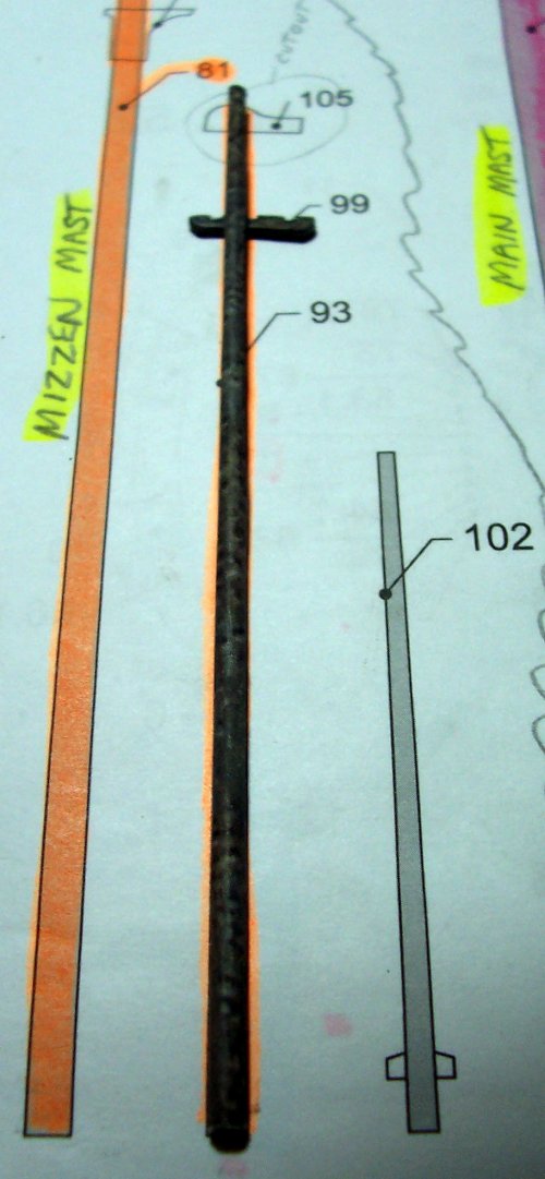

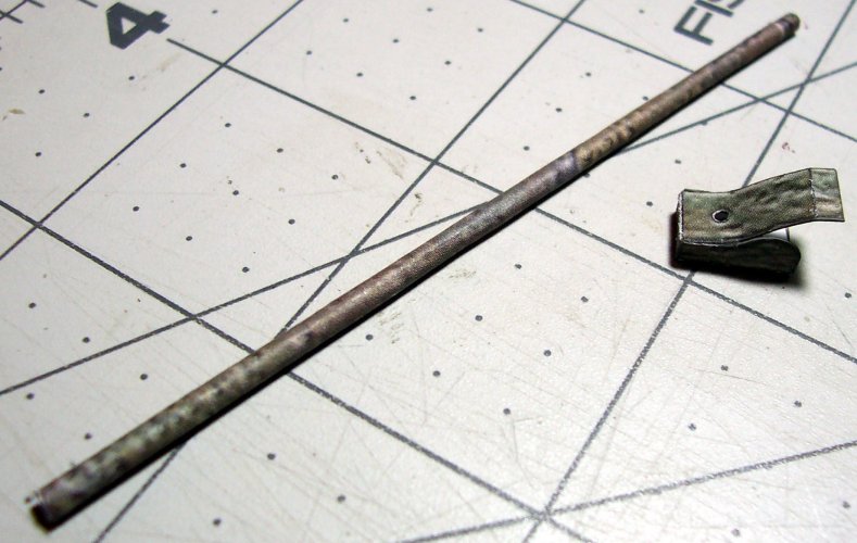

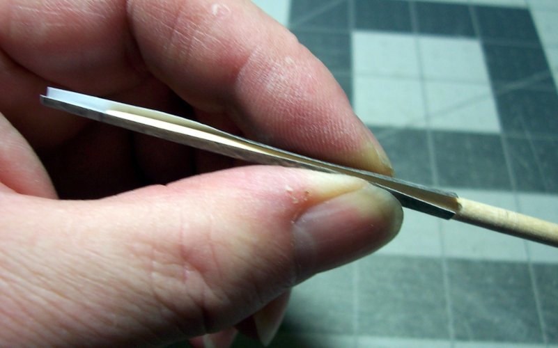

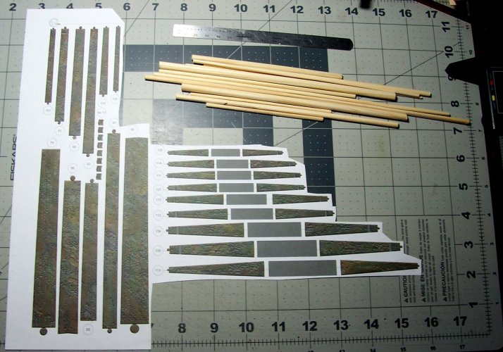

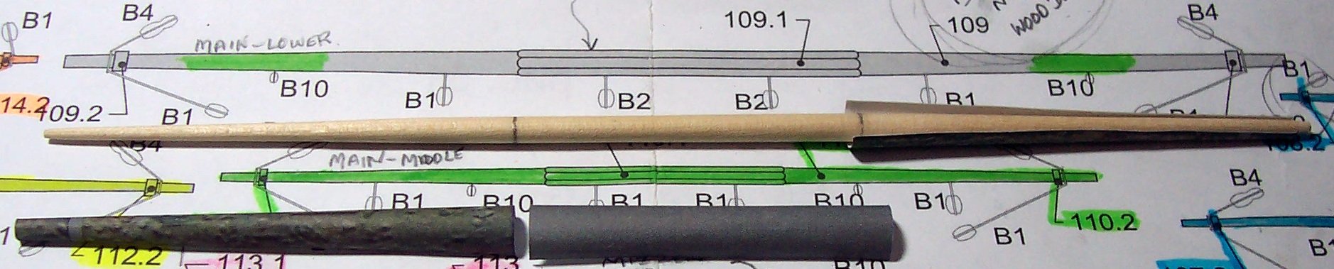

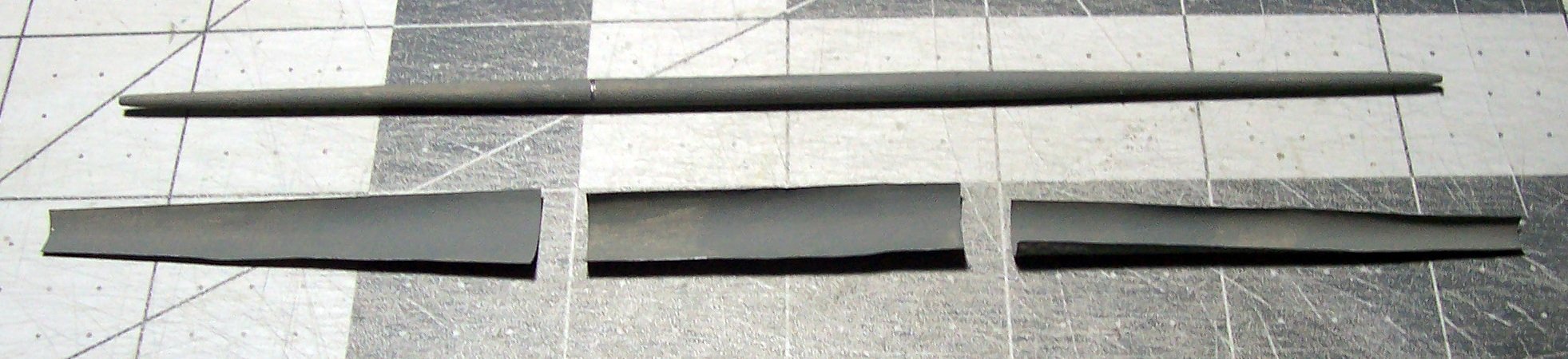

I found that rolling the spar on a flat surface is good for making sure it is nice and true.

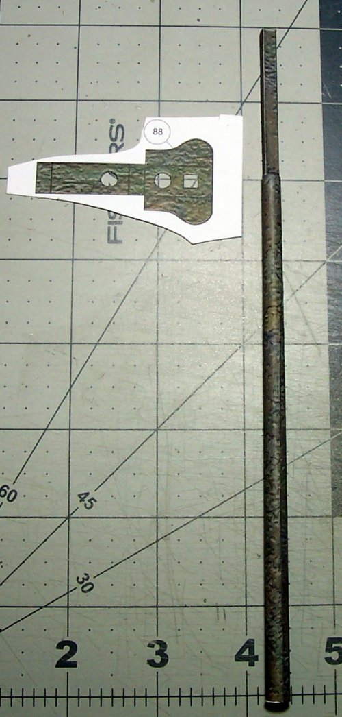

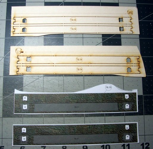

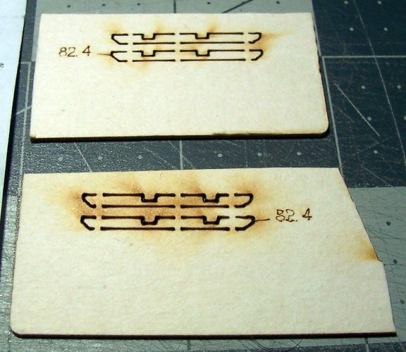

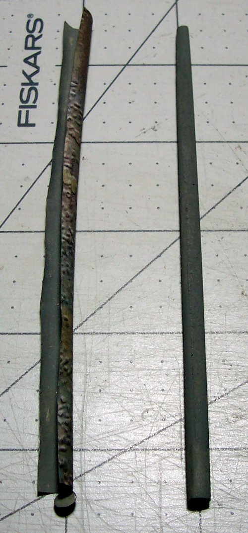

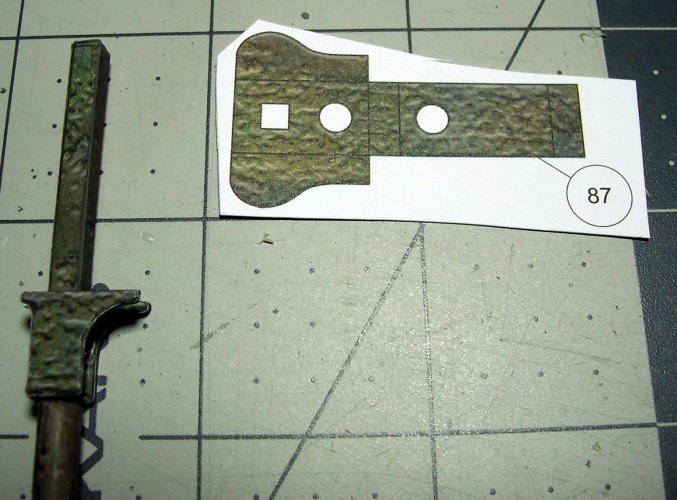

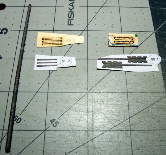

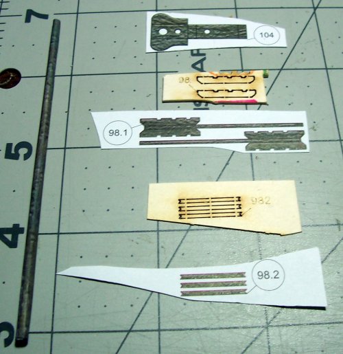

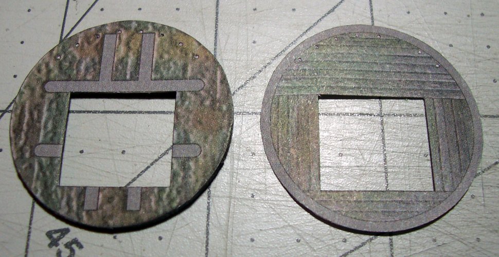

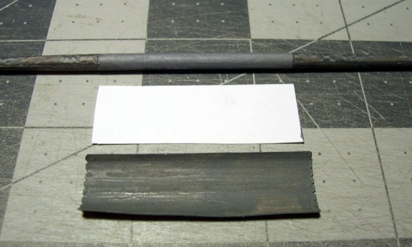

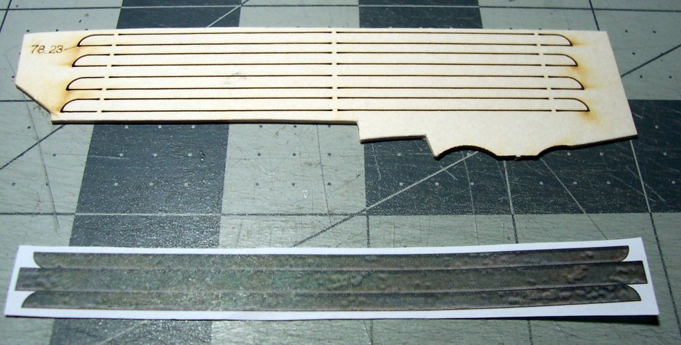

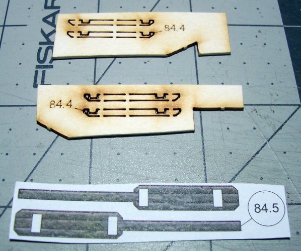

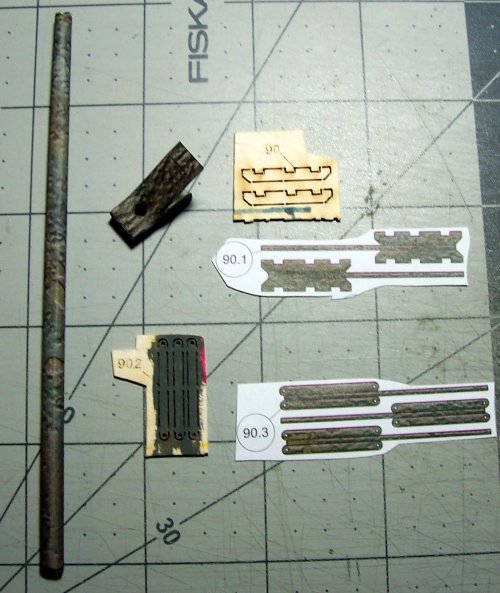

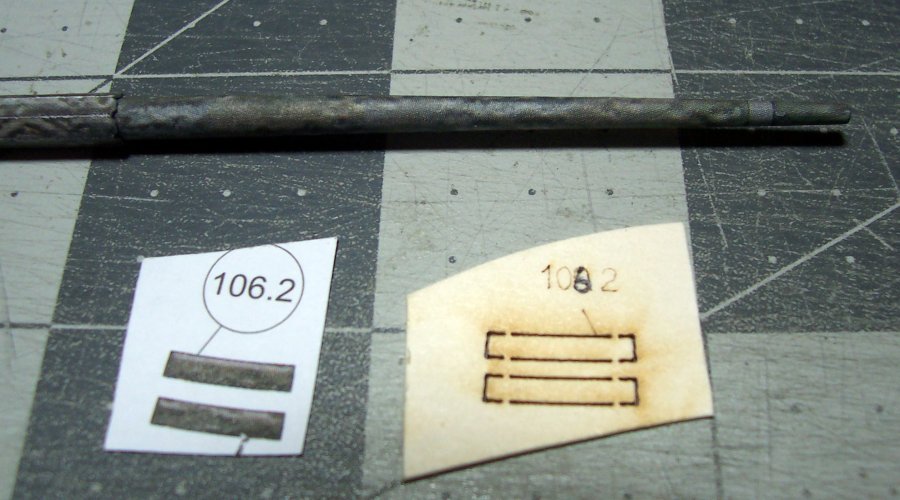

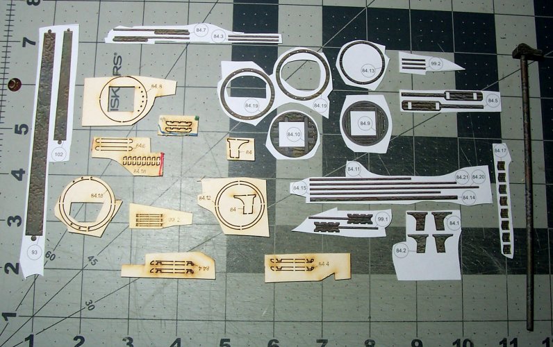

The color veneer parts help making sure that the correct shape has been ground into the dowel.
I paint the inside of the paper veneers, and the wooden spar to disguise any slight gaps that may show.

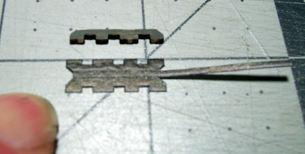

This here is a double-block. The block as it is, represents the real pulley block used on a ship. The rotating pulley inside the block is called a sheave. The blocks can either have a single, double, triple or so on set of sheaves depending on the application.
