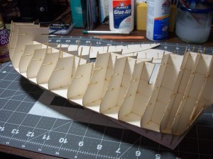

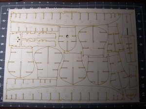

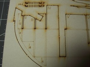

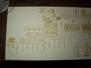

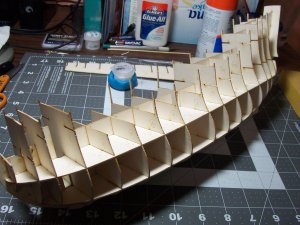

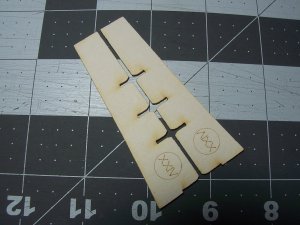

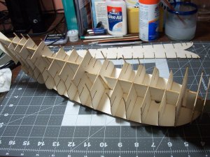

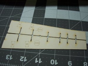

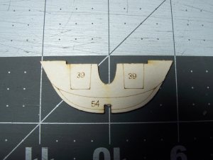

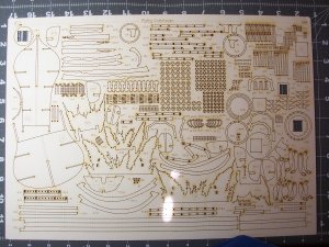

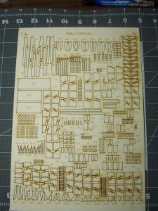

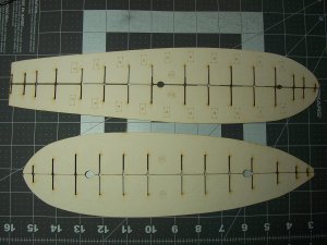

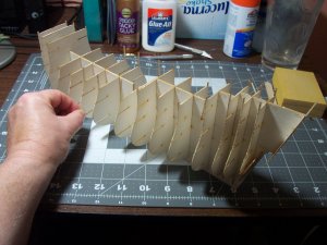

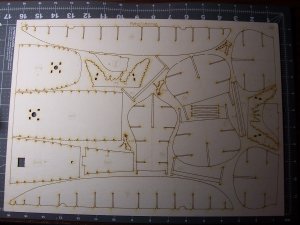

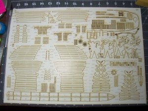

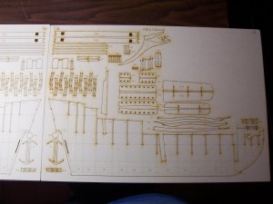

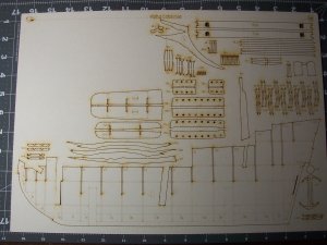

I am just in the early stages of the build right now. I have the main hull structure assembly with the bulkheads, and the keel in place. I am really glad I ordered the additional packages for the laser-cut parts as they are super-accurately cut out from different thicknesses of cardboard.
There are several thicknesses of the card needed for the structure of the ship. Without the laser-cut pieces its necessary to laminate the parts onto the card. Thicknesses of card are 2.00mm, 1.00mm and so on are needed.

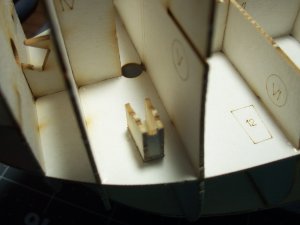

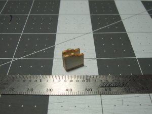

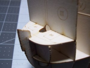

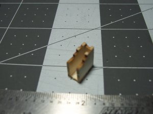

One of the lower deck ships cannon's. These are hidden eventually so they are simplified versions of the cannons on the other decks.

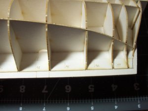

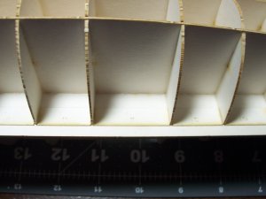

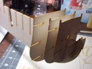

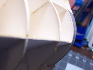

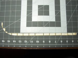

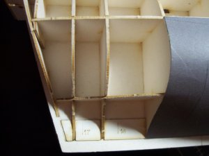

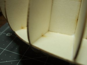

its very important to sand the edges of the lateral reinforcements (horizontals) to the correct angle to match the bulkheads to enable the panels to sit flat and not be distorted causing bumps and irregularities in the smooth shape.
The panels are a very good fit, if not a little challenging to make sure they are aligned properly.

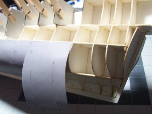

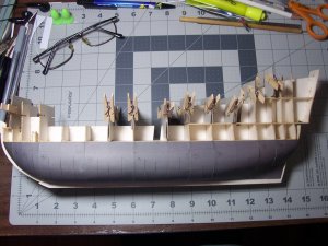

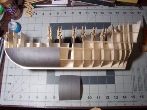

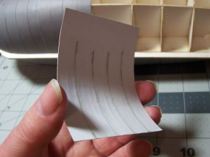

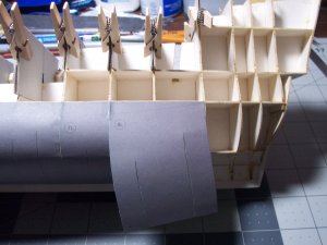

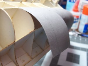

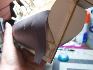

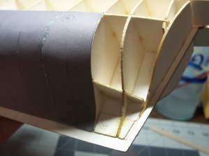

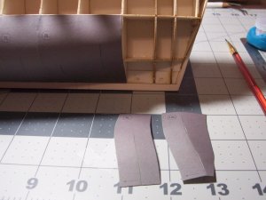

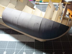

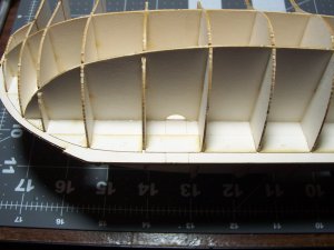

The panels don't require any water to get the shape I have found. I first butt-jointed the edges of the splices and held them with small pieces of Magic Tape. Then I applied some white glue to the seams. After they dried, I used my finger nail to flatten the joint nice and flat and smooth. Gluing the panel, I started at the top of the panel just about 3/8" section glued in place. I then waited for that to dry, and then pasted the remaining piece of the panel. The paper thickness seems perfectly matched to the task and doesn't get sogged out with the glue keeping its shape really nicely. I found that so long as I pre-shaped the panel as best as possible firstly, it would fit pretty much perfectly. I just completed one side at a time starting a 1P thru 10P, and then 1L thru 10L. Note that P is right and L is left I found out.

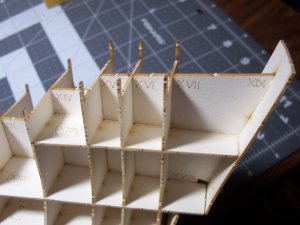

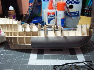

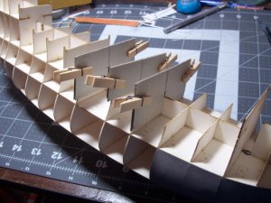

IMPORTANT: There are delicate vertical protrusions on some of the bulkheads that eventually support the decking. I found that these get bent up pretty easily while working on the panels and adding the cannons and so on. I was horrified to see that one of them was almost flattened :eek: Anyway, I suggest using some scrap card to create some protective supports to help avoid damage. The small clothes-pins are from Walmart and work great for the temporary supports. I also painted on some super-glue to strengthen the pieces a bit.

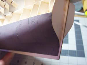

Panels completed!! Ah, time for a cup of coffee to celebrate! Sanding the edges of the flat lateral supports is very important to ensure a nice surface for gluing the panels. On a wooden ship, I think we would use a spokeshave to smooth the edges of the wood to the right angle. In the case here I found a small 3M soft sanding block 320F worked good and a fingernail file/sanding stick. Just be careful not to overdo it! Only remove the absolute least material to get the smooth edge. Its easy to gouge the card unintentionally.
