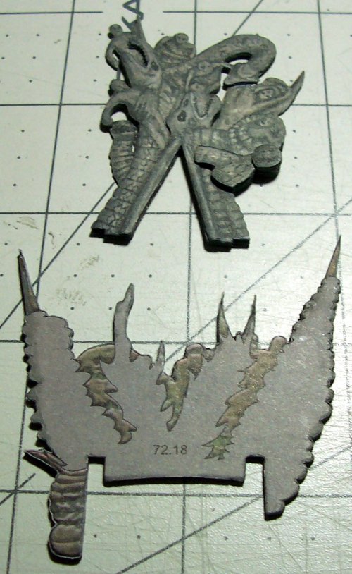

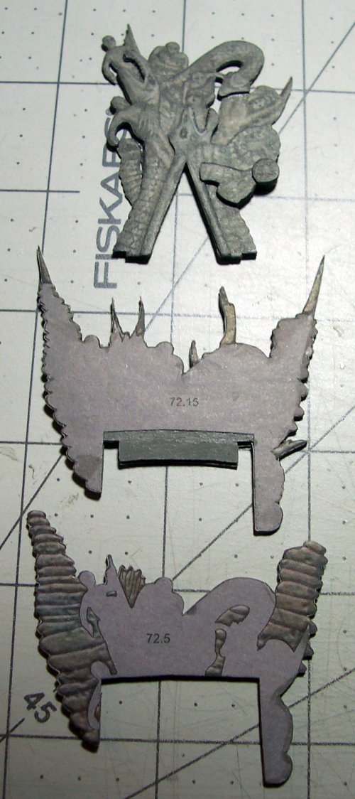

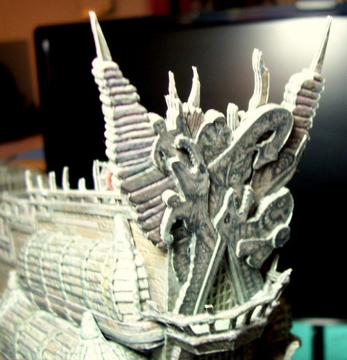

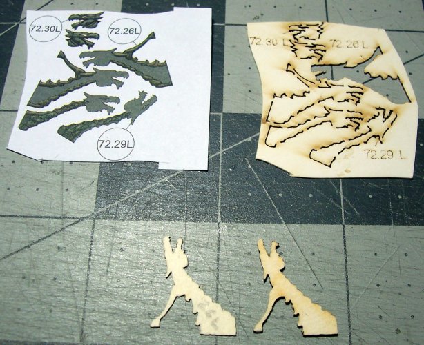

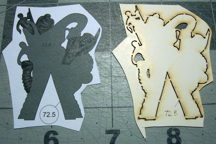

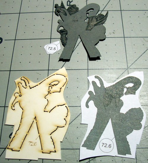

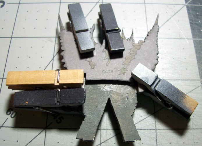

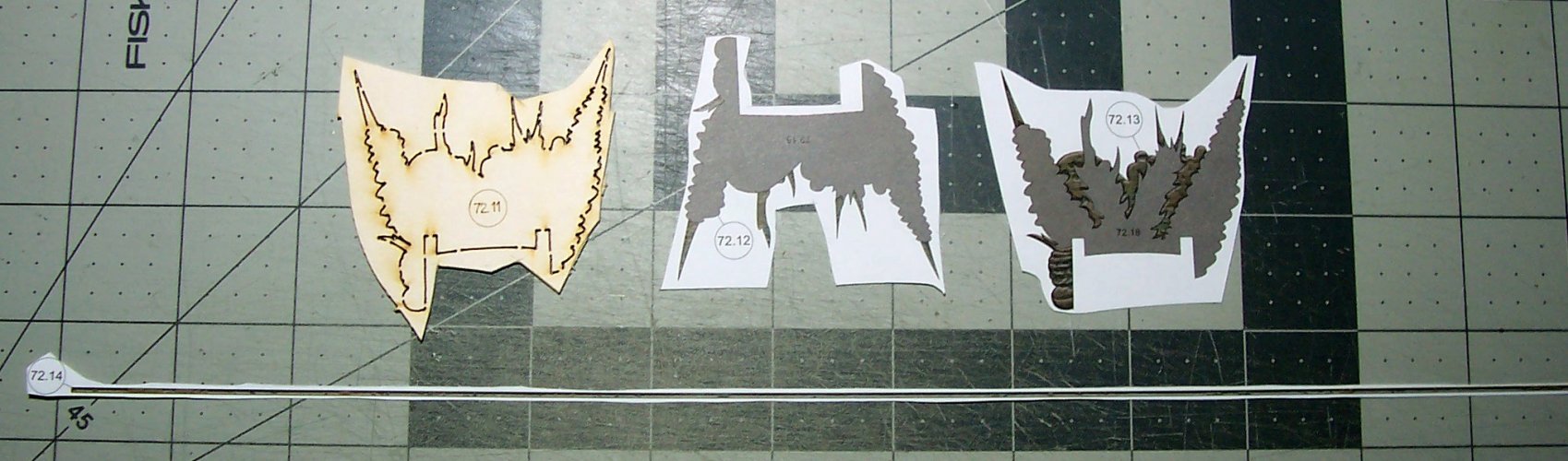

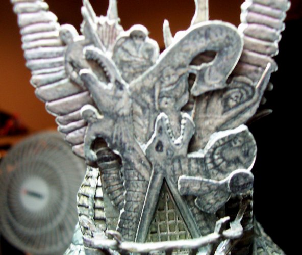

So, here are the lantern brackets that attach the lanterns to the transom. Such lovely detail!

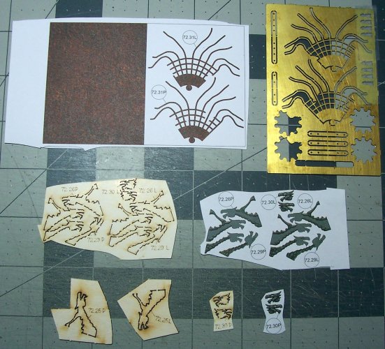

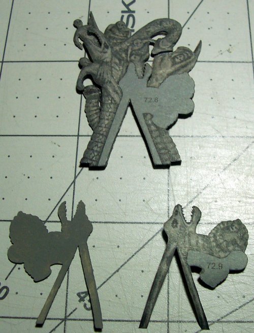

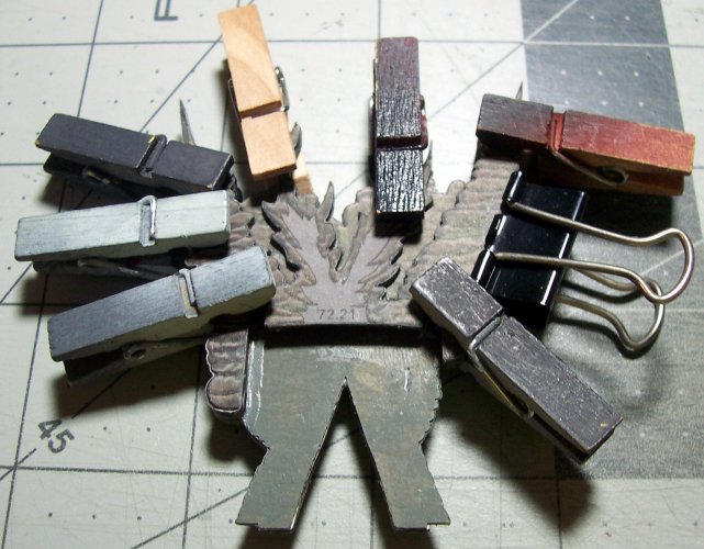

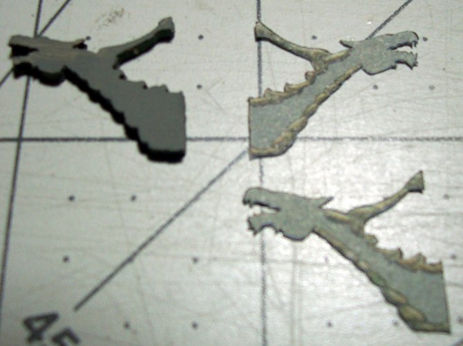

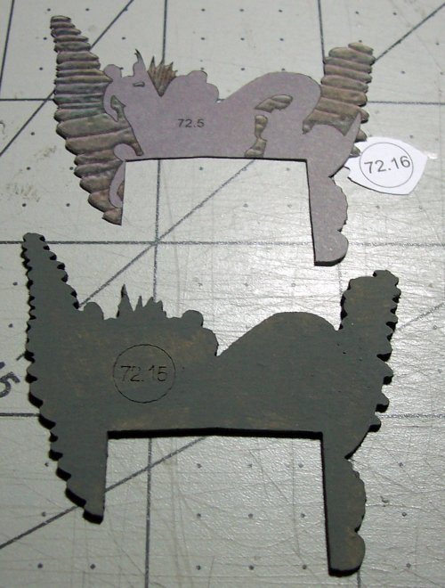

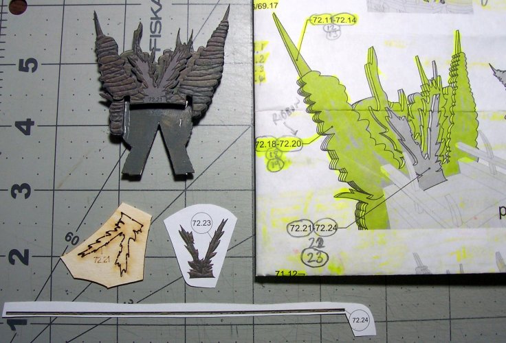

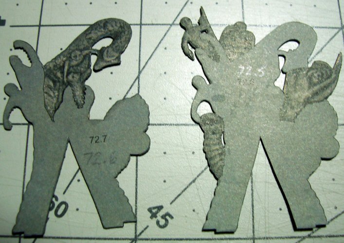

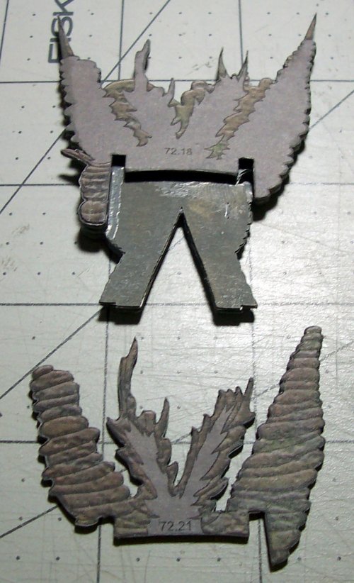

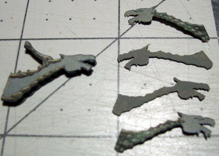

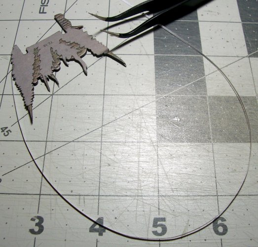

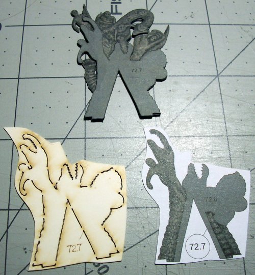

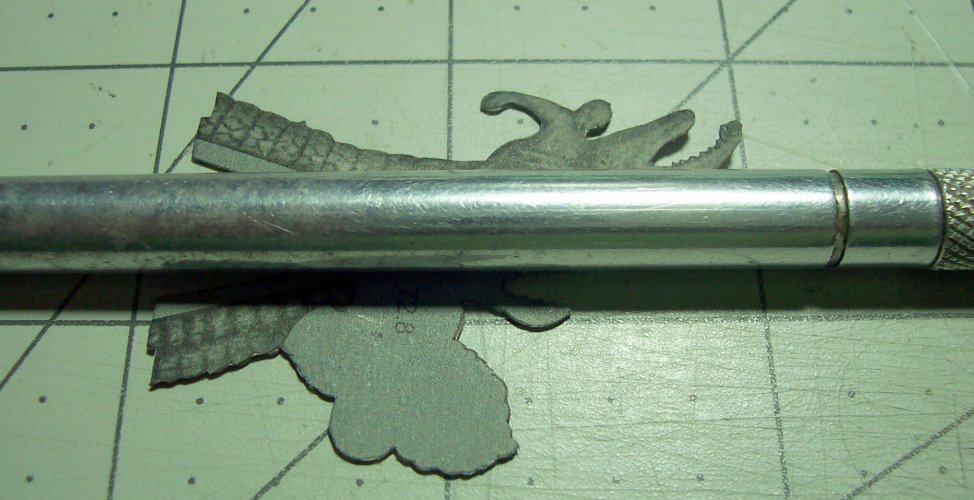

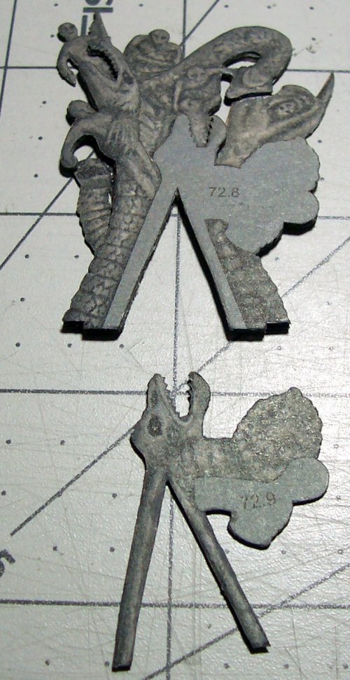

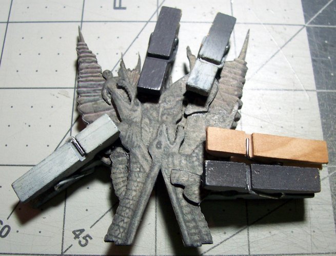

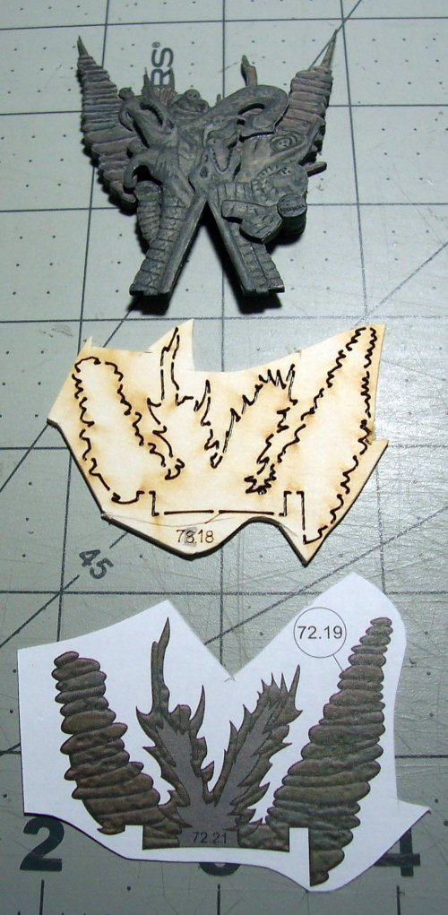

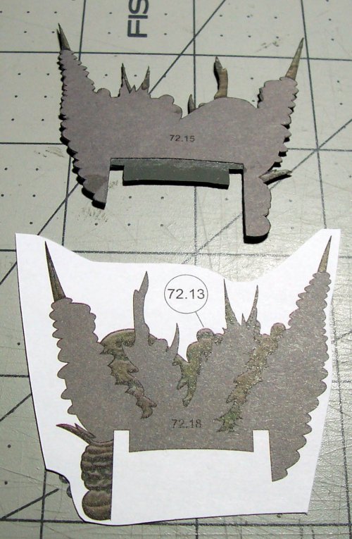

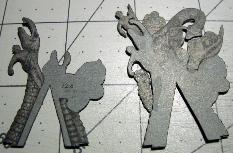

The layers provide the details to the dragon lamps bases.

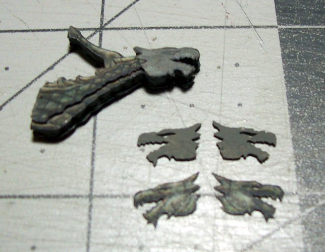

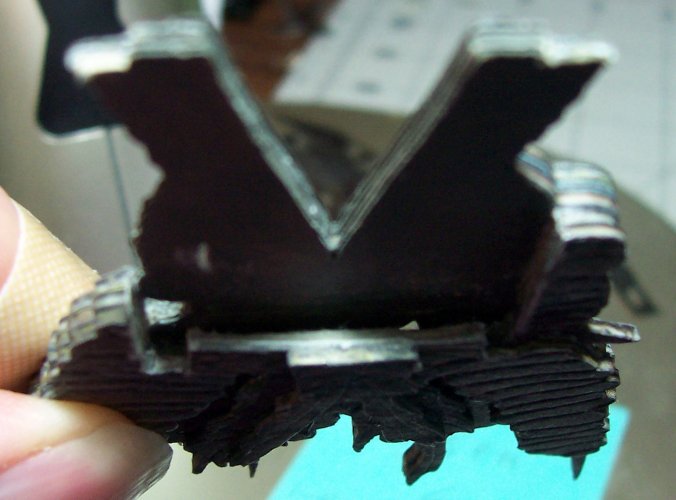

The final layer for the dragon's face is ready to be added.

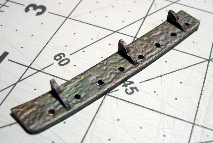

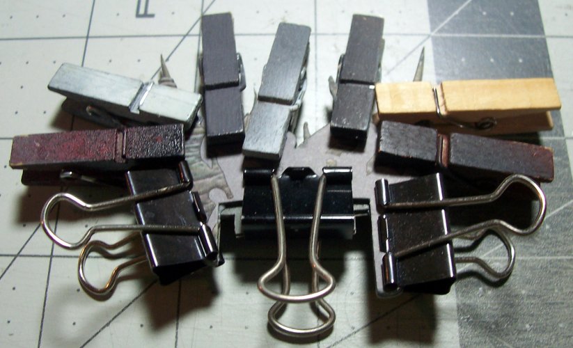

There is a ribbon of color veneer that needs to be glued to the edge of the base. I added some additional custom pieces to make sure it looked consistent

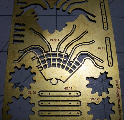

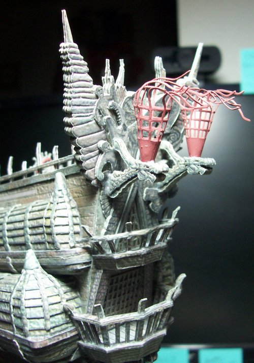

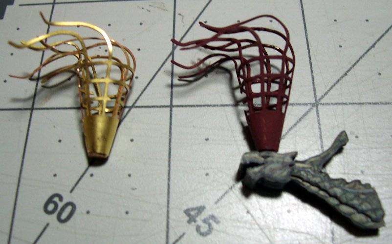

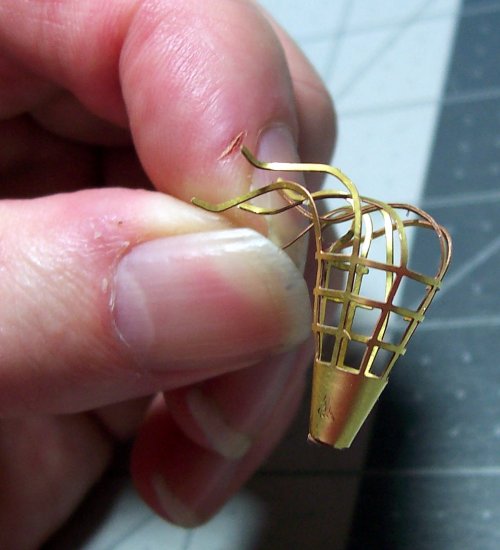

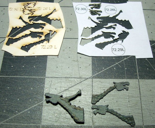

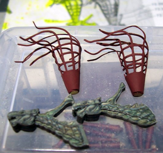

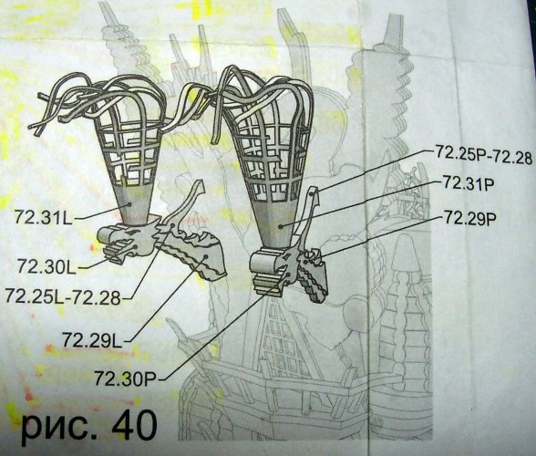

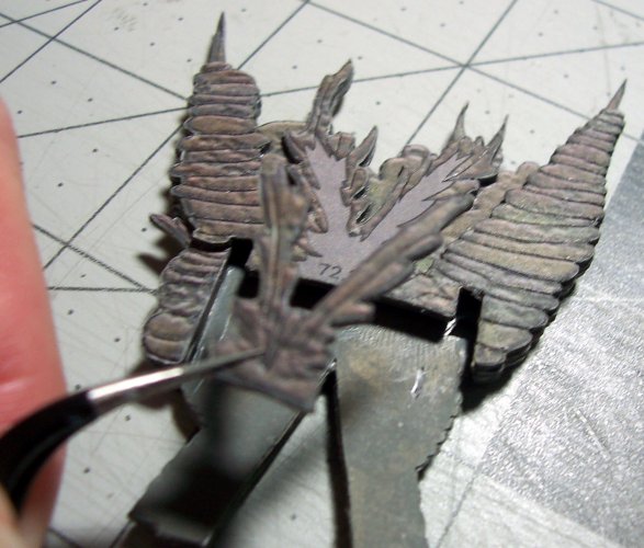

This was the part that I was really looking forward to! This is the reason I wanted the brass etched add-on too. The paper version supplied with the kit is okay, but its a bit too flimsy and doesn't hold the shape for the lamp fronds at the top that need to be bent into chaotic poses. So we have 72.31P and 72.31L accordingly.

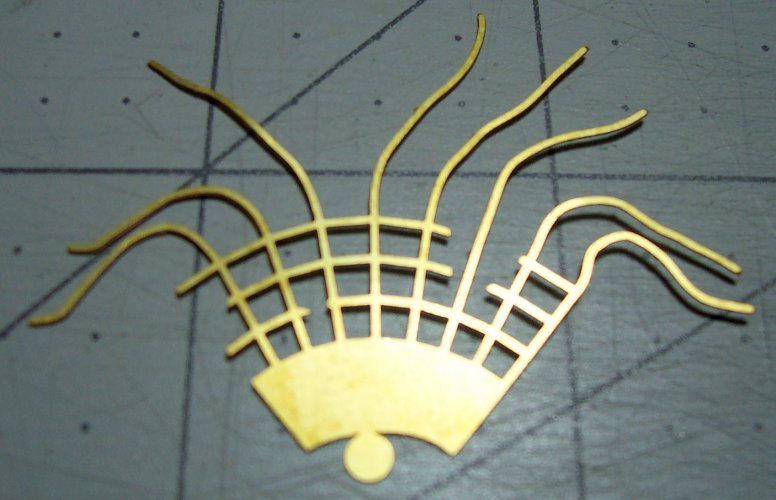

I used several of my old blades to chop these guys out. Just put the brass over a hard metal surface and cut straight down to separate each node from the sheet. I did clean them up where needed with a needle-file.
I used some long nosed pliers and gently curved the lamp taking it really steady. Just a bit of curve at a time. Before you know it, its fully round. Just butt the flat sides to one another. There's no need for glue or solder to hold these together. I just flapped up the small round base so its flush with the cone shaped base edge. Both the L and R parts are different, which is very cool! Next, spend some time getting the thin, "fronds" on the top of the lanterns to get a nice effect. This is important, so don't just bend them a bit, and we are done stuff
The reason the brass version is better is because the thin-bits hold their shape! Try not to have any of them touch each other at least!
I just painted them the same color as the paper parts. There are lots of edges and surfaces that are obscured, but hey, its all good fun

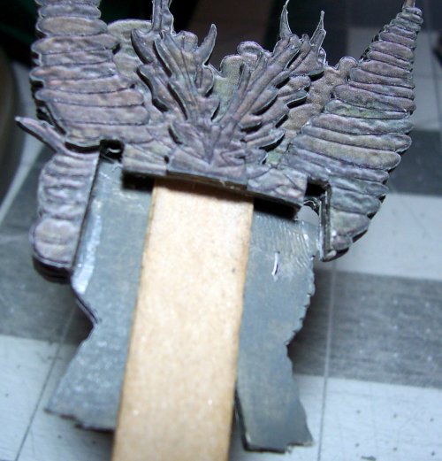

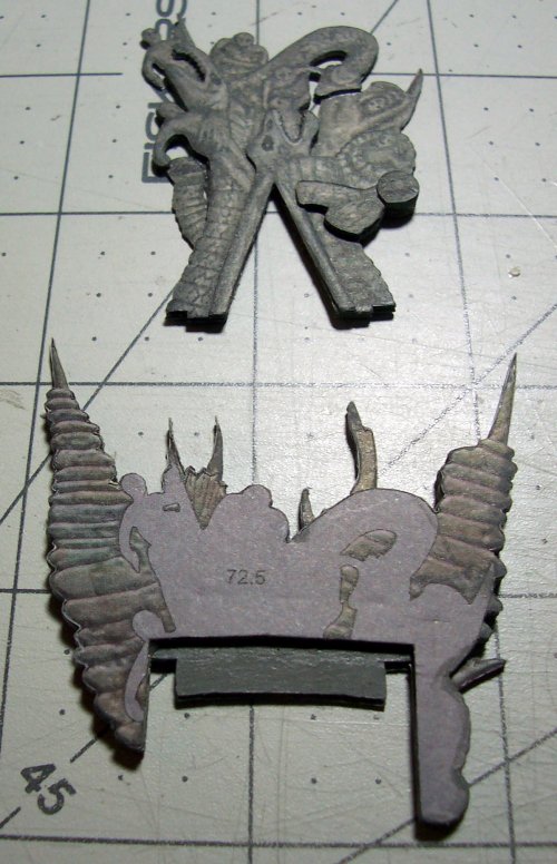

There are the brackets too, all ready to be mounted to the stern.
Okay, this looks like where they will need to go on the stern of the ship. You have to measure it yourself as there are no markings to guide their placements.
Be aware that the bases will be located on different heights on the stern decoration. I adjusted the base of the each bracket with a little packing to get them balanced as perfectly as possible. they have to be looking downwards just a bit.
There we go! The ship's lanterns are in place. Because the lanterns are brass, you might want to use a stronger type of glue? I used Formula 500 Canopy Glue. It basically sticks anything to anything. I would prefer though just to knock the lantern off the base if they got bumped and not destroy anything if super-glue or epoxy was used.

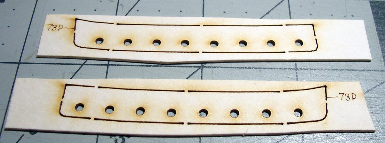

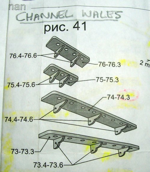

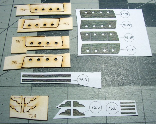

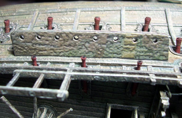

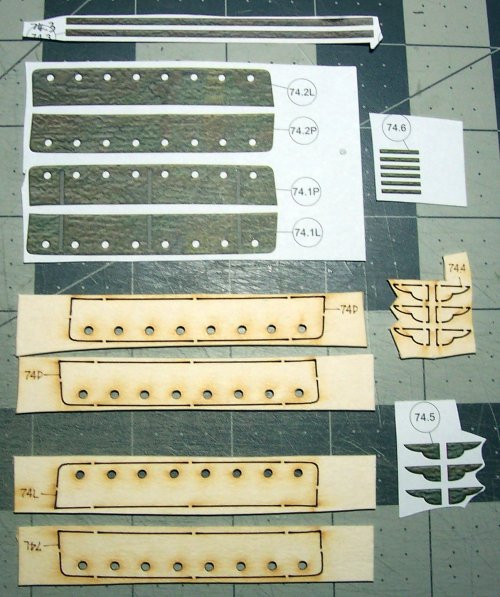

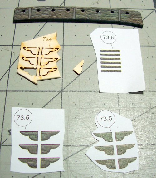

Channel Wales

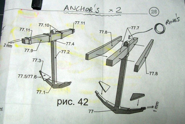

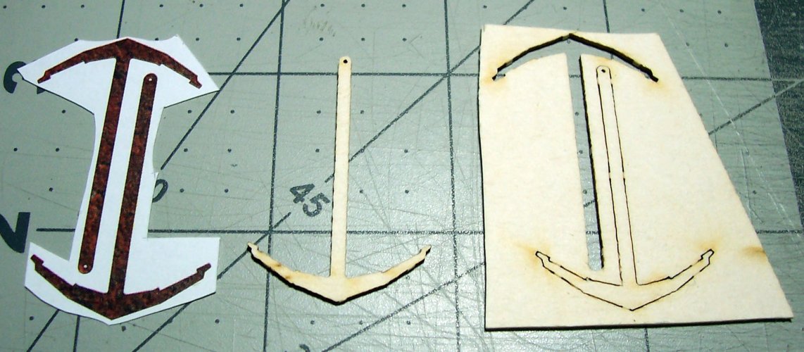

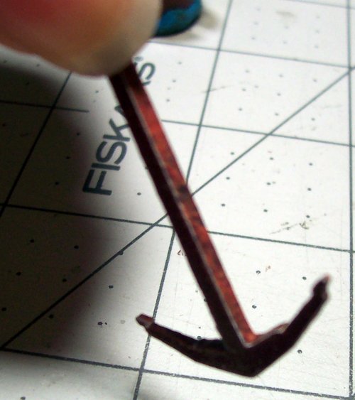

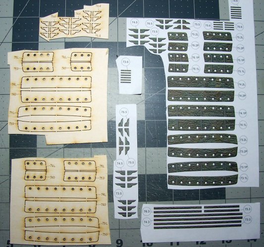

If you don't know what a channel wale is all about, they support the bases of the rat lines on each side of the ship. This is the diagram of the sub-project in Pic 41 below.

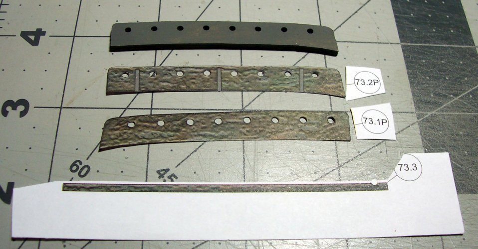

These are all of the parts laid out for the channel wales. There is a lot of work just with these!
The holes for the fittings are very nice and true in these laser-etched pieces parts 73.x

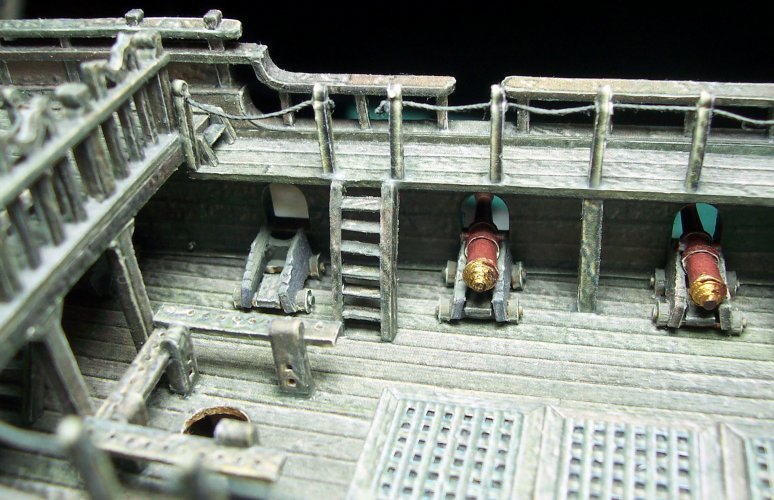

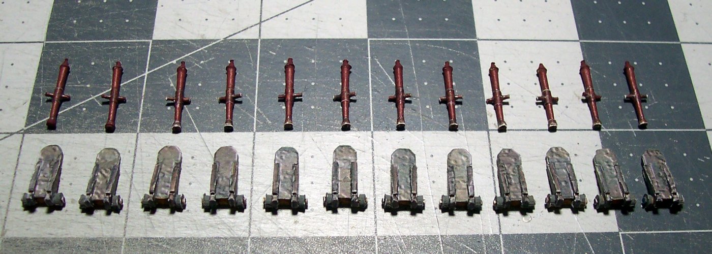

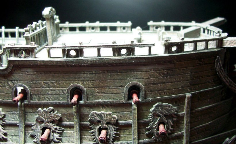

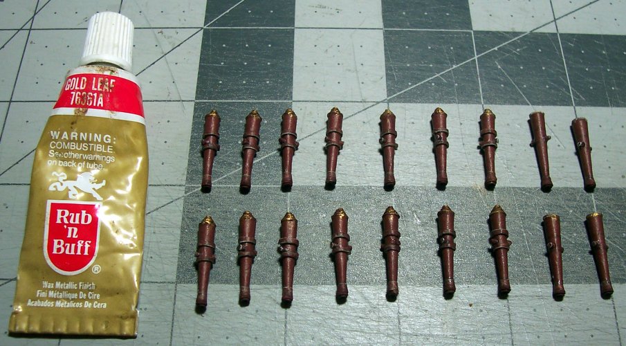

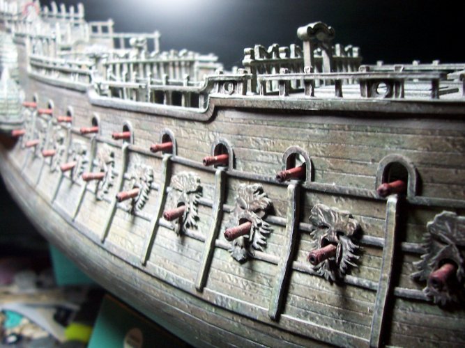

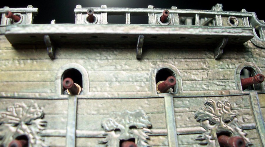

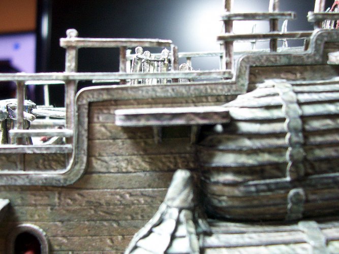

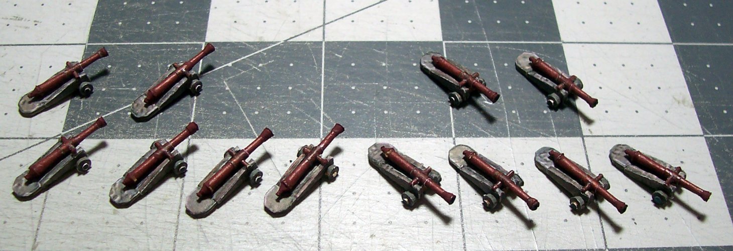

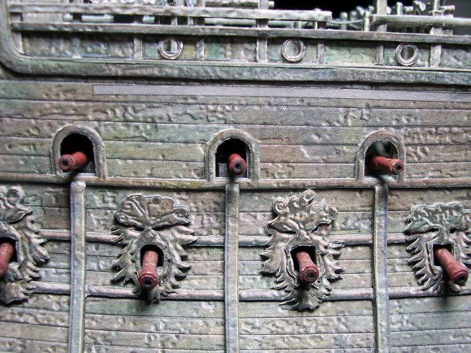

Hold your horses! Time to break-off to fit the remainder of the cannon barrels. I thought I would experiment with using some Rub'N'Buff on the rear of the cannon barrels, but later I painted it over after deciding it was too jarring.
Nope, didn't like them with the gold! Looks too new and nice, time to just paint over them. The cannons themselves look great! Its really good that all these are included with the kit.

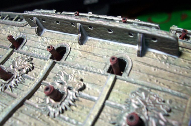

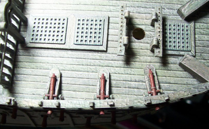

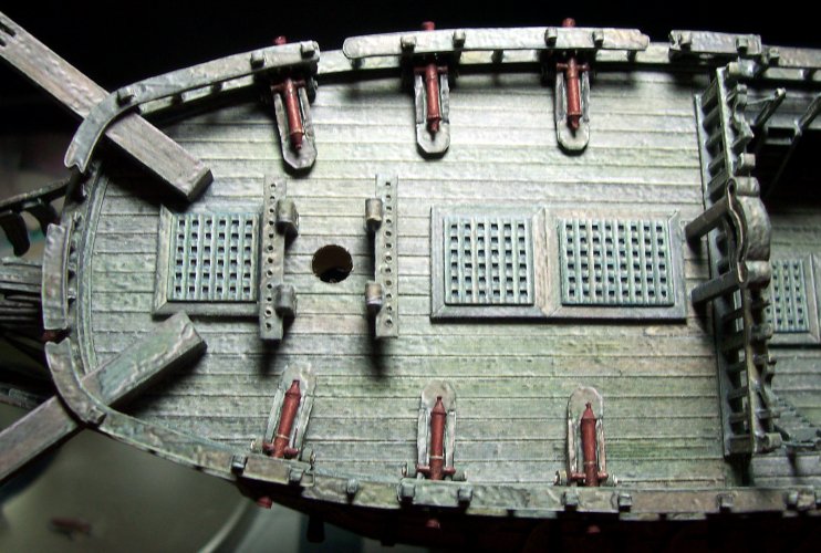

There we go! The middle row of cannon barrels are new, and have been installed now because there is no chance of them being bent and damaged any longer. That part of the ships build has been completed. Also, if we waited until the channel wales had all been fitted, it would have made installing the remaining cannon barrels more of a task.
Just the complete cannons need to be fitted on the top deck.

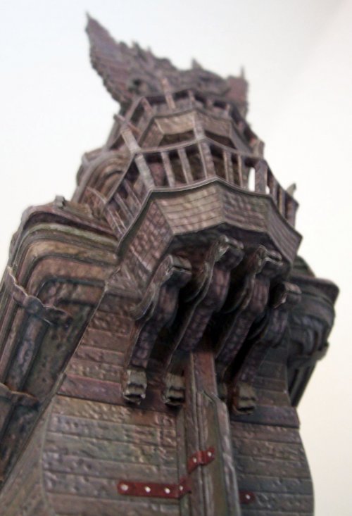

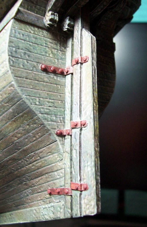

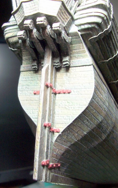

I really hated seeing the small white circles marked for the fixings for the rudder hinges so I fitted some bolts/pins in each of those spots. I then painted each of the heads of the pins so they are consistent with the ship. I'm quite pleased with the results.
