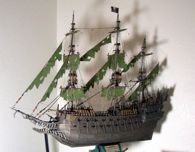

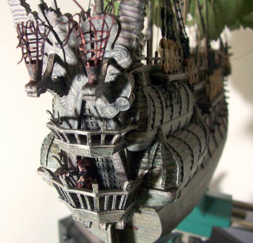

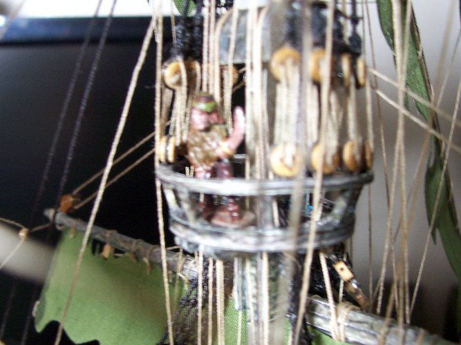

These are just a few development shots of the finished ship.
I will take some beauty shots and add them here as soon as I can. Thank you all for commenting and supporting the build :toast::toast::toast::toast::toast::toast::toast::toast::toast::toast::toast::toast::toast::toast::toast::toast::toast::toast::toast::toast::)

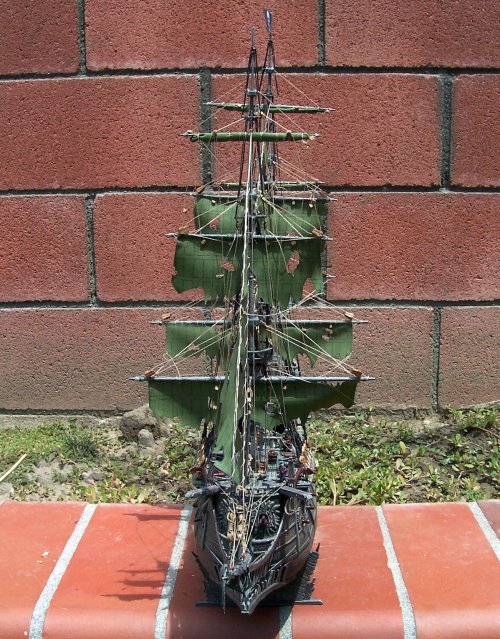

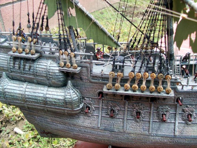

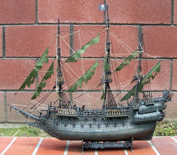

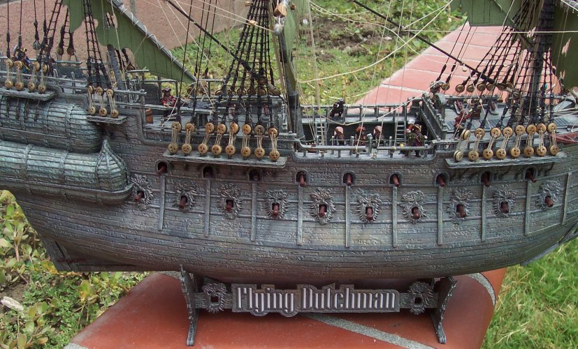

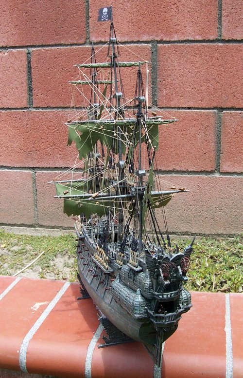

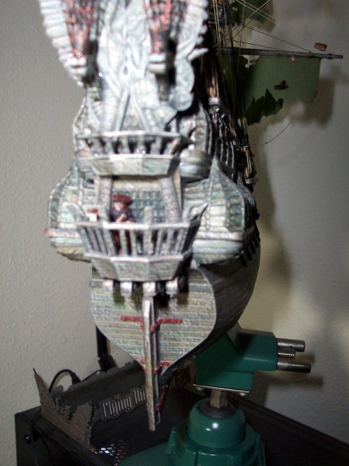

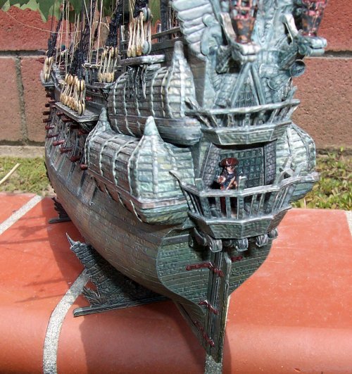

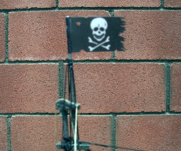

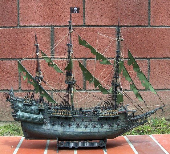

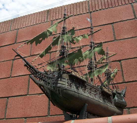

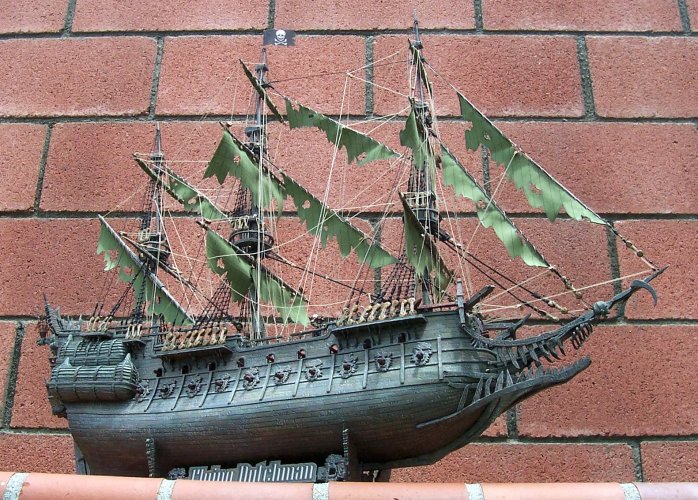

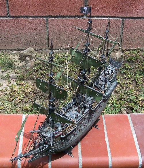

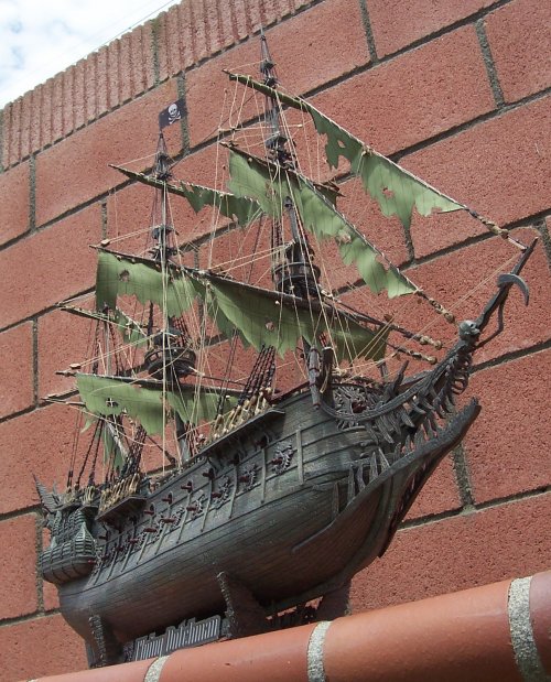

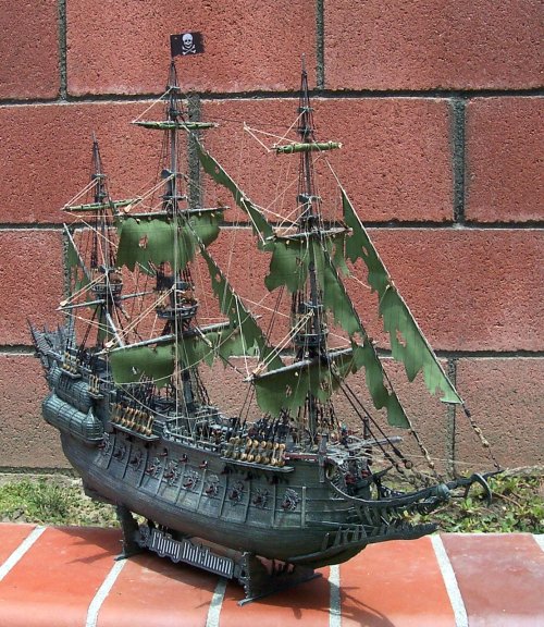

So, I went outside and was going to start taking some photos. Then, one of the guys that lives at the place we are staying, came out to see what I was up to. He asked a bunch of questions about the ship and one of them was what types of wood was it made from? :biggrin: I told him it was a paper model, and he wouldn't believe me! :eek: I said yes, its paper and cardboard for sure, I guarantee it! People don't realize how awesome paper is for model building it seems?
Here are the pictures
One of the most incredible threads I've ever followed, with a world class ship model at the end. You are in a very elite club of master modelers! :)
Absolutely breath-taking! This model sets thebar higher. Your craftmanship, talent and attention to detail are amazing! It was an honour to be part of this journey. Thank you very much and CONGRATULATIONS on this masterpiece! :)
:BRAVO: :BRAVO::BRAVO:
