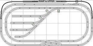

Now what I'm trying to end up with it this, two loops on the bottom along with a few lay-up tracks and a ramp from the lower to the upper level in the back. I don't really know how to use this track program, and I don't want to use realtrax either but this was the closest I could come up with to give you guys an idea. There's no crossovers in the program so I just used two pieces of straight to simulate it. I'm trying to figure out what curves to use inside and out and what switches. My actual measurements are 47 1/4" x 96" Thanks for any help.
For the most part I'll be using the LifeLike four car subways on the upper level. I also have the Atlas NJT set with the toaster engine. Is there a switch track that can be bought so I can get more lay up tracks in the yard? It seems waste of a lot of room with just four. Also, maybe the switches from lower to upper can be moved to the rear outer curve to allow the climb on the full eight foot?
The main problem you'll encounter is that your ramp is far too short. You will need, at a bare minimum, about 2" to clear the upper level, and you have a ramp about 2 feet long. That means an average 8% grade, with no transition. If there isn't a transition (a gradually sloping curve upward) your train will simply bump into the track and stop. With a transition, your grade will be much sharper, like 15%, which is pretty much impossible to climb. Grades of 4% or so are appropriate for traction equipment like a subway, but you will *definitely* need a longer ramp--at a bare minimum, I would recommend a setup like this:

That change to the ramp sounds good. Taking a measurement of the trains width, at 1 1/2" why not have a yard that I can park more trains? It's a bit of a hassle to use the finger crane to add and remove. Is there a way to add more lay-ups? Tighter switches maybe?
I have the pre-made crossover tracks for the crossovers. Is there a reason I would change it?
The poster was not suggesting you change the crossover, he was telling you how to draw one with the cad program you were using.
I think you are maxed out on the 4 x 8 without the lower level. The ramp up will have to be outside of the outside oval. There just isn't room on a 4 x 8 with 22 inch radius to put anything outside of the oval. You will need to add 4-6 inches along the side of the 4 x 8 to make it work.
