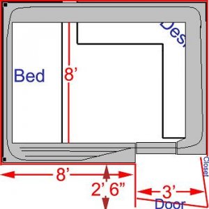

Nonsense! Build AROUND the four-poster bed: make a couple of notches for them, and mount a narrow (maybe six-inch) shelf in front of the posts. The plan below is just a schematic, but a 6" shelf is enough room for a double-track mainline with subway wall behind it (pretty easy to make out of Masonite, spray paint with gray primer and weather with ink, HO scale graffiti, and a little grime) and even have room for a surface or elevated line above it. The 1' wide sections are enough for a long two-track storage yard in front of your two-track mainline, which is enough room to store a dozen or so subway cars, and the section along the back wall is long enough for a "nolix" (basically, a long ramp) from one corner to the other, allowing a smooth transition from the lower subway level (or surface level) to an elevated line.

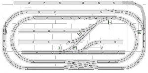

OK, I'm going to fool around with this plan. My next question is.. going with Jetrocks idea of moving the ramp switches to the curves, and going with 18", (pictured below) what is the name of the switches I need to do that? How would I ask for them in the store? Also the yard switches? Thanks guys.
They are called Atlas Snap-Switches. That's the name in the Atlas catalog. If you are using Atlas RTS software, the names for the products in the store are the same as the names of the pieces you are using in the program.
If you're going to fit a double-tracked loop AND a ramp upward to the upper level in 48", you're going to have to use 15" radius track on the inside loop, and 18" on the outside loop, then a separate 18" curve for the transition to the ramp.
That radius measurement is from the center of the circle to track CENTER--which means that an 18" radius curve requires more like 20" of space to hold track and train--more if it's double-tracked and you need clearance between tracks.
I really, really suggest that you give an around-the-room at least a look. Have you considered that maybe the reason your daughter doesn't use her existing set much is because it's wedged up next to the ceiling and she has to stand on a chair just to see it? A layout at chest or shoulder height that goes around the room can take up LESS space, be MUCH LESS hassle to build and operate, and is MUCH easier to access.

I can't do the shelf thing. The shelf would have to be 63 inches high. I also have two doors and a window in the way. I'm thinking the best way to go is with the 18 inch curves and two crossovers with the ramp coming off the 18" snap switches in the rear.
The ceiling is 83 1/2" high. The two doors and the window are 2 1/2" lower than that. Once the track up there became dusty, she would play with the train on a single track line for hours on end. Running a four car NYC subway or a trolley that backed off on to it's own siding. She would park the train on one siding and bring the trolley off another. That's why I would like to expand the yard tracks, she enjoys bringing them in and out. The DCC will add to the experience too..

If you're dead set on 4x8 land, then the inside track of your two-track mainline will have to be 15" radius curves. So, here it is...I scooted the track away from the edges, since the layout has walls on two sides--if you butt the track up against the wall you won't have room for the train (the train is wider than the track) and it will derail every single time. The inner radius should be 15", the outer is 18". The upper level should be pretty self-explanatory.
For the ramp: Use a 2% grade for the curves, and 4% risers for the ramp itself. The 2% risers allow a slightly more gradual rise, transitioning into the 4% grade, and you'll end up with an upper level about 3" above the lower level.
For the yard: I added a switchback track allowing you to store two more trains, and moved the switch over to provide a little bit more length. Remember, in yards longer body tracks are generally more useful than more switches.
