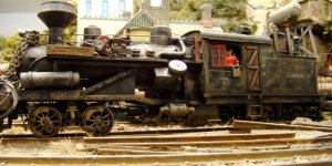

Hi Jim,
Those are great websites. I used them a few years ago when I "really weathered " the new style Rivarossi Heisler. They were a big help in getting the creative juices flowing.

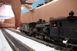

Class As
Those are both Westside models imports dating from the early 70. The horizontal boiler A , I purchased new many years ago. It has seen very heavy use in the past, and so the heavy weathering put on it 30 years ago seems natural now. The vertical boiler model I picked up a few years back, and It hasn't seen much work. It's previous owner painted it in a scheme that is accurate for a Class A straight from the factory. I need to re paint it to look as much like the other one as possible.
They have a 44 to one gear ratio, and the imperfectly centered axles on the tiny wheels makes them dig in, and pull very well.
on a grade the horizontal boiler unit can sometimes outpull a Bachman 3 truck shay three times it's size.
Bill Nelson
more on the class As
These two units have been bouncing around the RR in between permanent assignments. #3 used to be assigned as the switch engine @ Terrapin, it was replaced by #15, when it was bumped out of the mill switcher slot for being too slow (gear head reduction motor in a PFM 25 ton Shay) #15 was bumped out of that slot by my Bachaman climax, which has some kind of malfunction going on it it's front truck, and is out of service. I'm thinking of returning #3 to the Terrapin duty, and using the other to move log cars between Terrapin and the Strong and Perry mill @ the Gizzard.
The vertical boiler unit has it's original motor, and with the 44-1 gear ratio, the motor will melt it's plastic brush and bushing block if used for long runs. #3 had two or three original style motors replaced before I remotored it with a heftier motor. I had to butcher the boiler to get it to fit, but after all these years the boiler just looks like it has rolled over a coulple times. I'd have too find a tiny motor if I did the vertical boiler unit, as it's motor is in the water tank. which looks way big to my eye allready, so no long runs for it,

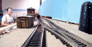

New Sawmill a'coming
Well, the good folks from Spittenchoo took the old excursion train out to see the new sawmill site. There is so much promise of good jobs and good things for these Tennessee mountains with this new enterprise.
The folks really enjoyed meeting Paul Bunyon.....errr Bill Nelson as he laid down the sub roadbed for the new project.
Doc Tom:mrgreen:

I was out @ the sawmill site @ Patterson, starting to cut in the heavy plywood sub roadbed, and tom comes over and starts to set up a photo right where I was working. After he got his photo, he became helpfull
Bill Nelson
I got the risers in place and the subroadbed screwed in place nice and level for the main lead into the sawmill. Next week I need to work on the areas where the track where the switches will lead off to the company store and warehouse, the drying racks, and the loading areas (those will be hidden behind the backdrop, and the lead going off behind the back drop on the other side of the complex, where we will store the empty log cars..
Bill Nelson

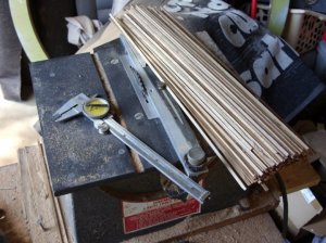

Ties!
I ran the little saw today, I gad some nice clear cedar, and I cut a whole bunch of "profile tie" blanks. this will cut down to be more than enough ties to hand lay the saw mill area @ Paterson. I will have to run the saw some more to cut the bridge ties and bridge timbers necessary for the bridge that will lead off to a nearby coal mine.
I'll do that later I have breathed enough fine sawdust for one day.
Bill Nelson
