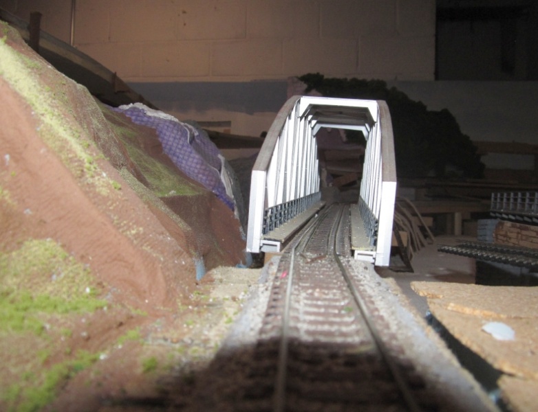

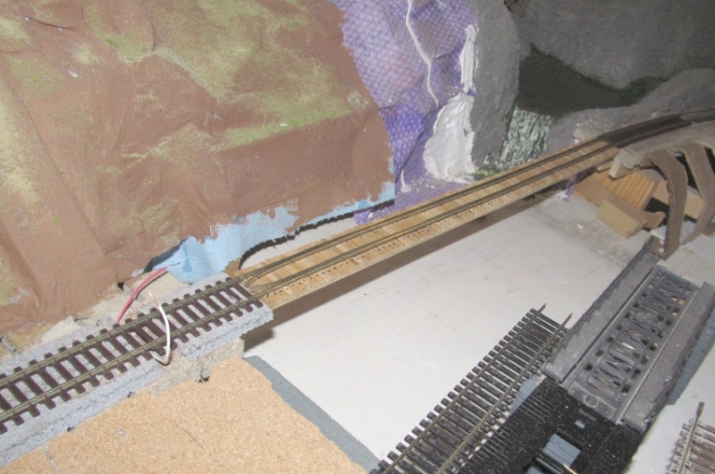

at the club today I did some bridge rehabiliatation on a bridge over the Lake at Cumberland Furnace . there was a nasty kink at the end of the bridge as well as some verical curve issues at each end of the bridge.
My making a wood bridge deck, which will give the track deck better suppoet, and splicing some flex track to it, I can get a better looking bridgedeck, with close fitting gaurd rails , and having flex track extensions so the rail joints won't be close to the bridge, making for a smoother transition onto and off the bridge.

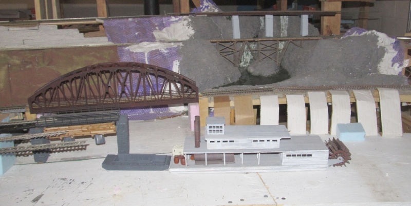

My river port on my home RR has been removed for redisign and replacement, so the Harlow Steam Navagation Co.'s Daisy is without a home port, and is working Cumberlans furnace for the time being, untill it;s home port at Harlow TN. on my home RR is rebuilt.
