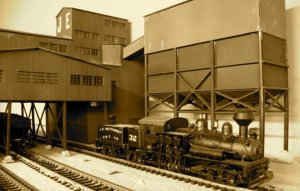

Shay and another coal mine.
Hi

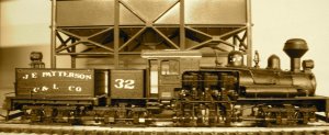

Here is Shay #32 in front of the Altamont Coal Mine operation. The sepia tone reminds me of old "builders pictures" of locomotives.
The coal mine was done by Bill Nelson and maybe he can fill in the details as to its construction.
We had another interesting operating session today and more pics to follow.
Doc Tom:wave:

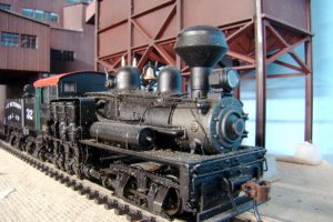

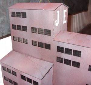

The Altimont Mine is built pretty much straight up from a Walther's New River Mining Co coal mine kit. As I do with any plastic kit I started out painting it flat black with spray paint, after that was dry I got spayed with flat black, red auto body primer, and some light and dark grey, pretty much simultaniously, so the paint mixed on the model while wet. In this case the flat black was the dominant color.
After the building was assembled it got the lettering painted on it, and then got drybrused with black, rust red and grey to further bring out the corrugations, and then it got the india ink in rubbing alcahol wash treatment, which brough out the window mullions, which were just bumps in the clear glazing, and resisted all other attempts to paint them. I really like the way the mine came out. I sets smack dab against the back drop on the top level, so it will be necessary to paint behind it. as some fake retaining walls, and cut tree balls in half and glue them directly to the backdrop, in order to bring the mountain feel to this big mine, which right now, if you judge soly by car capacity of the siddings available, is the largest industrial building on the railroad.

here is a photo of the Altimont mine shoing some of it's colors. This photo was taken after assembly, but brfor the last washes were put on, so it is a little dirtier than this now, but that doesn't show well in the sepia.
Bill Nelson

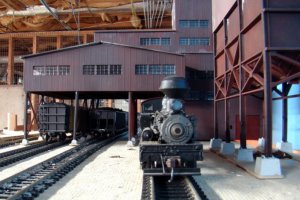

Yeah, I was getting a bit carried away with that artsy crafty sepia stuff. Here's a couple more shots of the mine in modern full digital color.
Dr Tom:wave:

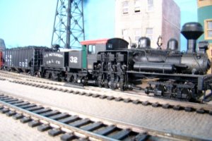

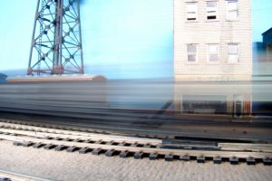

As "the dispatcher" at the operating session I did have some time away from the desk (no one crashed in to each other) and become "rail fan" with a camera.
Here is Shay #32 speeding along at 15 MPH. And then a "runby" at 0 MPH for the long shutter speeds low light necessitate.
Doc Tom:wave:

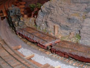

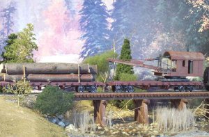

Nice Job. Got to lower them booms to get them to go under bridges and through tunnels. Nice looking flats I'd have guessed they were the Bachman flats modeled after log cars from Cass. Have you mounted rails to the deck for the barnhardt to travel on. I glue the rails (code 55 I think) on to the cars with walthers goo. some of the goo oozes out, but I have found that a Q-tip soaked in rubbing alcahol will clean up the excess goo very well.
I have put rails on most of my flats (MDC shortys from the old 3 in one kits that made log trains affordable). on some of them I have added bark debris (peat moss run through a blender). eventualy I'd like to put binder chains on the deck between the rails also. That way you couldn't see them when a log load was in place, but when they were on the empty leg of the round trip they would be there for use when the car was loaded again.
I have about six more MDC shorty flats I haven't built yet and close to ten old AHM old time truss rod flat cars that I am in the process of rebuilding. If I ever get done with those I will have so many log cars I'll have to start getting some from the Southern Railway interchange, which will be fun, as it would put log trains through downtown Harlow Tn.

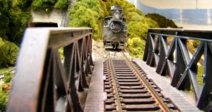

Hey Sumpter250, Great job on the loader. I have a couple of these myself. I wouldn't worry too much about the boom hitting the tunnels if the roof & smoke stack make it the boom will. I like the bridge as well. I like to play around with the rigging & gears on some of these loaders. If you take an old VCR or Fax machine apart they have some very realistic gears in them for modeling.:thumb:

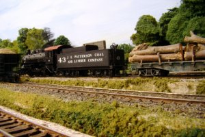

Well here's Bill's #43 filling up with coal and ready to move some logs. But the Spittenchoo mainline was all tied up with the trains of the operating session. Bill couldn't get out and I was stuck working the dispatcher's desk trying to get this mess unravelled. Sorry Bill.
Well as #43 simmered and simmered Bill and I began to scheme how we can move more logs in the future. More negotiations with the parent RR are in order.
Doc Tom:wave:

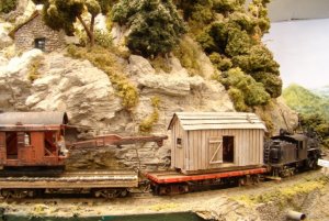

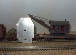

Hey Sumpter250, Great job on the loader. I have a couple of these myself. I wouldn't worry too much about the boom hitting the tunnels if the roof & smoke stack make it the boom will. . . . . . . . ..:thumb:
The boom will clear tunnels because it has been lowered. Un modified they will not. Here is an unmodified unit , on a MDC shorty flat, next to a clearance gauge. It can't go up the mountain division where there are tunnels. we have one @ the club that belonged to John Patterson, it hasn't been modified yet, and it can't go through tunnels. Tunnels were very expensive, and very seldom used on the temporary trackage used by logging outfits, so the height wasn't an issue on the real thing, and is only an issue on my RR due to the very unprototypical use of tunnels on my mountain division.
The booms on the prototypes were fixed, so we are cheating when we lower them. These things were cobbled up from steam shovel parts by the manufacturer, whose main business was steam shovels. The Idea though came from a logger.

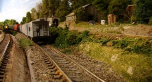

Another "grab shot" from the operating session
Here is another "grab shot" from the recent operating session on the Clarksville RR club.
A Class A Climax trundles down the high line with no Dieselization in sight. She is reliving the glory days of steam.
Doc Tom:wave:
