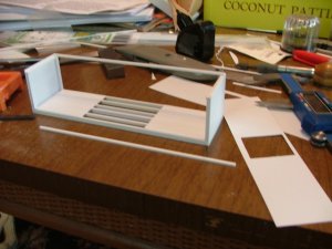

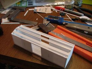

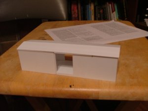

First I built the underframe...and then I built some stiffeners. to support the sides. I used plain styrene sheets for the the flooring...but leaving a hole in the center. I glued them in early to keep the frame straight...and I left the hole to detail the visible portion of the interior.

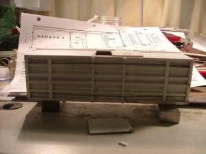

The sides are from plain scribed siding which I cut on a paper cutter.
I then added 1x12's to fill the gap in the center of the car that was visible from the door...and scraps to fill the rest of the hole. I notched the center of each 1x12 and applied a layer of 1x6s to make it sort of look like ship lap flooring. I also added so scribed siding to the interior to give the appearance of a finished car (this was a mistake...it should be framing...not siding...but I was feeling lazy...and I was watching football).
I then added the fascia boards to the sides and but out the fascia for the ends. I glued guide blocks to the end fascia boards...and attached some lengthwise roof supports...in part to allow me to remove the roof during construction.

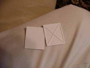

Next I built the doors using 1" thick scribed siding and 1x2 or 3 bracing.

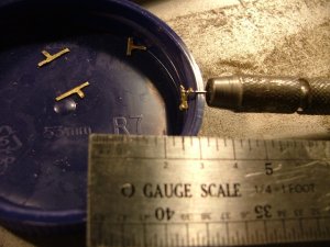

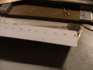

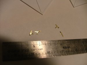

I then decided to try my hand...with inspiration from Bernard's awesome brass hardware...to build some of my own hardware. I cut out the four door hangers from 0.005" thick brass. (yes, I am using a saw on our dining room table...and the wifey took the photo). As you can see...they are tiny.

I took several days off and then resumed work on my passenger car as I felt that the brass door hangers would need super glue to be attached...and the wife won't dock my hobby budget (which is currently suspended for $360 worth of motive power goodies on a pre-christmas gift money loan) if she gets it from her graphic designer supply store...my waycar is awaiting that same super glue...hopefully this week...
On tuesday I decided that I'd just drill holes in my hangers and nail them to the doors using NBW casting like Bernard does with his hardware...then I'd have a styrene-styrene joint to cement. But first I cut and formed a piece of scribed siding to serve as the roof (I was going to do board by board...but I don't have the budget...and I did have scribed siding).

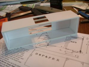

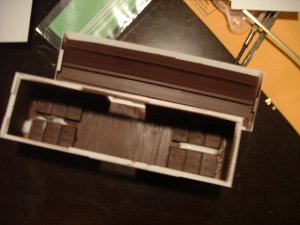

I then harvested 3oz of lead from my 27' box car which I mistakenly doubled the weight on by accident...the board by board roof of that car is now just a bunch of boards again...but I needed to redo it since the plans I used I've learned had some mistakes wall1
The 3oz...should be enough to get the car up to the appropriate weight...around 6oz. I glued them in using white craft glue (since I didn't have super glue). I then air brushed the interior tuscan red...after a lazy attempt at brush painting it.

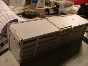

I then moved onto the roof...and glued 9" long pieces of 2x4 (i think) along each side of the peak of the roof. After they'd dried...I filed them down flat with the peak of the roof...and realized that it should have been 12" wide with two 6" boards...not 18" wide wall1 I suspect this had something to due with either the later cars in my china cabinet or from looking at the wrong plans. Oh well...it has three 6" boards now.
As you can see...a #78 drill (or was it #79?) had no problem cutting through 0.005" brass...although I quickly discovered that I needed to use a nail as a center punch to have control over where the hole was located...as my real center punch is too large for 0.040 wide parts. I the placed them on the doors, drilled through the doors, glued in the NBWs, and added music wire door handles.

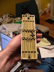

Since the roof was still removable...which was helpful while working on it...it was easy to work on the underframe. I added 0.025" music wire truss rods which run the length of the car. I added big NBW castings to provide the ends of the truss rods (the DSP&P did not use turnbuckles on freight cars...so the ends were the only way to tighten them). Originally I was going to just make my on nuts & washers to add to the trussrods...but I decided to be lazy...since the 25yr old package (older than me!) was sitting in my parts box.

Today I glued the roof on. I then built the end ladders...a bottom layer of 1x2...a composite layer of 1x2 steps and frame...and a layer of 1x2 steps (I didn't have 2x2s for the steps...and I've already mentioned my spending freeze). I also formed the only grab irons on the car (one per side) from 0.015" brass wire and 0.010x0.040 styrene which filled to resemble the round ends were the irons attach to the car. I also added the tops of the coupler pockets...gave them a grain texture...and drilled holes at one end for a possible addition of the truss rods which transfer the coupler loading to around the trucks...although I think I'll wait to add those. I also built the door stops and I've assembled all 6 door guides from (18) 1"x2"x4" pieces of styrene. Three of these have been installed...the other three will be drying over night.

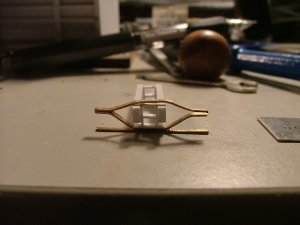

I don't really feel like paying $16 for the proper trucks (not including the wheels!)...and I don't want to have the wrong trucks. Further...I like sprung trucks...so I began to research how to build them myself! And I can...for approximately $0.25 a piece or so. I studied pictures of commercially produced models...but couldn't quite figure them out...until I found a website where a new swing beam truck was being built...a variety which is accurate for some DSP&P cars (although not this one)...since their 1:1 scale truck is fully functional...I was then able to draw my own plans for how to build my own sprung trucks! This is also important in that I need to learn how to produce passenger car trucks for my paycar.
The picture below is of my exploratory prototype. It consists of the three pieces of 0.020 brass which serve as the irons...(2) 4x8 beams which serve as the truck beams...and the webbing which serves as the spacer...made from 6 pieces of 1x6 styrene. For the production model...I haven't decided if I'll use 3 pieces of brass for each one (and I won't solder them together as I did with these)...or if I'll use a single piece resin casting made from a brass & styrene master of the journal boxes and side frames...which would then be "bolted" to the web spacer and the 4x8s...regardless I'll be "bolting" things together. I'll also be building the web out of 1x3s instead of 1x6s.
The spring sandwich will then hang in between the 4x8s and the top of the sandwich is what attaches to the freight car...hmm...I've got to think about how this will work...as I'll need to attach the trucks to the car unlike on the prototype.

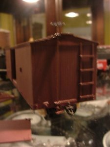

I haven't updated this for a while...but it is close to complete.
The remaining steps:
1) Re-install the doors
2) Letter the car
3) add trucks, brake hangers/beams, and air hoses
4) weather
I've added functioning Link & Pin couplers...with working draft gear.
I've also added completely scratch built brake rigging & hardware...aside from a Trout Creek brake wheel, ratchet & pawl.
This car, the 27' Tiffany, and the 27' UP built boxcar all have identical brake rigging. The other cars under construction used either a different or unknown configuration (the B&S car's configuration I've approximated as being the same...it's actually unkown).
