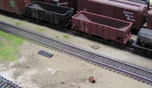

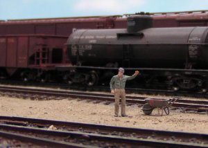

Some close up shots, showing some of the clutter I'm gradually introducing. Joe's waving at the through freight passing on the mainline.
Val
