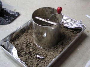

I did a little "gardening" yesterday - getting some earth for my layout!! And a little baking after that.... model RR style that is.
First I spread the earth out in a baking pan and "cooked" it at 500°F for 20 mins to kill all the little micro-critters that may have been there. It sure looked yummy when I got it out of the oven.
Then I bashed it up to a fine powder with a hammer. Borrowed my mom's flour sifter to strain the result (pic 1).

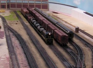

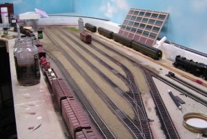

Pic 2 shows the overall yard.
Val

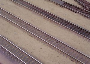

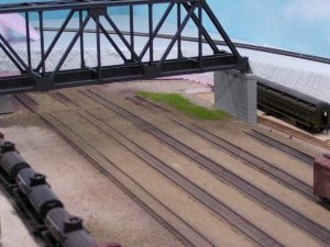

Here is a closeup of the earth, and a shot of the "Bridge to Nowhere". I must say I like the look of it there - will have to try to find a way to work it into the scene.

Looks great Val! You are making good progress... putting me to shame :blush:
As for the image size, I find that specifying the resolution (e.g. 640x480 @ 72 dpi) works better - or is maybe more predictable - than just using the "jpeg quality" slider to make the images smaller.
Andrew
Nice work filtering the dirt down to size--it looks very tidy! Some grime and weeds and spare parts might be called for--or you could always suggest that the local yardmaster is fanatical about keeing his yard spotless!
Very nice Val! Add a couple of weeds and a little junk in that close up pic of the tracks and I wouldn't have known it was a model! I like the bridge to nowhere too. Nice effect!
Ralph
Val, we're watching your progress closely. We love your rail ballast work -- looks great! :thumb: We're particulary interested in your real dirt process. :) :thumb:
I like the bridge to nowhere. In fact, that is good advice to the rest of us. Bridges get replaced or abandoned. Every layout could use an old rusty bridge with no approaches, or a few masonry piers from a previous bridge paralleling the current bridge.

Looks nice Val. I just use a tea strainer and teaspoon to sift my baked dirt thru. And a piece of my wifes discarded pantyhose fastened over the hose on a shopvac works great at reclaiming material. Just use a rubber band to hold it in place. Can't wait to see it finished!

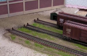

Ok, I made a little more progress last night and today. I airbrushed black all along the tracks. In the steam era, there was a lot of oil spillage on the outside of the rails, so that's what I'm doing. I also have diesels, so spillage between the rails works too.
The first shot shows the rail stops in place. You can see that weeds have started to grow around the tracks. :)
Val
