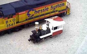

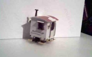

I get mine from Wal Mart and other major discount stores, it's the signage they use. Most of it is styrene, 2-3 different thicknesses and it works like a champ. You can scribe it to look like wood and it's usually free for the asking.
