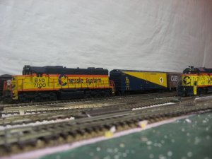

Chessie System SD20-2 #7700 pulls hard on a string of cars in Logan Yard as Coal Extra #4167 prepares to depart for the coal fields with a long string of empties.
