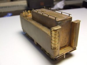

Wayne thanks for the link. I had actually found that thread awhile back. I was actually hoping to do as you had posted there. Unfortunatly the way my tender shell mounts to the tender floor made making a hole in the front of the tender a no go idea. Right behind the bottom of the front wall of my tender on the inside is a brass bar for the screw that holds the tender shell on. I was also trying to avoid cutting a hole in the tender front as it would be visiable due to the design of the tender front. But I will admit I am still thinking about doing it.:mrgreen:
This picture of the front of the repaired tender shows what the front of the tender looks like. There is a black line at the bottom of the front inset wall. That is where I had thought about making an opening just slightly bigger than one of my micro plugs. This way they could be shoved in or pulled out one at a time with enough room to get past the wires from the other micro plug. The only thing that stopped me from going this route was making a hole in the nicely detailed tender front.:eek: :(

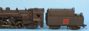

Wayne you make a good point about it being a difficult spot to see once painted and with the engine coupled to the tender with a proper spacing. I guess my biggest hurdle to over come is not wanting to make a hole in the tender. Most of all since having a nice running accurate model of a CNR 2-8-0 with sound is more important to me than the collector value of the locomotive. :mrgreen: I had originally planned on making a hole there as the inset front wall on the tender is actually not correct for the N-5-d tender. Van Hobbies messed up when they made the tenders. :eek: There should be no inset at the front as the real ones were flat there with the vestibule between the cab and tender there.
This photo shows how the front of the tender should have been modelled. The N-5-d class got their tenders from the S-2 mikados. Van Hobbies got the mikados correct when they did them. Seeing as I have a couple of days before I will have time to paint I am going to give the idea of a hole in the tender front some rethinking. In the end the less handling I have to do of the locomotive and tender to seperate them if ever needed the better it will be for the paint.

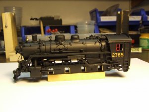

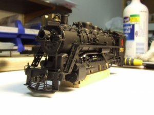

Today I painted the side cab windows red and the raised cab numbers CN yellow #11. Painting the windows was the easy job. I have shaky hands and the raised cab numbers proved to be a bit of a scary job as I was worried my hand would shake at the wrong time and the cab would get yellow where it was not needed.:eek: But with some patience and taking my time it came out okay.:mrgreen:
The boiler with the raised cab numbers and windows painted. The boiler is mounted on a brass tube that sits on a wooden holder I made for painting. This way the boiler could be rotated so all the nooks and crannies could be painted.

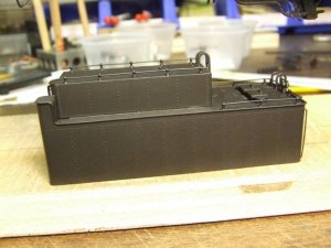

Tender shell painted. The rest of the parts look the same so no need to post pictures of them.
For paint I used Polly Scale steam power black. It is not a real dark black but is also not to gray. It is a water based acrylic. I had thought of using either Floquil or Scale Coat but decided seeing as I have always used either Modelflex or Polly Scale I would stick with what I am used to. The paint was thinned ( 15% ) using bottled water and sprayed with my Badger 175 dual action airbrush using a medium tip and needle. Most everything got two light coats followed by one final coat once I was sure I had not missed any hard to get spots.
Before any of the parts were painted they were sandblasted with baking soda using a Badger mini sandblaster. This helps the paint get a better hold on the brass and cleans the parts up real nice. Then it was a wash in warm soapy water and a rinse. Next a quick dip ( no more than 10 minutes ) in white vineager to remove any stubborn tarnish followed by a warm water rinse. Next a dip in lacquer thinner then a dip in 99% denatured alcohol. Between each cleaning step the parts were blown off with compressed air and dried with a hairdryer. Seeing as the parts had been handled a lot during the rebuild I wanted to make sure everything was real clean so the paint stuck real well.

I read about a neat trick to help keep the paint on the side rods and valve gear from wearing off when the locomotive is handled. I do not plan to handle it a lot but decided to try it. It involved cleaning the side rods and valve gear in lacquer thinner to remove all traces of oil and dirt. Next they got a little scuffing with some 800 grit wet/dry sandpaper. Just enough to dull the plating a little but not enough to break through the plating. Next was a bath in 99% alcohol then they got sprayed with some dullcote. This is supposed to help the paint grab better. Once the drive is reassembled they will get sprayed with the same black used on the locomotive with the wheels turning slowly.

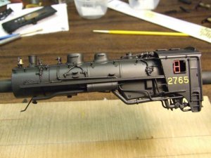

Seeing as I could not assemble the drive tonight I decided to mount the steam chest, pilot, and boiler back on the frame to see how things were going to look. I have been dying to see how it will look now compared to when I got it. In short curiosity killed the cat finally.:p:p:mrgreen:
I took a couple of pictures so here they are.

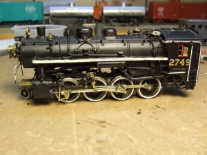

This is how it looked when I received it so many months back.
I am actually very happy with the color of the Polly Scale steam power black paint I used. I person it looks a little more blacker than the photos I took. Also depending on the lighting it looks anywhere from black to a gray color and seems to photograph nicely. The lighting I took the pictures with is just about the exact lighting I will be using on my new layout. I used a lamp for extra lighting for the pictures and the yellow light from it gave the paint a warm black look with a slight brown tint. More so in the picture than in person.
