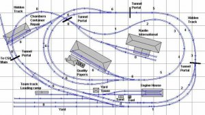

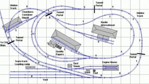

Dick, here are two Unitrack plans.
Paul

Thanks, Gents, for all your input. I had already dcided that with some modifications most track plans could be adapted to Unitrack and I was fishing for ideas. I have seen a few by Linn Westcott and the Layout Doctor that appear do-able.... just have to make some decisions.
Paul, are those layout specifically designed for N scale Unitrack? Are there more?:-D
Dick
I like the first plan. It looks practical and easy to manage. The second one however is too busy in my opinion and requires some tricky methods of dealing with switches on grade and elevated curve crossings. It doesn't leave alot of room for a believable arrangement of structures, bridges, and scenery.
Dick, this is indeed N-scale and both plans have eased curves.
Cannonball the second plan is the reworked Granite Gorge and Northern.

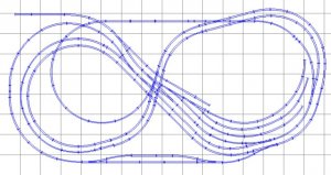

A better version of plan 1 without fooling the main when switching the yard
Paul
