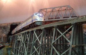

This one on our club layout scales out at about 160' tall, the outside limit for a trestle in real life. To the rear, the bridge is crossing a falls that drops into a gorge that the trestle crosses. In real life it would not be unusual for a trestle to cross another track. Because they were high maintenance and prone to fire, trestles were often temporary affairs, the railroads would eventually fill in the gaps with carload after carload of fill dirt, placing smaller, stronger bridges and abutments where necessary.

SAL Comet said:
Nice trestle Bob
It was made by one of the members, Dave McCue. He sawed all his own stripwood, buying basswood blocks from Mitchel's Crafts and cutting it on his table saw. The kerf of the blade consumed horrific amounts of the wood but was still way cheaper than buying strip wood in bulk. Sorry to say he passed away two years ago, only a couple months before I joined the club. The passenger train was originally his and now an honored member of my roster. Next chance I get, I'll take a full shot of it
