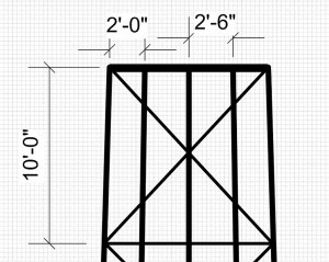

Now to figure out what the dimensions are for your prototype... For your 100' height, you could us the girts shown in figure 3g on page 30 in a 10 section bent with 5 posts:
Top of a bent:
...middle of bent removed to see dimensions at top and bottom of drawing...

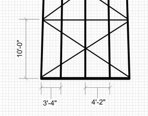

Base of a bent (dimensions based on 2" batting per foot of height per page 29):
or you could calculate in the space required to build double sills for the purlins...

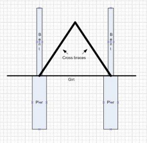

Cross braces
I am looking forward to the other picture because it looks like they cross braced the bents atop the piers:
Nothing in the book and after looking at 46 pages of pictures in Google, not sure there is anything on the web with the word "bridge", "bridge wood", or "bridge arch wood" out there that even looks close...
PWRR, Just a guess/observation; the angled members seem to be the same size and material as the verticles, much heavier than sway braces - could this be a simple form of TRUSS bridge as opposed to a classic bent-trestle ? As the piers support each truss unit, a lower tension member need not be as strong as an un-supported truss...? I ain't that kind of ENGINEER, just supposin'. Bob C.

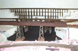

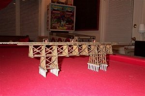

I used round piles with a pile cap and a trestle on top for a lake crossing. Don't know if its prototypical or not. The first pic shows the structure and the second shows it in place.
Doc
