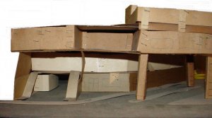

1975:
I wanted something modern and up to date that would not look 1900-1930 as many model railroaders liked for their era of operation at that time. Finally certain features looked more and more attractive and some scale floor plans were made. The design was strictly freelance on what I thought would look good and there is no particular building anywhere I was using as the basic model. Eventually a full size cardboard mock-up was made.

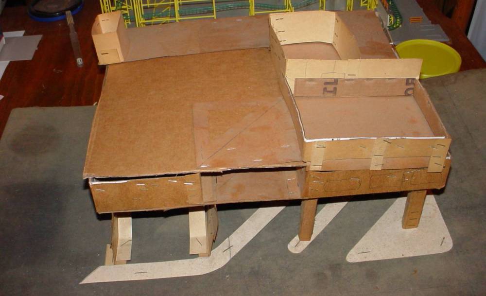

PHOTO 1 above: Showing its age, the cardboard mockup still exists after years of storage in an attic or basement. It’s leaning to the right, weakened by moisture absorption. The model as built so far doesn’t nearly match the mockup as reality often differs from dreams. But, this is where TRANSPORT CENTRAL started.

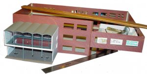

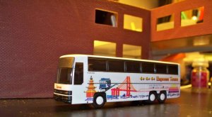

Photo 2a above: The empty shell was packed away for years as the real world intruded again as in making a living, raising a family, and a 1000 other things. What little modeling I did was strictly ready to run during this time. The wooden ruler on top of the building is 18" one and the metal ruler at the bottom is the General Steel HO scale ruler about 12" which will help you size the building.
Photo 2b below: A large, HO scale tour bus parked by the empty shell gives you a further indication of the large size of this model building

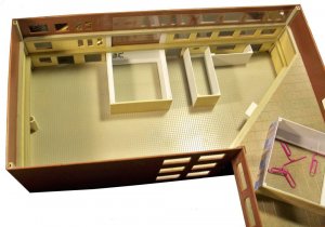

Photo 3 above: Empty shell now has windows and inner walls making this a rock solid and heavy plastic structure. Substructures being test fitted to the interior to be glued in later on and it’s definitely light proof. Notice the 3rd floor is still awaiting the 'inner walls'.
Various sub-buildings are being test fitted; the large square one in the top center of photo 3 is the “elevator/restroom housing” and wiring feed for lights will come through here. Inner buildings (sub-units) have Evergreen ½” tiles on the side toward the middle and various computer printed wallpaper on the sides. Each sub-unit was constructed of Evergreen plastic sheets and shapes and finished completely on the workbench before being installed.
The first floor ceiling and floor of the 2nd story is a sandwich of materials as thick as the wall brace that will support it; this space was designed originally for bulbs, later rethought to individual LEDs And, again, reduced to much more versatile SMD strips of LEDs. Sub-units on the 1st story will be:

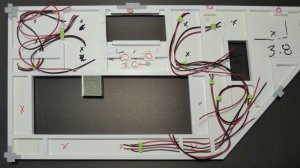

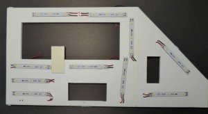

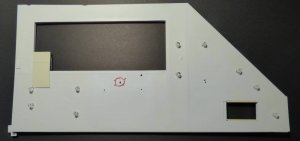

Photo 4a above: Ceiling of the first floor showing 10 giant lights (5mm individual LEDs which need resistors). The first floor needs more lights which may be added later on.
Photo 4b below: Other side of the ceiling which shows the wiring and strengthening beams of the sandwich.

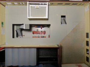

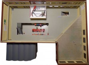

Next the flooring of the 2nd story was made from Evergreen ¼” scribed sheet sprayed the same light gray as the bottom floor. Several pieces were required and they are just lain in place as 2nd floor sub-units will be screwed to the ‘sandwich’ holding them securely in place. The left center of the floor is cut out as a large atrium which will run through to the roof for natural and artificial lighting to help illuminate the building. Sub units are test fitted and then removed for detailing latter on the work bench.
Photo 4c below: 2nd story floor is in place with the "elevator/restroom" housing holding it in place And, I am ready to work on the 2nd story ceiling sandwich.

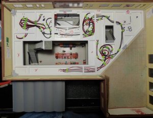

Photo 5a above: Ceiling of the 2nd floor showing the substituted SMDs in place of regular LEDs (10 strips were used, it's a big building)
Photo 5b below: Topside of the sandwich after the SMDs were installed showing the wiring mess not fully hooked up yet as I am experimenting with resistors to lower the brightness a bit.

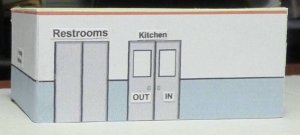

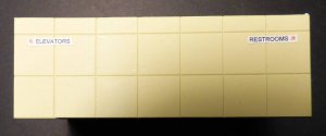

The “elevator/restroom housing” is common to all three floors and they mostly look alike though the 1st floor one is slightly larger. Each has signage on the front directing people to the elevators or the restrooms. My computer printer (with fresh cartridges) managed crisp, 6 point type which was cut and glued to the tiles. The left side has wallpaper with two elevator doors drawn on it in photo program and printed. The right side of each has a man’s and woman’s restroom doors. The outside wall behind these units on floors one and two has slit windows while the one on the third floor has larger (but not picture) windows.
Photo IN1 above: front of an elevator/restroom sub-unit (highly enlarged)
Photo IN2 below: left and right sides of an elevator/restroom sub-unit (highly enlarged)

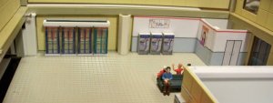

To the left of the first floor main entrance is a bank of 4 old-fashioned telephone booths as it is quite noisy in the busy first floor. These are from a Bachmann detail kit and are glued as a unit with a roof over them. Further along that wall to the right is a group of 3 ticket machines (for the local transit served by the building) plus a small ticket office with an agent inside for those traveling longer distances. Ticket machines are from an internet image glued to a plastic shape and mounted on the floor.
Photo IN3 above: showing the telephones, ticket machines, and small ticket office. To the left is the main front entrance of this large building. Plenty of people in here after final details are added.

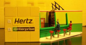

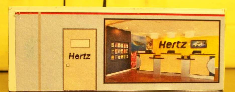

To the right of the building is an Hertz car rental, a dispatcher’s office overlooking the rear loading bays, stairs to the second floor and, lastly, a snack bar. The snack bar is part of an Atlas kit cut to a triangular shape with some customers on stools at the front.

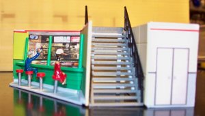

Photo IN4 above: left wall showing the Hertz office, no room for enterprise as shown on the front wall.
Photo IN5 below: front wall showing the signs for the car rentals and the snack bar angling off to the right. The snack bar when installed has the overhead canopy, a waiter right behind the counter, and a short order cook inside (not shown).
Photo IN6 above: showing the right side with the short order cook (internet picture), the back stairs to the 2nd floor, and to the right the dispatchers office door.

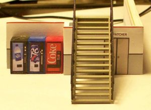

A bank of soft drink machines was glued to the floor at the front of the infamous “elevator/restroom housing” to add a splash of color to the waiting area. Trash cans, ticket machines and more vending machines fill the interior. Groups of benches with lots of people were added to the first floor plus many standing – walking people to round out the detailing. Over 50 people are on the first floor to add to the image of a busy city building (these are mostly those economical figures cheaply had from China sales sites with some minor retouching).
Photo IN8 below: Bank of soft drink machines, ticket machine to the left; and, some of the benches and people in the lobby area. More of everything added later on.

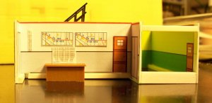

First off is the “elevator/restroom housing” which is basically just like the one on the first floor but a bit less deep to allow for the walkway past it. No need to picture it again here. Next is the Manetain Barbershop in the top left corner of the floor. Originally it was to have two large picture windows in it but only got one; but, I went on and completely detailed it anyway using the interior from one of the many AHM, IHC, etc. barbershop kits made by POLA. Instead of a picture window on to the atrium I copied a barbershop picture from the internet and put it behind the window opening.

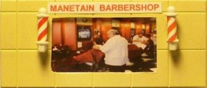

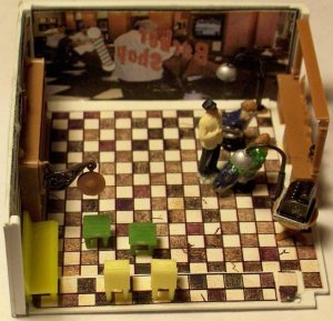

Photo IN9a below: Outside of the Manetain Barbershop with striped poles (from the atrium side)
Photo IN9b below: Inside of the Manetain Barbershop showing the fully detailed interior; very little of it shows on the outside from the rear of the building. More people have been added than show in this photo.

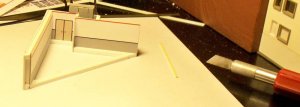

The third sub-unit on the second floor is the transit Dispatcher’s Office which overlooks the front loading bays on the ground level. It has wallpaper but no furniture inside or wall decorations yet as some electronics may go in here to run traffic signals for the loading bays. This has no window glass in the outside window as of yet as eventually it may get a bow window to overlook the loading area. How detailed this eventually gets will depend on whether electronics to control traffic signals go in here or on the roof somewhere.
Photo IN10a below: the rear of the Dispatcher’s Office with the back stairs going to the third floor and an additional grouping of soda machines.
Photo 10b below: the inside of the dispatcher’s office, not fully designed yet

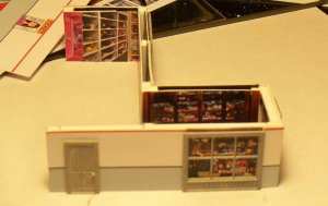

The third floor
The first sub-unit is the “elevator-restroom” which is used to anchor the flooring material in place; but, as it is identical to the 2nd floor one (and nearly so to the first floor one), it is not pictured here. Next I built the gift shop, Betty’s Boutique, which wraps around the stairway coming up from floor two. It is enhanced with some windows and doors leftover from other kits to give it a bit of a 3D look.
Photo IN11a above: is the left wall of the boutique showing the entry door and store window.
Photo IN11b below: the right wall of the boutique which wraps around the stairway from the second floor and has another store window.
Photo IN11c below: shows the interior of the boutique if viewed from the back of the building as it spans 3 large picture windows

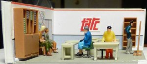

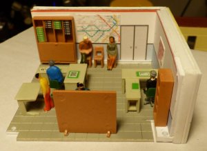

Photo IN12a below shows the front (at the left) of the TARC office in Transport Central; and, the right side at the right of the photo -- signs added as needed.
Photo IN12b below: is the inside of the office taken as from an outside window.
Photo IN12c below: is the inside of the office taken from the left side and slightly above. Note material in the bookcase floating in the air, this will be fixed but I probably will not take another photo.

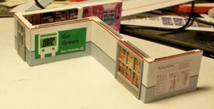

The last major sub-unit on the 3rd floor is the Luau Room restaurant which will be tackled in two phases starting with the kitchen (starting 11-4-18). It is a dummy unit with no interior but with wallpaper applied to the outside in the same color schemes as the regular units and signs applied it will look OK. At the rear, near the employee entrance is a Diet Coke machine attached to the wall of the kitchen. There will be other vending machines directly applied to the outside wall next to the coke machine as the third floor is finished up.

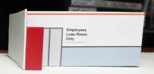

Photo IN13a above: shows the Luau Room kitchen from the front (atrium side); visible at the left is a Diet Coke machine which will be next to the outside wall. Apparently even a jitter correcting camera cannot solve all problems as noted by the blurry sign pointing to the vending machines.
Photo IN13b below: the left wall is seen with the entrance for kitchen employees; the red rectangle is the Diet Coke machine from the side.

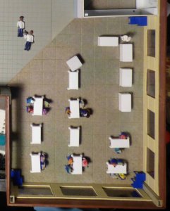

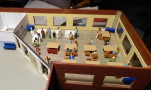

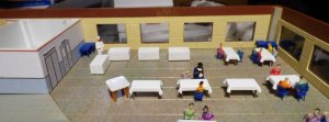

(11-19-2018) Starting in on the dining area of the Luau Room I found problems with previously purchased items that I had put away to use in this area when I got around to decorating it. I had previously purchased Preiser kit No17219 which consists of 4 buffet serving tables, 8 tables for eating patrons and 32 chairs for diners. This kit looks amazing in the photos and when in the packaging; but, upon opening the package these items are apparently smaller than HO with the tables being only 23” high and the chairs so small (though good looking) that HO people looked like 350 pounders sitting on them and would NOT fit under the eating tables. Table length and width are so small that food would be hard to place for anyone at the table much less for four eaters at each table. I haven’t the heart to try and scratch build such fancy tables so I’ll raise these and use different chairs. Preiser makes a number of chefs and I have a bunch of them. They also make kit #17220 table wear and food. It’s going to be hard to paint the food but eventually I’ll get that done to add to the serving tables. I got out some packages from China of 1/100 people that I sometimes use in the interior of a building to make it look larger or more crowded. Bingo, these fit the chairs and under the buffet tables easily. This kit of tables and chairs and similar ones by Preiser are obviously much closer to 1/100 than 1/87. Nearing the home stretch on the interior I weaken once more (the fancy entrance discussed later being the first weaken) and will use 1/100 people at the tables (with a lot of repainting) and better grade 1/87 people in the serving line. Too bad Preiser is offering undersized items as HO scale.
Photo IN14a above: shows the interior of the Luau Room dining area as populated with the Preiser buffet tables and 1/100th people sitting in the buffet table chairs. I did this a few days ago and looked at it for a day or so; and, it looks OK until you put a chef or two in there and then the diners look like midgets next to Paul Bunyan. One HO-size person is about in the center next to the midgets.
Photo IN14b below: Notice the HO size person sitting in an HO size chair next to the undersized buffet table and 1/100th person. In a very short time I un-weaken on using 1/100 people and undersized stuff and decide I can make buffet tables myself (if I have to) which won’t be as nice as the Preiser ones but at least will be in scale. I’ve ordered some different tables and chairs on-line (not Preiser) which I hope will be scale; but, if not, I’ll make what I need.
After looking at the dining area for several days trying to convince myself it will be ok with some 1/87 people (Chefs and others) and many, many 1/100 people as seated diners, I decide it simply does NOT look right and I decide to either make my own tables or buy someone else’s.
While waiting on stuff to be delivered I am a bit mad so I take a break and build a McDonalds kit from Vollmer. It looks good and though arranged differently than the ones in the US it does have the familiar golden arches. Next I build a Faller metal shredding plant (quite difficult even though a premade kit). May post photos of them in the gallery later on as I built them as stock per the instructions.
I ordered both Faller and Kibri table and chair kits and none look much better than the Preiser ones as to all sizes when they arrive. I am calmer now after building the two kits in-between deciding not to mix 1/87 and 1/100 and ordering new stuff. I then take the Preiser serving tables and slice one in half and add each half to a full size one. Much better and they will be used. For dining tables I did the same with the ones from Faller increasing each by 50% and they were about the right height. I used the bulky chairs from other Faller kits bought long ago. Now everything is bigger and better and I will use higher quality “HO” people with them. The dining area has 9 large picture windows and this already looks much better when viewing from the outside.
The dining room receives the initial makeover and looks much, much better to me with full size people and accessories. Less tables in it but a bit more space between them and nicer people (Preiser and Woodland Scenics instead of the cheap Chinese ones).
Photo IN 15 above: the Luau Room now populated with larger tables and chairs plus 1/87 people and the wall between the main building and the dining room fitted in place.
Photo IN 16 below: a shot through the window doesn’t do justice to what the eye sees. I’ll try to learn how to change the depth of focus (f-stop & exposure time) on this digital camera. I may have to start using a tripod for stability.
Yet to come is the food on all the tables (lots of painting on that), wall décor and plants. Most such restaurants had lots kitsch décor, a mishmash of things people would think Polynesian in origin.

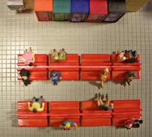

Some more figures added to floor 3; but, no real progress on this one. The "food" for the buffet tables is microscopic. Some the size of a couple of pin heads; and I am having trouble with painting them. Hope to finish off floor 3 and figure out how to do a roof soon.:(
Have fun modeling, Swamp Daddy
