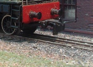

You're probably not soaking it enough to penetrate all the way thru to the sub roadbed. The key is to get it wet without getting it drippy wet. I use Woodland Scenics N scale Ballast and Cinders for my work. It's a bit finer than normal but I compensate for it with sifted and demagnatized parking lot dirt.
