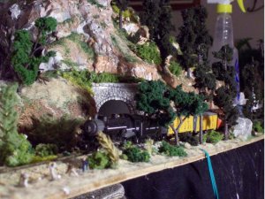

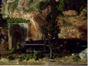

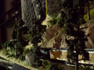

I have been playing around with some photography techniques, here are some pictures. These are all dawn or dusk shots.

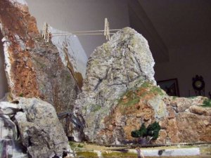

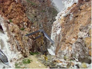

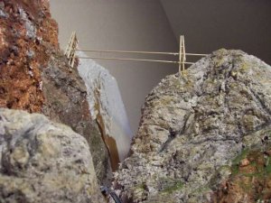

I worked on the bridge and rock face on the gorge today and yesterday. For the bridge I used ready mad plastic I beams. The one side I had to drill holes in the plaster to put the I beams in but the other side I have yet to plaster so i will plaster those in later and the bridge will staighten out

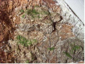

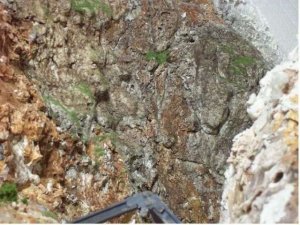

For the rock faces first I put a layer of rough sculptamold. The I painted that a redish color. New I went ove severl places with a second coat and stapmed It with a mold spryed with lots of non stick spray to give it a rock like texture. The next step was to carve crack lines then paint/stain those portions various gray, brown colors. so now I have several colors and textures. The last step was to fill some molds with sculptamold, very important as it is stickyer, and lighter than normal plaster, and stick the mold onto different, random places, I took the molds off after 5 to 10 mins depents on the thickness and blended the sculptamoald this gives a three dimensional quality and lastly I stained that and added vegitation. For now I only have the one picture and It is not very good so I will have to get some more. The left side is finised and the right is not. that picture does not show any texture , diffinantly need another.

Here are some better pics the first really sows the progression of sters from white nothing to different colors to the finished section

Very nice work Collyn. I'm impressed by the way you modeled the gorge and by the pic of the real one . I was born in what's nicknamed the "flat Country " ( Belgium ) so I'm impressed by any mountain, hill or even molehill.
Something is not clear to me about your mountain building technique: "New I went ove sever places with a secon coat and stapmed It with a mold spryedwith lots of non stick spray to give it a rock like texture".
Are you using a Woodland scenics rock mold ? 1 mold contain several rock cavities separated by flat space then you must have some flat space on the gorge if you stamp the rock on the fresh sculptamold.
Could you please be kind enough to expand that information ?
Another "interesting" point is the violent climate during the construction of that railroad line.
In Belgium, nothing like that happened because since the beginning there was only 1 owner: the Belgian government so there wasn't any competition.
I have several rock molds 2 molds that are a single big face from woodland scenics one that is the several smaller molds and one that I made from laytex and a real piece of granite from by backyard. I first overfill the molds up with the sculptamold, then I just stick them to the side, they usually stay up, I use the mold I made a little differently Since It is thinner with no edges I hot glue It to the surface then fill it up, it works great for curved sections. Hope that helps.

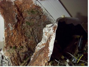

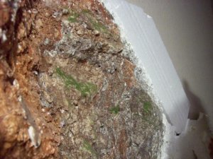

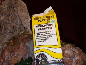

More rock work on the gorge, different tecnique this time this area is all compleatly hand carved. There is so much more detail with this technique but it takes a long time and you must have good access to the spot in which you are working. This was not suited to the other spots plus the detail would not have been seen. I ran out of sculptamold and the last several times I have gone to the LHS they have not had it. So, instead I got the paper mache they sell in little bricks (1 lb). Then I added some plaster ( 4 lbs). It turns out that is alot of paper mache to plaster but it was hard to tell in that compressed brick. I found several advantages, I had much much longer working time, it is just now compleatly dry 2 days later. It still held its shape after I was done carving, it drys mostly in an hour but it still feels soft for a while. Also, it is gray to start with. It "worked" much better. I also bought but havent used yet this sculting plaster, never seen it before now. I aso stuc a failed attemt at a bridge on top to show where it is going to go. In the pictures the rocks look blotchy, it's a camera issue not a painting one.

been i while. I never said how the mold a scene works. It is very strange. It is kind of like building with sand at first, difficult and alot falls away. but then it started to get better as it was worked. It really wasn't good for what i am doing but for some applications it could work. It is already brown so painting is hard i think i am going to paint the whole thing white so i gan stain it like i have the rest of my rocks. I give it a c-. Sculptamold much better. not much better than plaster
