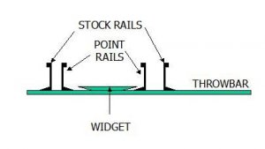

Do you have any problem with the point rails coming loose from the throw bar?
I have had to resolder 3 of them so far.:confused:
Loren
Hmm....only if I've been excessively "rough" with them. Today for instance, I didn't back the caboose completely through the turnout and threw the points. The pressure of the flange getting caught inbetween the rail and the point caused the copper cladding to shear off the fibre glass. Otherwise, I've got about 20 turnouts almost a year old now and have only had to resolder 3 of them. Which I just figure as regular track maintenance.
The only advice I can give you is to run a mill file over the copper cladding of the PCB tie to get a clean shiney surface. I also use an Acid Based Flux which is really agressive and wicks the solder underneath the rail and gives it a really clean and solid bond. I just make sure I neutralize the soldered joint with some rubbing alcohol so the flux doesn't weaken the joint. :thumb:
I gave up on PC board throwbars after the copper cladding kept separating from the board. I went to a wood or styrene throwbar with a lug between the point rails to pull them into the stock rails.
What did you do? Super glue the rails to the throwbar?
Loren
No, the point rails are solid from frog to point. They're spiked in place up to an inch or so from the throwbar. They just float over the throwbar. The widget is chamfered so it grabs the foot of the point rail and holds it down as it presses against the stock rail.
