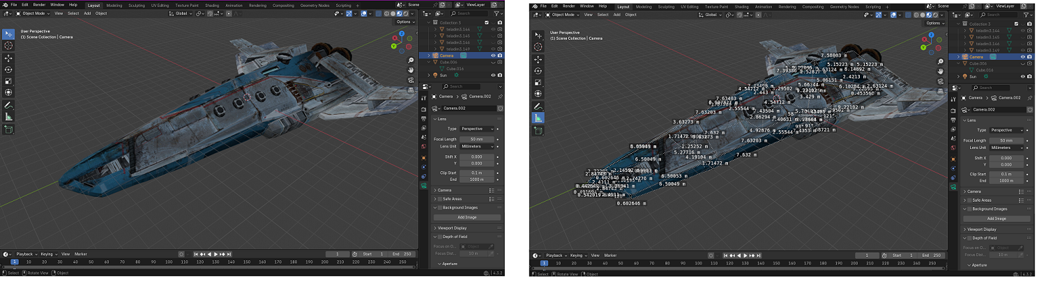

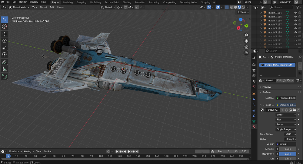

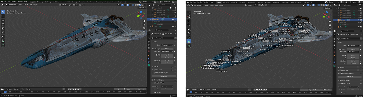

I managed to convert the ship files into .obj format.
My 3d modeling program to use is blender. I don't know blender. It took days over days to get to know it a little. But I did not want to spend 70 bucks for pepakura and there is a paper model export script for blender. Perhabs some day I will pay for pepakura.
Thanks to the modding community tools the uv maps for the model textures came along the converting way and I can load the model up in blender with textures:

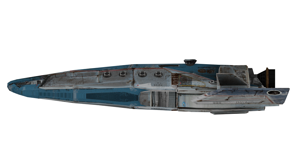

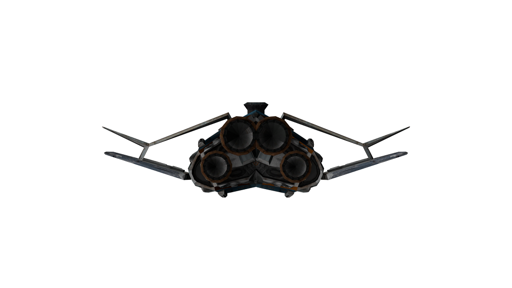

One thing I don't like are the arkwardly high engines, the two big ones at the aft. Look like exhaust pipes of a truck. I lowered them and - with the two lower ones - tried to align them with an imagined center-of-mass:
Then I tried to export the ship piece by piece with the paper model script for blender. But it spew out 50+ parts and impossible folds and faces, just for the long hull part without wings and all. That is really sad because I know the paper model script can work great. I made a model of the "Alte Nationalgalerie" here in Berlin as a present for my wife (I want to share that template with you, but I have to ask for permission from the creator of the 3d object of the gallery).
I took a look at the mesh from the ship and it has some complicated recessed part and some faces fold into each other. Looks really complicated.
I spend hours, almost days to get to know the sculpt tools but it just destroyed the mesh completely.

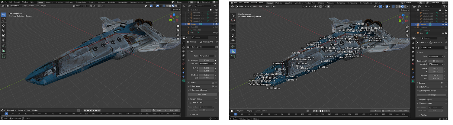

Then I discovered the measuring tool in blender. you can measure a line AND you can measure angles!
Driven mad by the idea of having a Teladi Kea paper model I began to measure at least every line and angle necessary to achieve the shape of the hull roughly:
And that's why I call this model the low poly edition. With this method I loose a bit of the round shapes but I'm fine with that.
The lines and angles gave me the faces which I draw "by hand" in a vector graphics software. I prefer vector over raster graphics because of scaleability. Though I could have used the original textures somehow to achieve more detail.

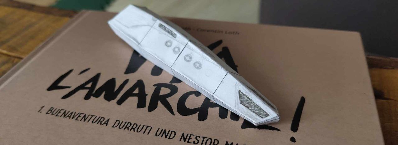

first test build to check the overall shape
and then to the serious business.

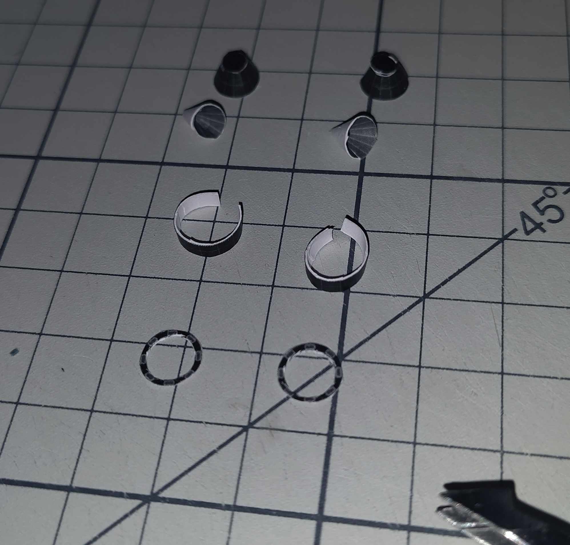

The shapes for the engine parts I got from the paper model export script for blender. The rest I measured and draw.

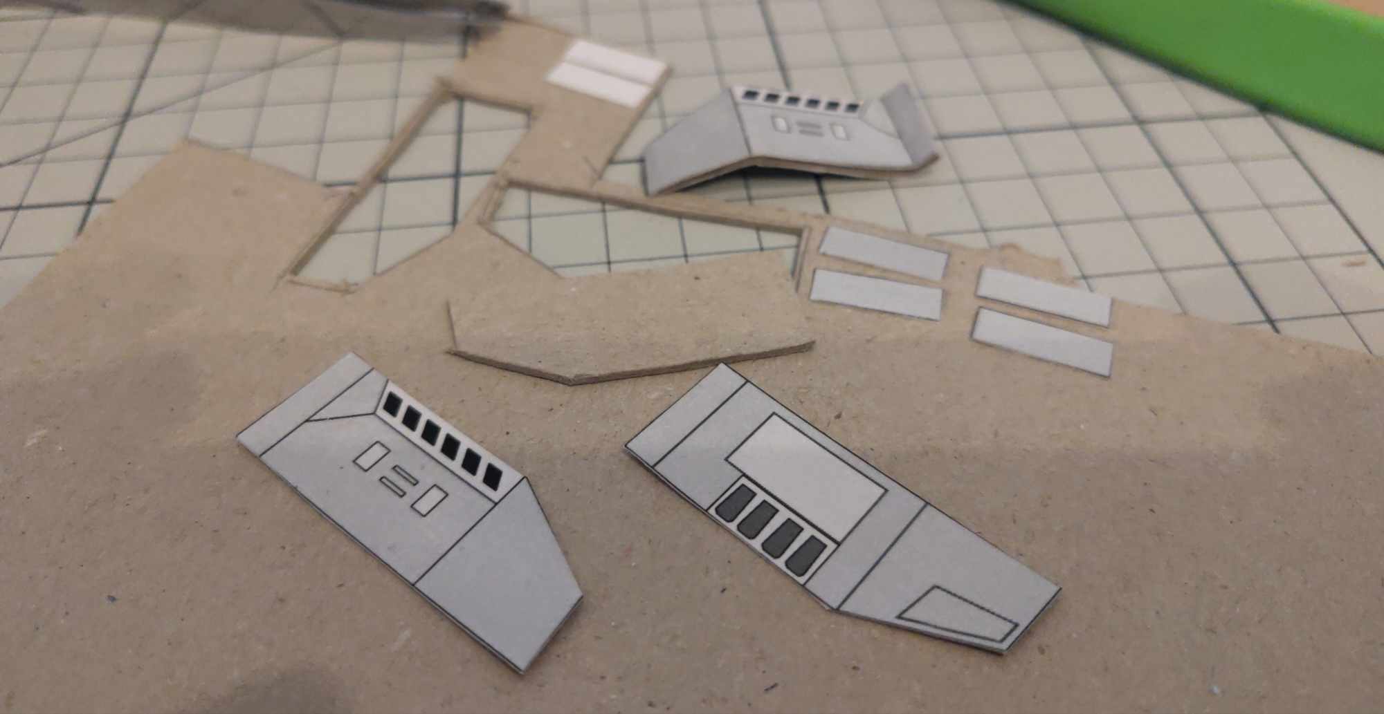

This build I will do with the layering version. To save ink/toner I plan to design it appropriate. Like the first layer is just for the shape and the recessed parts, like the cockpit windows and other details. the layer above comes with the full textures, plus extra parts for greeble. I don't know how much toner is burried under the layers of my millenium falconXD I don't want to something like that again.
cockpit windows and random details for first layer
I did not bother with drawing glueing flaps. I just use seperate pieces of paper. results are smoother surfaces.

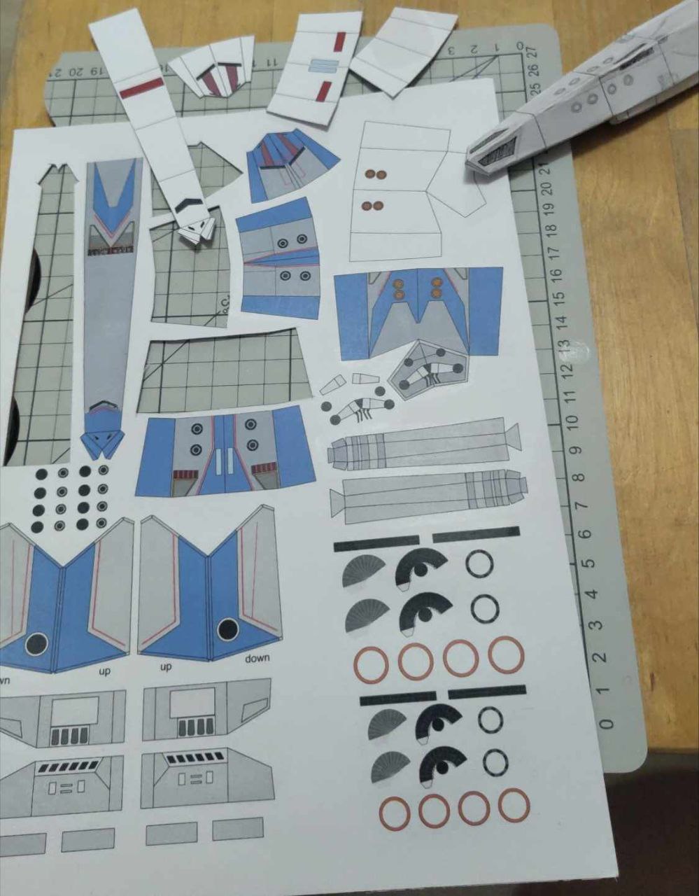

I already have to change the template. I like to work with thick paper for stability, 190g/qcm. But the second layer has the same dimensions like the first and with paper that thick I start to need gaps between the faces.
I will split the template into a page with first layer for thick paper and a second page for the texturized second layer for thinner paper.
The shape is okay I think. engines, top wings and details still missing.

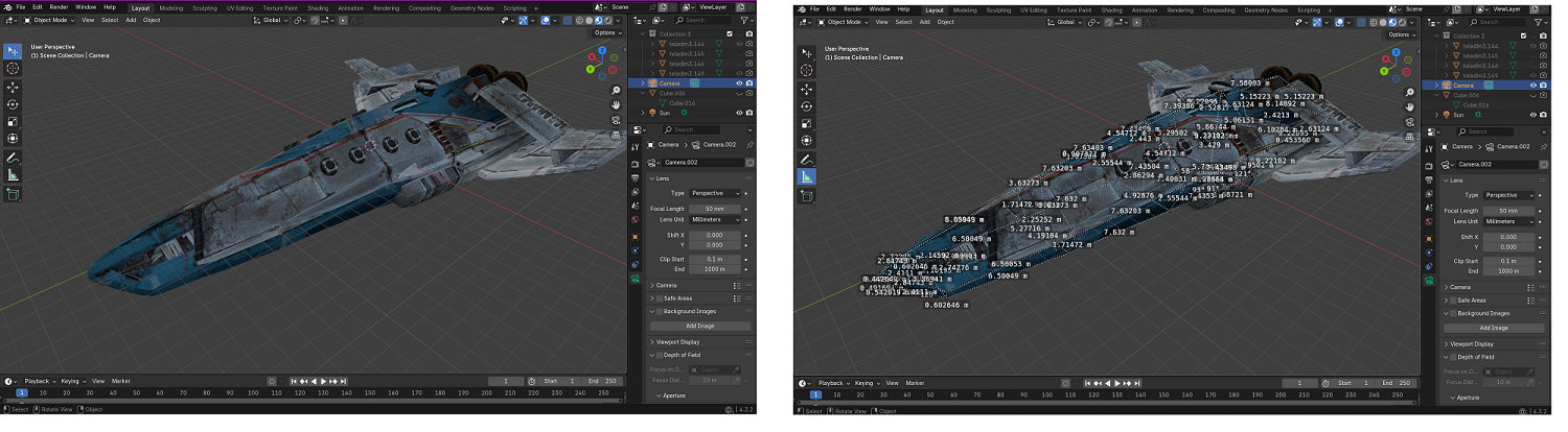

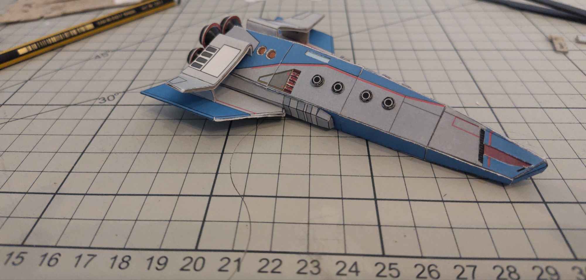

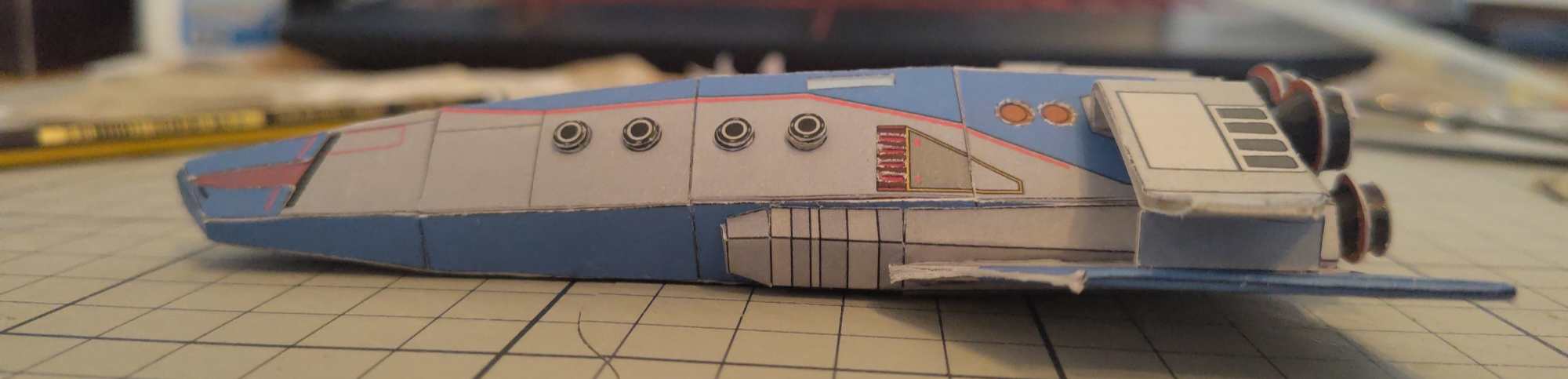

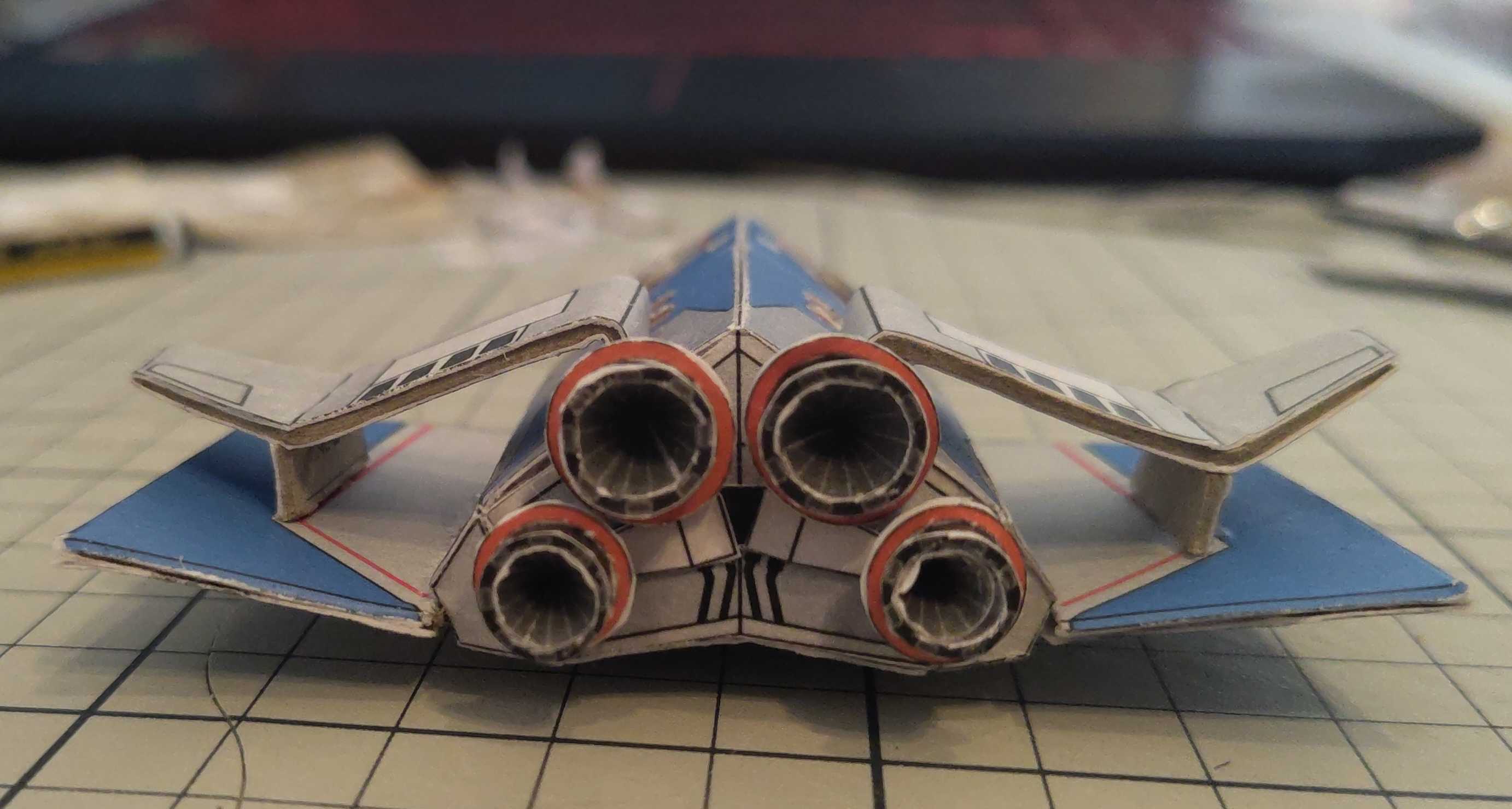

Up until now the engines come in 4 parts, but I will need an attachment part because of the inclined aft section
Like the wings I laminate the upper wing parts to 1mm grey board.
For the wings, upper wings and engines I use super glue because of the small and thin glueing areas. And remember, these are also the parts that need high stability when you and your kids are playing with that ship.

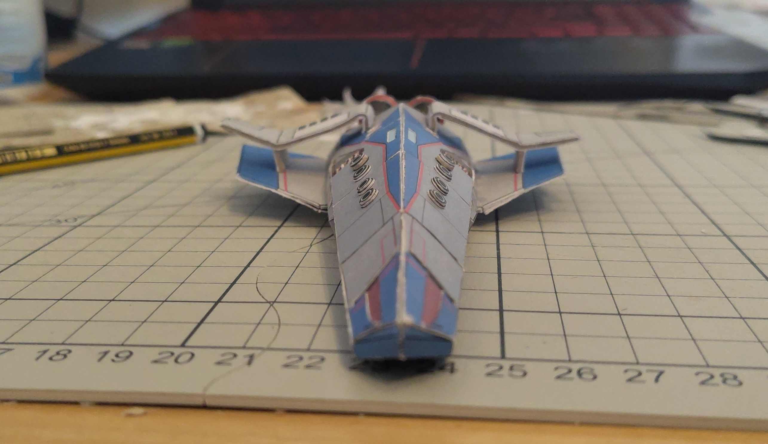

I think thats it for the first iteration. Basic shape and most basic parts are there. Now I have to optimise and add most of the details from the original model.
Notice the jagged and damaged egdes. That's really cheap paper of bad quality.

What scale are you using? Are the grids in CM? If so, this is really good work at that scale. BTW don't beat your self up too badly. This is a first build and often times when you make something the first time around and see it, you also see what can be improved.
Maybe scale it up a little bit to make it bigger. More ship to play with. ;)

I'm using 1:250 scale. Yes, the grid is in cm.
I discovered I am a fan of smaller models. The size of my hand and smaller.
With ~14cm the Kea the same size like the Falcon and with 1:250 also the same scale.
I'm actually thinking of a smaller scale version of the Kea to hold it against bigger x-ships in the future. There are some nice 100-200m ships and I don't want them to become 1m long models:biggrin:
