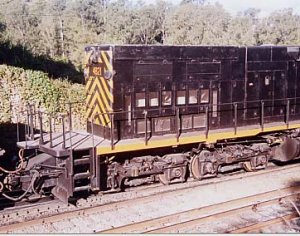

DDM45 details
Close up on DDM45 #862.:p

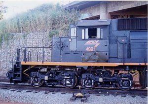

DDM45 and BB36-7
Well, I´m doing some small parts to detail it, while the DD trucks are coming to me. :sleeping: I´m also scratchbuilding BB+BB trucks to model BB36-7 and BB40-2 too. :) I got the official drawing from the truck builder in Brazil. And you renesis? Do you have news about the DDM45 model?:p

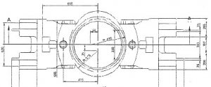

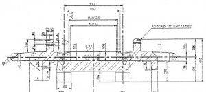

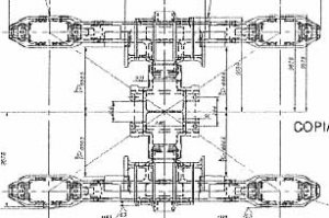

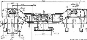

Here are the drawing of articulated trucks used on brazilian BB+BB diesels. :) Unfortunately this site do not accept better pictures.:(
I´m scratchbuilding the parts in HO scale. Soon we can model every kind of BB+BB locos used in Brazil.:)

Bolster
Here is another view of smal bolster.;) I do not have the draeing of big bolster yet.:(
