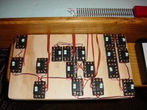

Breed got it right. That's exactly how I wire mine. I've got a row of momentary switches 2 feet long! One thing, take the time to line up the postitions of the momentary switches so they all go the same way for a certain route... It's really worth it to be able to glance at the switches and see that, because they are all to the right, say... you know your are on the mainline.
racer,,,, also the same as I'm using,,, mine are only set up temperary to make sure everything works right so when i do it the final time the wires wont show, but here is a pic,,,, I mounted them in a position kind of realitive to the switch if that makes sense,,, and then wired them all to where if the switch button is up the switch is straight thru or if it is down it is thrown,,, for me it makes it easy to glance at it and tell,,,, not saying i dont mess up once in a while but it seems to work pretty good,,,,,,,, good luck,,,,,,,,,,,,,,,,,,, st
