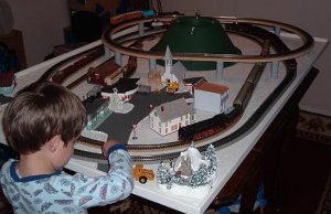

I don't use fluffy stuff for fear of what the fibers can do to my trains. I use the sectional EZ track as well as Marklin's track plus an elevated plywood loop I made using 11.5" radius curves (an Athearn GP35 goes around it with no problems). All this is set over a sheet of OSB painted with several coats of cheap white latex. The roads are outlined in white painter's caulk to look like plowed snow then painted grey with cheap craft paint.

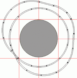

Earlier in this thread I posted the track plan. I decided recently to remove the 19 degree crossover and simply have the track go over the lower run via a bridge.

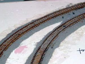

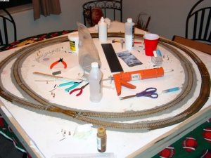

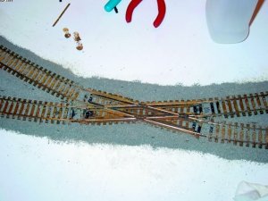

Well this layout is coming along. I'm using it to prep for my full size layout. Some things I have learned and have questions about. I promised I'll post pictures once I get my camera problems worked out.
I purchased and used Flextrack for the entire layout. It was difficult to place the flex track and make it come out the same radius continuously. I think I read a suggestion about using a yard stick to draw lines as a guide. (I'll try that next time.)
I used alcohol and a little liquid soap and my ballast seem to float a bit and ended up on top of the rail. I tried to use a medicine dropper and a contact solution bottle but it still didn't make a difference. What's the best way to clean up the tops of the rails?
I painted my rails and ties with Senna brown (someones suggestion here) Seems to too light. I may weather them a bit more or hit it with the Midwest liquid weather stuff.
I tried it out a some test track. The bottle mentions that you have to rinse with water to stop the weather process. :( But the rails turned dark black. Not sure that's the look I'm going for.
I'm still ballasting... I ran out of alcohol.
Pictures---Please don't laugh
You'll notice the ballast started to float on the ties. I think I figured out what caused it. Instead of dumping a lot of alcohol and soap on all at once... I started to do it little by little. Taking my time. :) How am I going to remove this?????
I believe that's why some areas are better than others. You'll also notice the paint on the ties seemed to get lighter. I suspect the soaking at a lot to do with this. A second coat will be needed.

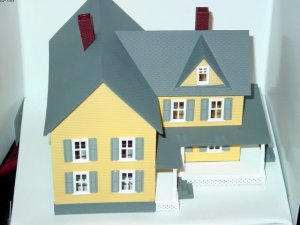

The house is a model power. For the sake of time I got a pre-assembled one. It needs weathering etc. And some details. Suggestions?
